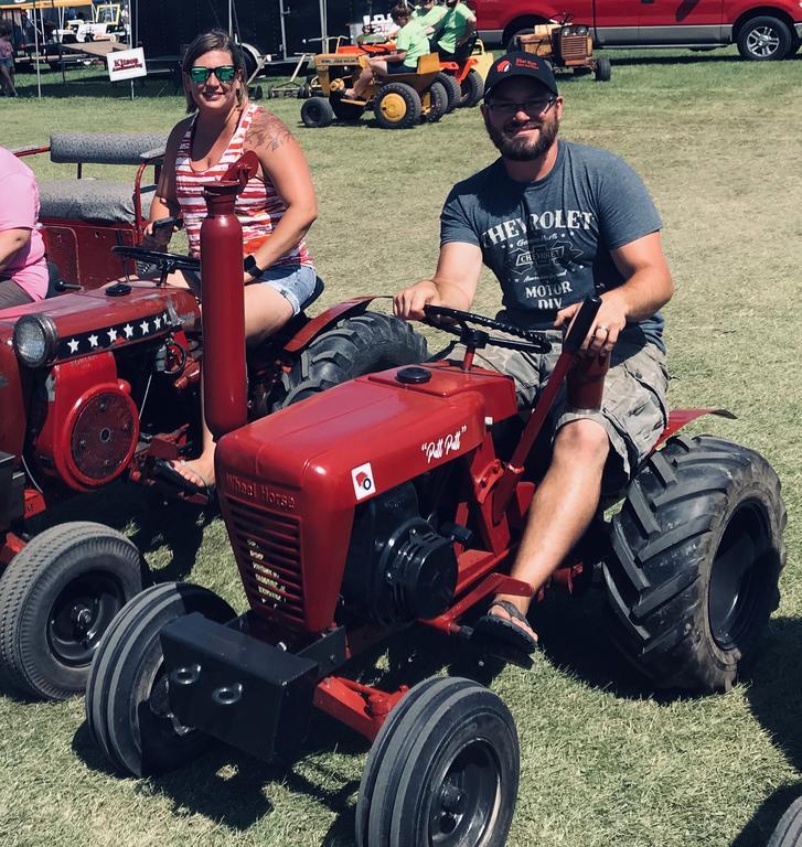

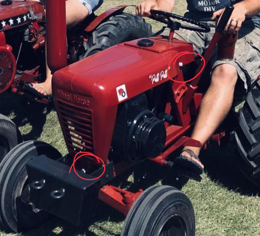

There are three thumb screws that hold the hood on.  Two short ones thread into the tank and one longer one goes through the front of the frame into a weld nut on the hood.  I have 23x10.5 r 12 Deestone Ag tires on my 502 and have no clearance issues.  :text-welcomeconfetti: @Elliot Garfinkel!

Thanks for you quick reply nice looking tractor if that's the one you have plenty of clearance so the front screw is not exposed
I circled the two visible thumb screws.  Without my hanging weight, it would be much more visible.  Thanks, I call it Putt Putt and there’s a build thread link in my signature if you need more reference.
