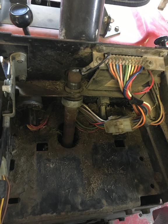

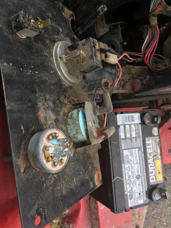

KREP 15 #13 Posted July 22, 2019 (edited) I have the onan. I had the tray out, but didn’t see a relay. I’ll yank the battery and try and have a look. Thank you. Pulled the battery and tray today. Looked there and there was a square connector which I took apart and cleaned with CRC spray. The ignition module is in there and other small electrical items. No relays. I arced it and started it then got on the seat. Let it run a minute then jumped off it to move something. The dang think kept running! The lamp check and circuit all looked fine, but it shoulda shut down. This tractor may be haunted. Edited July 22, 2019 by KREP Share this post Link to post Share on other sites
Bill D 2,591 #14 Posted July 24, 2019 It should stay running when you leave the seat as long as the PTO is not engaged. The item you refer to as an ignition module is the relay for the starter that I had get corroded on my tractor. If you can post some pics of the parts in question it would make it easier to help you. Also check the condition of the 9 pin connector. They are known to melt. I also had to repair the main fuse block due to a fuse holder melting. If you lived closer I would be happy to help you. Bill Share this post Link to post Share on other sites
KREP 15 #15 Posted July 25, 2019 (edited) The ignition module I’m referring to is where the key goes (left of steering column as you stand in front of tractor). The 9 pin is what I sprayed with CRC. It is like new inside. No corrosion. It’s never spent a night outside. thank you for you help. Edited July 25, 2019 by KREP Share this post Link to post Share on other sites

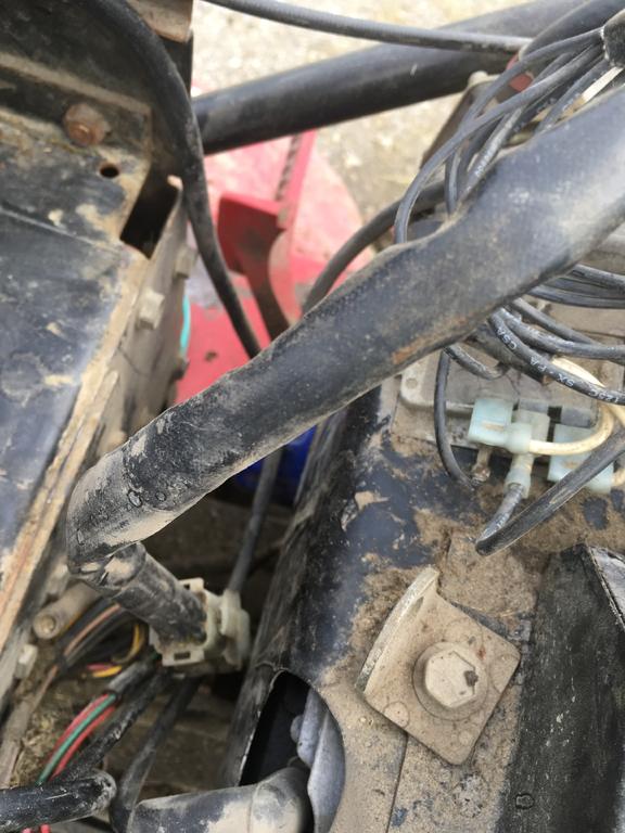

gwest_ca-(File Mod) 11,990 #16 Posted July 25, 2019 Not likely your problem but this is a good example of what to look for if you have an intermittent short in wiring. It appears the wires are rubbing on the steering shaft. It will wear a flat in the insulation and in the center of the flat there may be a bare wire that may require very close examination to see the exposure. The idiot light module can be disconnected and have no effect on the operation of the tractor. Left connected it may assist in the diagnosis of the electrical failure. I would suggest you clean the grass away from the bottom of the module as the acid in the grass will corrode the circuit board. Garry 1 Share this post Link to post Share on other sites
Bill D 2,591 #17 Posted July 25, 2019 The 9 pin connector you are looking for goes between the engine and tractor wiring harness. Could you take a picture of the item you are describing as an ignition module? I believe it is the relay I that I had corrode on mine. The relay is mounted under the battery tray. You would have to remove the front panel that has the key switch and gauges to see it. It is a small square, 5 pin relay made by Hella and it controls the starter solenoid. Share this post Link to post Share on other sites
KREP 15 #18 Posted July 25, 2019 (edited) The ignition module I’m referring to is the key switch where the key is inserted. It is the round lock cylinder with 4-5 connectors. You can see the 9 pin connector in the picture I posted. It is a white square connector in the battery area (after removal of battery). When I get home I will take the plate off where the key switch is and look for the 5 pin Hella thank you and by the way, the wire next to the steering shaft has all the insulation intact. A weed made it look like a run thru. You have a good eye. Edited July 25, 2019 by KREP Share this post Link to post Share on other sites
Bill D 2,591 #19 Posted July 26, 2019 The 9 pin connector you are looking for looks just like that one, but will be located between the engine and tractor wiring harnesses. It should be somewhere near your oil filter. Share this post Link to post Share on other sites
KREP 15 #20 Posted July 26, 2019 (edited) Ok. I took the panels at the shifter and gage panel. Got my blower out and blew about bushel of hay out of there. Then I looked by the oil filter and saw another connector. I took that apart too and hosed everything down with CRC. It looks like a large cable in one of the pictures. I assembled everything, hit the key and the ol’ mule started right up. Wow! Edited July 26, 2019 by KREP Share this post Link to post Share on other sites
