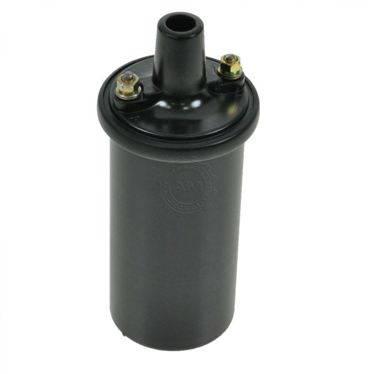

gwest_ca-(File Mod) 11,990 #5 Posted July 16, 2019 Does your ignition coil look like this? If so you have battery ignition and the above diagram is for magneto ignition and not the correct one for your tractor. S is for starter usually controlled by a starter solenoid. Garry Share this post Link to post Share on other sites
