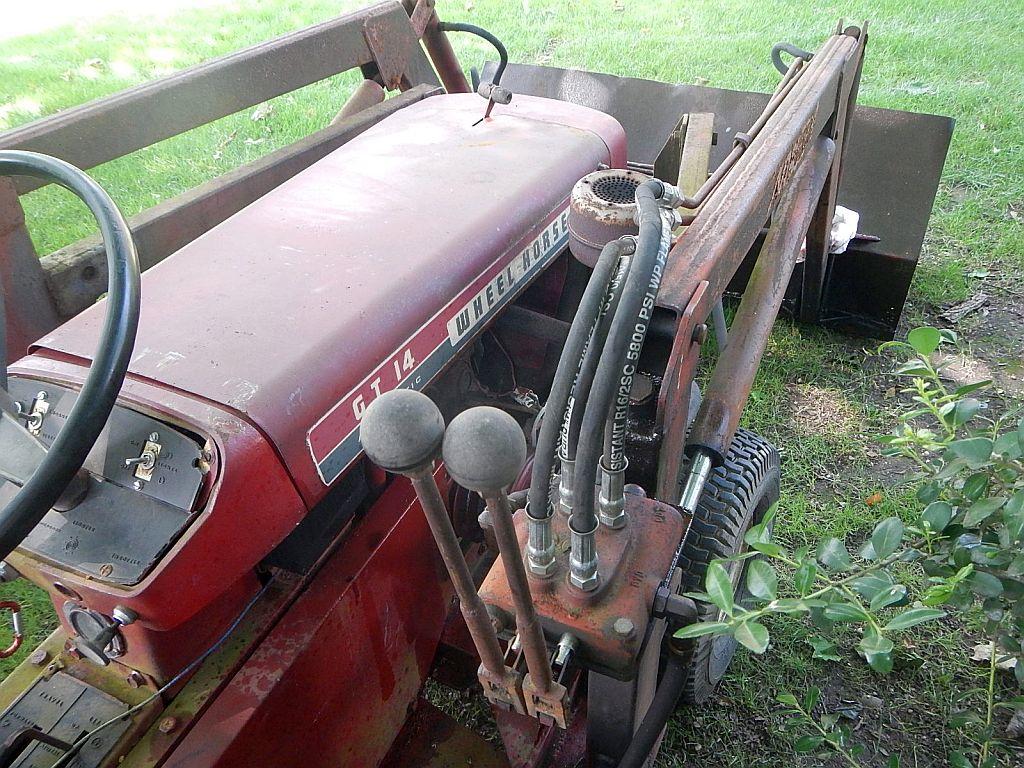

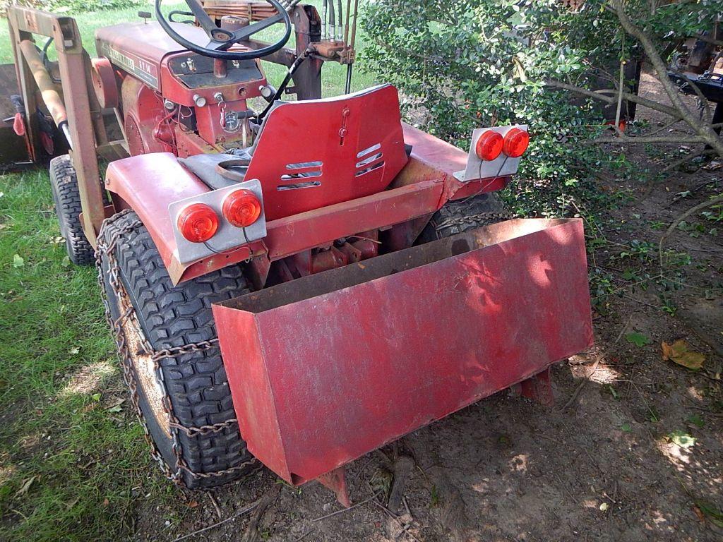

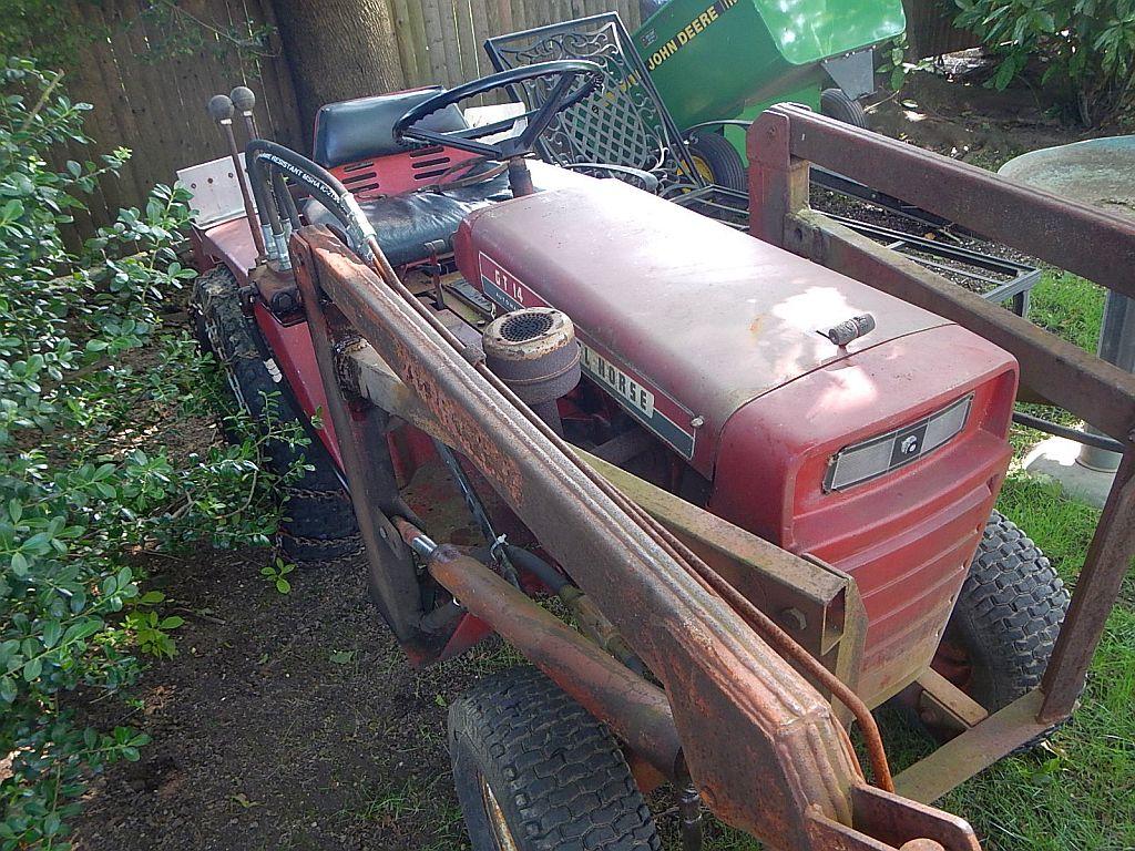

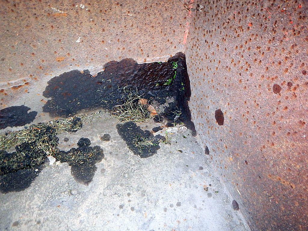

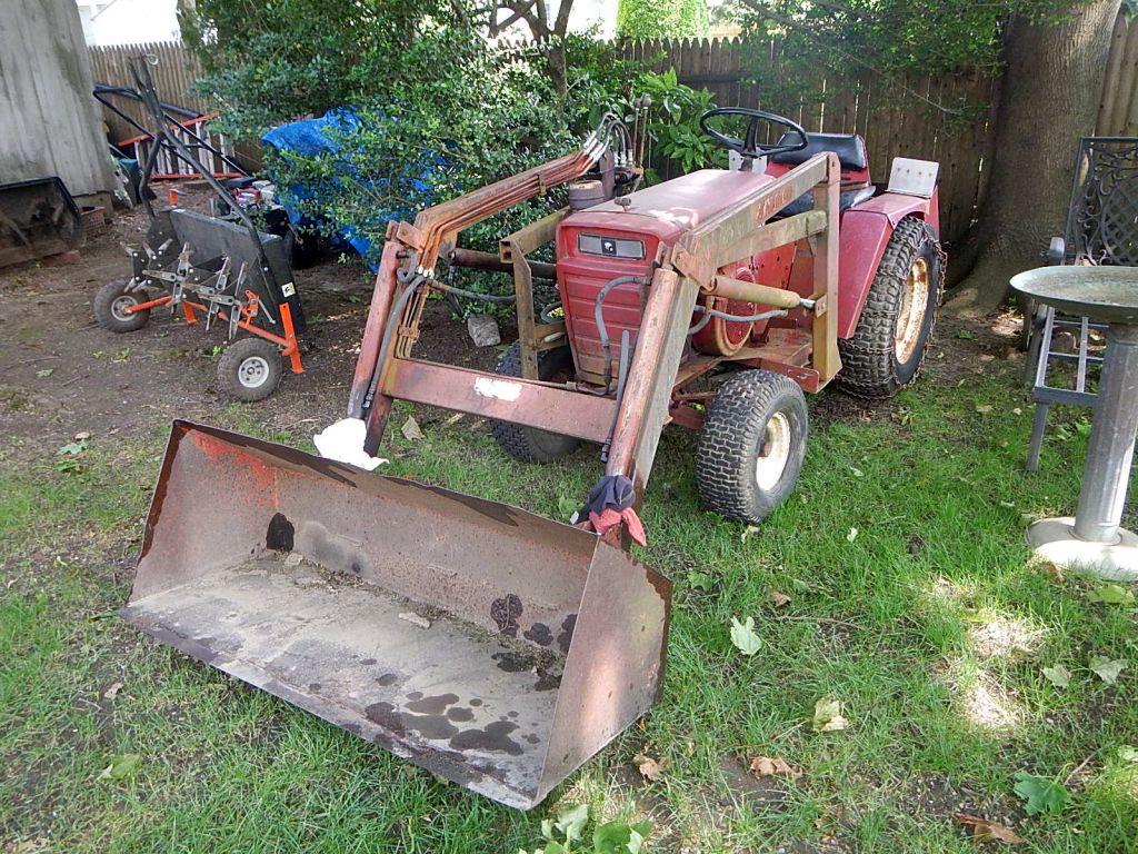

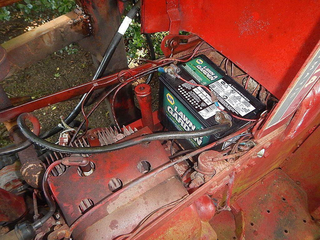

MARK (LI) 3 #7 Posted July 11, 2019 Thank you for the nice welcome...here are some pictures...The guy I bough it from had about 10 other Wheel Horses, but all were neglected...the engine needed oil ...one bucket piston seal was leaking and the other one let go...the steering is messed up ..I guess from the weigh of the loader...I got it cleaned up a little today ( I just got it yesterday)...there was a lot of mildew on it...I go the cylinders off and ordered some new hydraulic hoses....I have to do a little welding on the bucket too...but the price was right 1 Share this post Link to post Share on other sites
