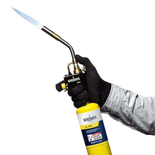

953 nut 64,116 #19 Posted July 12, 2019 2 hours ago, Stormin said: Shine a torch in the tank and see if there's any dirt in there. Norman, on this side of the pond it is a flashlight. this is a torch! 2 Share this post Link to post Share on other sites
Stormin 9,987 #20 Posted July 12, 2019 7 hours ago, 953 nut said: Norman, on this side of the pond it is a flashlight. this is a torch! Aye! But tha divan't talk proper like wot I do. Actually, we refer to both electric and gas as torches. Why use two words when one will do. 1 Share this post Link to post Share on other sites
lynnmor 8,626 #21 Posted July 12, 2019 Yes, but a torch will clean it up better than new. Share this post Link to post Share on other sites
