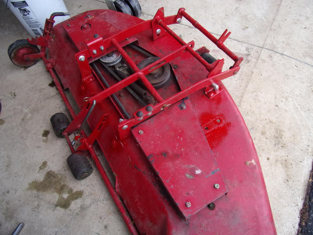

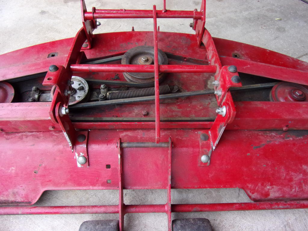

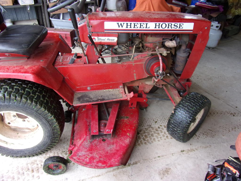

Ed Kennell 44,029 #1 Posted July 8, 2019 A cool rainy morning had me looking around the barn for an indoor project this morning. There was this really nice 48" SD with the old style mounting hardware. The deck has a good shell and the steel greasable spindles with the offset zerks that you can actually grease without taking the deck off the tractor. These decks also have the heavy spindle reinforcement plate that keeps the blade tips in perfect alignment. The bearings are all tight and quiet...probably because the were well greased by the PO. So, I removed the old mount and added a new style mount. This was really a easy conversion. After centering and locating the correct front to rear position so the standard length belt would work, It just required drilling 8 new holes for the 4 mounting brackets. I did have to alter the rear brackets to fit the slope of the deck. Then make a lever for the front to rear leveling rod. Put it on the C-120 and it cuts really nice and is my quietest deck. I may add the two anti scalp rollers to the front corners. After this was finished, there was this pile of 2 blade gear drive decks with the bad ball and socket in the left rods. This design was one of two bad designs by WH. The other was the rocker plate engine mount. I have never found a gear drive deck that didn't have a problem with the left rod. It's clear the design engineer didn't realize the left rod was in tension and a ball and socket would not work. The right rod is in compression and works fine although this is a very expensive machining process where a clearance hole and a threaded rod would have done a better job. Here are some of the fixes by POs. All defeat the purpose of adjustable rods. The strap Just weld it The hose clamps This one that I repaired by cutting off the ball, drilling and tapping the rod, and drilling a clearance hole in the pulley shaft actually was held together by a turnbuckle and hose clamps. Now, three more to repair....next rainy day project. 11 3 Share this post Link to post Share on other sites

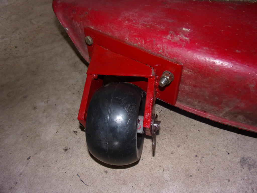

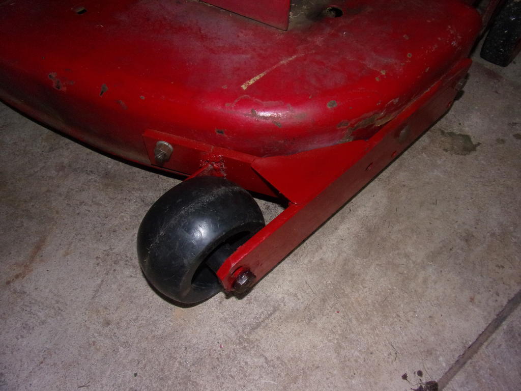

Ed Kennell 44,029 #3 Posted July 23, 2019 It cooled down enough to weld today, so I made the anti scalp roller brackets . 6 Share this post Link to post Share on other sites

Ed Kennell 44,029 #5 Posted July 23, 2019 Used the good one, but it didn't improve my welding. 1 Share this post Link to post Share on other sites
roadapples 6,985 #6 Posted July 24, 2019 Good job Ed. Great to be selfsufficient... 1 Share this post Link to post Share on other sites
