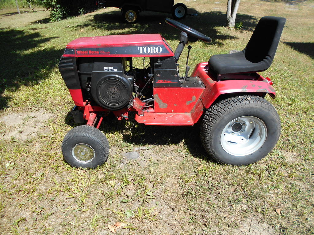

ohiofarmer 3,434 #5 Posted July 7, 2019 (edited) I have a 12 HP on a c-141. I changed it when I found that the unit ran but smoked, But it had a very nice 42" SD deck and snow blade all for $200.and very nice cosmetically.. While I was at it, i stole the seat and seat pan from the 520. It all bolts right up. What a sweet ride! Confusing --as this Frankenhorse is part of three tractors Just cut the speed a bit for a super nice cut. That is what is nice about a hydro. Adjust the speed for a perfect cut. Sharp blades also equal "more" horsepower in cut equivalency. You can cut just as much yard with the wider deck at 85% of the speed of the 42" I never was a fan of the steering column mounted transmission control on the 520. I absolutely love the side mount control lever on the c-141. Gonna spend the money for a rebuild on that 14 HP [runs but smokes] engine as it has an egg shaped combustion chamber. Edited July 7, 2019 by ohiofarmer 1 Share this post Link to post Share on other sites
