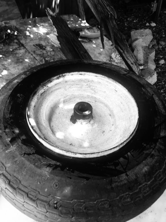

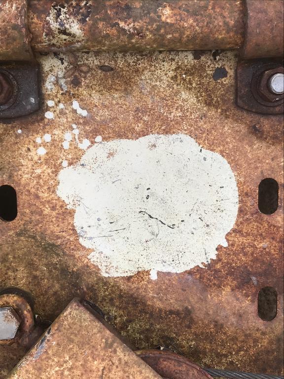

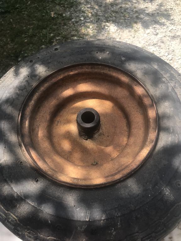

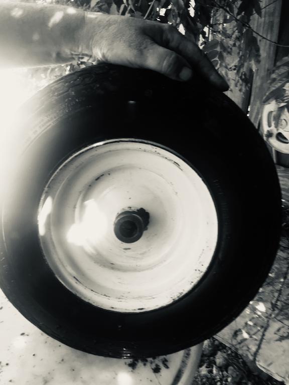

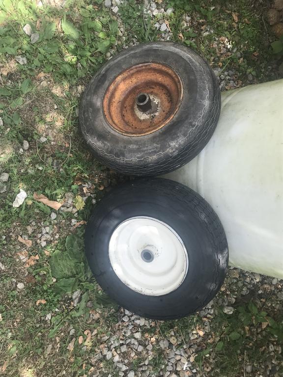

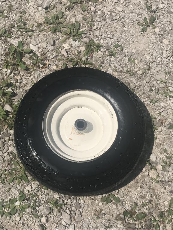

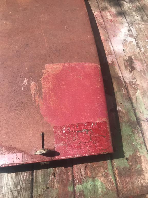

Lane Ranger 11,785 #1 Posted July 6, 2019 (edited) I would not believe it if I did not see this with my own eyes! Rodney Burger introduced me to a new product all you “Patina” Wheel Horse guys need to know about! Krud Kutter Rust Remover and Inhibitor Gel ! Works like naval jelly but is water based. Apply to wheels or hoods and let set for fifteen minutes! Cleans and removes rust! Also creates a voting that protects surface from additional surface rust. Hard to believe but it is very user friendly and you can buy online. And the wheel heel was not repainted! Edited July 6, 2019 by Lane Ranger 3 4 2 Share this post Link to post Share on other sites

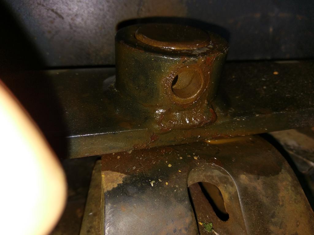

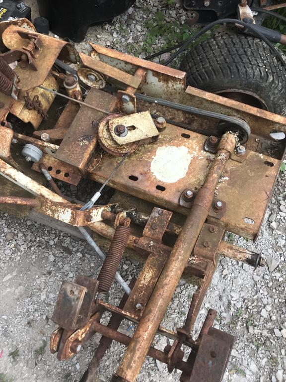

Lane Ranger 11,785 #17 Posted July 7, 2019 More Krud Kutter Rust Remover photos! Rusty Haban Sickle Bar Mower with spot applied Krud Kutter snd results! Keeps the paint on but takes the rust off. Pick of spot on wheel horse hood treated with Krud Kutter Rust Remover gel! 4 Share this post Link to post Share on other sites
