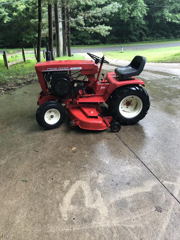

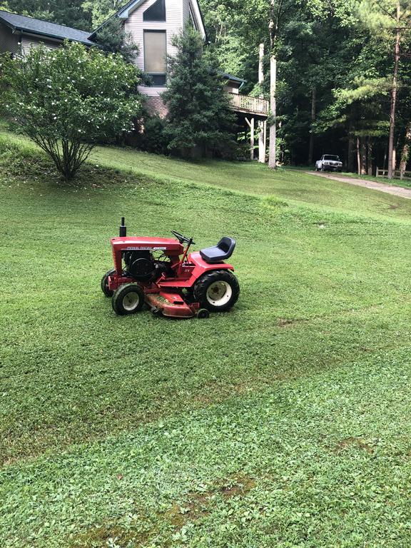

The Tuul Crib 7,340 #1 Posted July 4, 2019 Tonight was the first time I had mowed the front of my house with my 1067 that I just finished. What a beast!! 11 4 Share this post Link to post Share on other sites
ZXT 2,401 #2 Posted July 4, 2019 Man, that's a beauty! Good looking yard, too! 1 Share this post Link to post Share on other sites
The Tuul Crib 7,340 #3 Posted July 5, 2019 It’s a big challenge but now I know that I need more weight in the back. These agg tires have lots of grip. 2 Share this post Link to post Share on other sites
ZXT 2,401 #4 Posted July 5, 2019 More weight in the back for mowing? Or do you plan to hang other attachments off of it? Share this post Link to post Share on other sites
Stormin 9,987 #5 Posted July 5, 2019 I have ag's on my C-125 that does the mowing work. There's a couple of short climbs and turfs sometimes lost grip when the grass was damp or wet. Usually one or t'other. Share this post Link to post Share on other sites
The Tuul Crib 7,340 #6 Posted July 5, 2019 10 hours ago, ZXT said: More weight in the back for mowing? Or do you plan to hang other attachments off of it? I have a 48 inch blade for the front My hillside is were l need the traction. 1 Share this post Link to post Share on other sites
Jeff1981 18 #7 Posted July 6, 2019 Very nice machine! 1 Share this post Link to post Share on other sites
953 nut 63,918 #8 Posted July 6, 2019 13 hours ago, The Tool Crib said: I have a 48 inch blade for the front My hillside is were l need the traction. Liquid filled tires make a big difference. SIZE GALLONS Per Tire WEIGHT in POUNDS 16x6.50-8 2.0 21.4 18x7.00-8 3.0 32.1 18x8.50-8 3.4 36.4 18x9.50-8 4.0 42.8 23x8.50-12 5.5 58.9 23x10.50-12 6.8 72.8 6-12 3.6 38.5 Share this post Link to post Share on other sites
