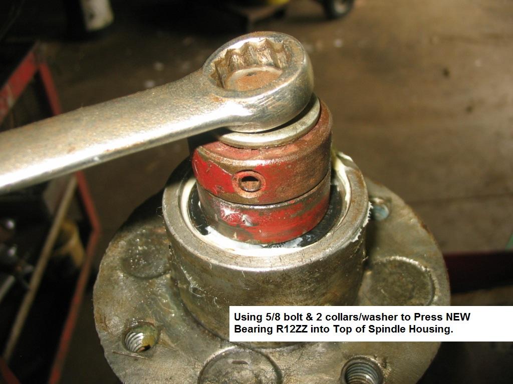

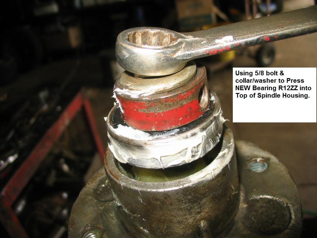

daveoman1966 3,882 #2 Posted July 4, 2019 Find a bolt 6 - 8 " long (or all thread) and run thru housing. Put a BIG wahser on one end and bolt thru that...extending thru other end of housing. Then , on the other end, start the bearing (grease the edges) into the housing. Draw it in slowly by turning the nut...as in this pic using a couple of 3/4" dia dollars as fillers... NEVER hammer any bearing to 'seat' it....just draw it in tiight with a large bolt & nut. 1 Share this post Link to post Share on other sites
