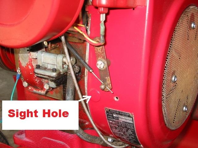

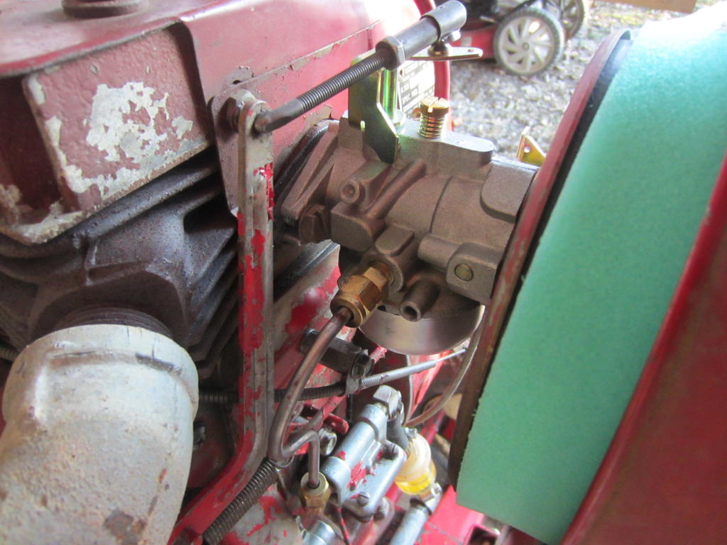

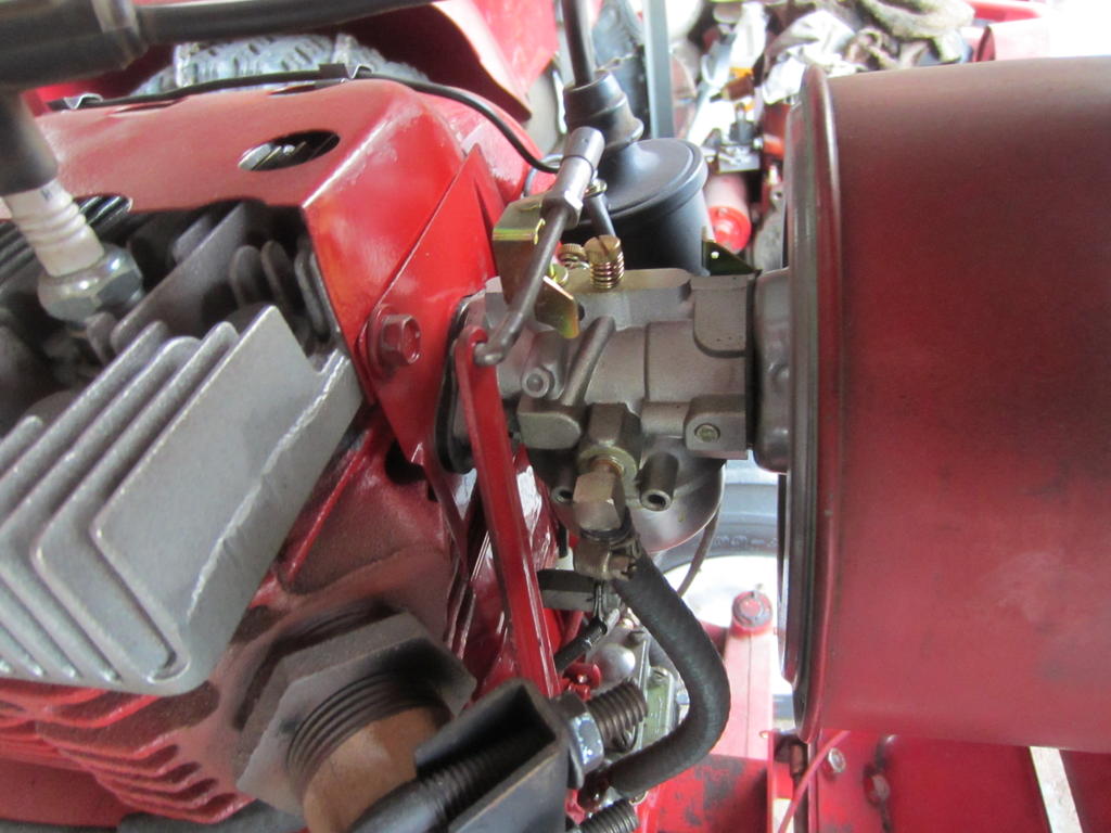

Fpare 3 #1 Posted July 3, 2019 Hello Gents, Can someone please post a couple of pictures of card side of their engine? (minus the air intake filter preferrably..?)...? I am working on a K301 and looking how to run choke cables, governor linkage, etc...... Thank you in advance..... 2 Share this post Link to post Share on other sites
Herder 2,355 #2 Posted July 3, 2019 Hope these are helpful. 2 Share this post Link to post Share on other sites
953 nut 63,972 #3 Posted July 3, 2019 (edited) On most Kohlers your throttle cable will cross the front of the engine as shown and will be held to the block by a clamp bolted to the the crankcase breather. Hope this is helpful. @herder is too fast for me! Edited July 3, 2019 by 953 nut 3 Share this post Link to post Share on other sites
Fpare 3 #4 Posted July 4, 2019 Thank you for the great pictures...! Got it all put back together now. Have a GREAT FOURTH! 1 Share this post Link to post Share on other sites
peter lena 9,710 #5 Posted July 4, 2019 FPARE, WELCOME TO THE SITE, in addition to the great linkage pictures above, the closer you can clamp on to the end of a cable the better , thats in addition to the regular clamps, easy to get at local hard ware store. also lubricate those cables so lube runs out of the end , ensuring smooth easy function. i also picked up some very small washers to tighten up the leverage points, over all making things work without effort. good luck with it , pete Share this post Link to post Share on other sites
