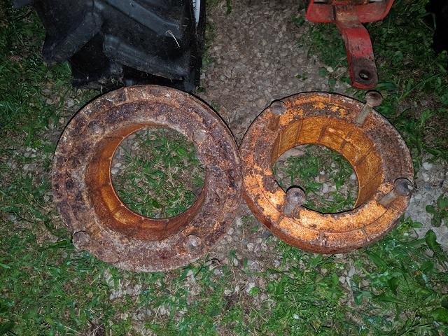

WildmanC120 613 #1 Posted July 3, 2019 Are these WH wheel weights? Picked them up tonight on FB marketplace cheap. I guess it doesn't really matter the brand was just curious. 1 Share this post Link to post Share on other sites
RandyLittrell 3,944 #2 Posted July 3, 2019 Ya did good!! Those are wheelhorse weights! Randy 1 Share this post Link to post Share on other sites
oliver2-44 11,272 #3 Posted July 3, 2019 Looks like you need to set up an E-Tank to clean them up the easy way! 2 Share this post Link to post Share on other sites
WildmanC120 613 #4 Posted July 3, 2019 Nice. I thought they were WH weights. I did well @ $50 for the pair. Not looking forward to clean up and paint though. 2 Share this post Link to post Share on other sites

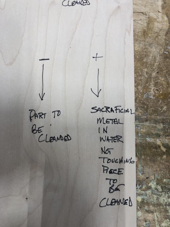

The Tuul Crib 7,347 #12 Posted July 3, 2019 Find a good old 12 V battery charger that doesn’t shut off that is constant. The water solution should be washing soda mixed in with the water and plug it in again don’t let the piece to be cleaned touch the sacrificial metal . I hope this makes sense Share this post Link to post Share on other sites

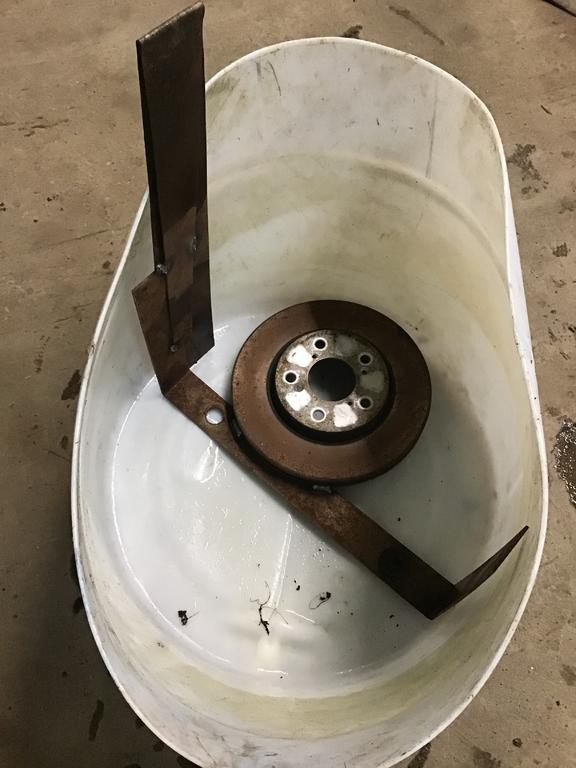

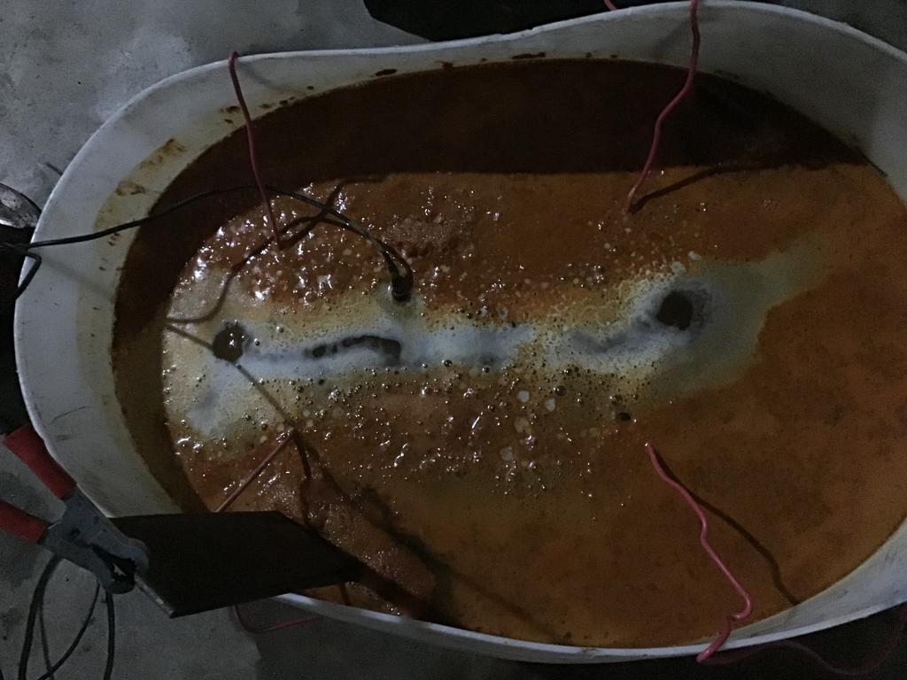

Pullstart 68,980 #14 Posted July 3, 2019 1 hour ago, WildmanC120 said: How would I set that up? Here is my tub. It’s a 55 gallon drum cut in half, with some scrap strapping and a brake rotor welded together for the anode. I suspend my parts with wire, wood, metal rod.... whatever keeps the anode and part from touching. I found that my 24v setting on my charger works much quicker (twice as fast?) as the 12v setting! 2 Share this post Link to post Share on other sites
Pullstart 68,980 #15 Posted July 3, 2019 Also, the anode should be arranged in a manner that is in a direct path of the part to be cleaned. Multiple anodes around the edges of the tub and one or two across the bottom would work great! Share this post Link to post Share on other sites
The Tuul Crib 7,347 #16 Posted July 3, 2019 28 minutes ago, pullstart said: Here is my tub. It’s a 55 gallon drum cut in half, with some scrap strapping and a brake rotor welded together for the anode. I suspend my parts with wire, wood, metal rod.... whatever keeps the anode and part from touching. I found that my 24v setting on my charger works much quicker (twice as fast?) as the 12v setting! Mmm is it soup yet??? 2 Share this post Link to post Share on other sites
857 horse 2,588 #17 Posted July 3, 2019 AMAZING RESULTS,,,,,,,,LET THE MAGIC BEGIN !!!!!!!!!!!!!!!!!! 1 1 Share this post Link to post Share on other sites

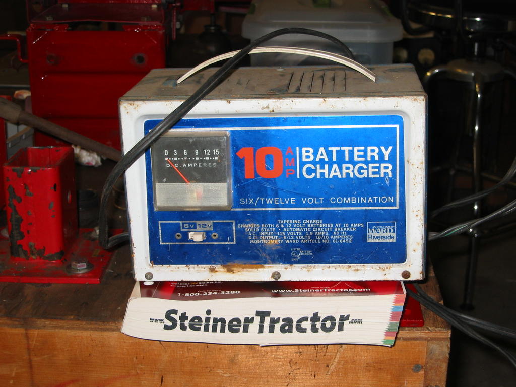

pfrederi 19,954 #19 Posted July 3, 2019 old simple is better no need for heavy duty. The new fancy chargers want to see some battery voltage before they will start charging. I use a Wards Riverside wonder how old it is.... 1 Share this post Link to post Share on other sites

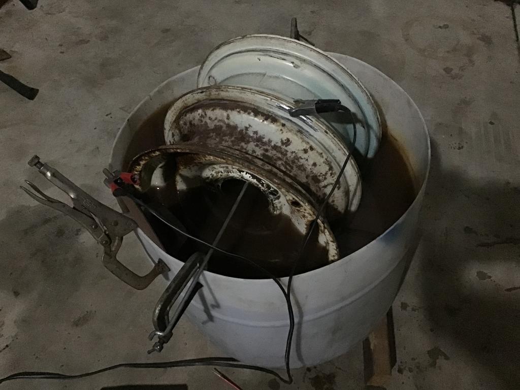

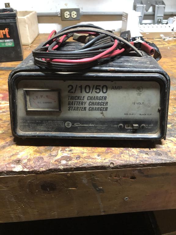

The Tuul Crib 7,347 #21 Posted July 3, 2019 3 hours ago, pfrederi said: old simple is better no need for heavy duty. The new fancy chargers want to see some battery voltage before they will start charging. I use a Wards Riverside wonder how old it is.... Wow now thats an antique!! But will out last anything on the shelf today! Heres what l use 1 Share this post Link to post Share on other sites
