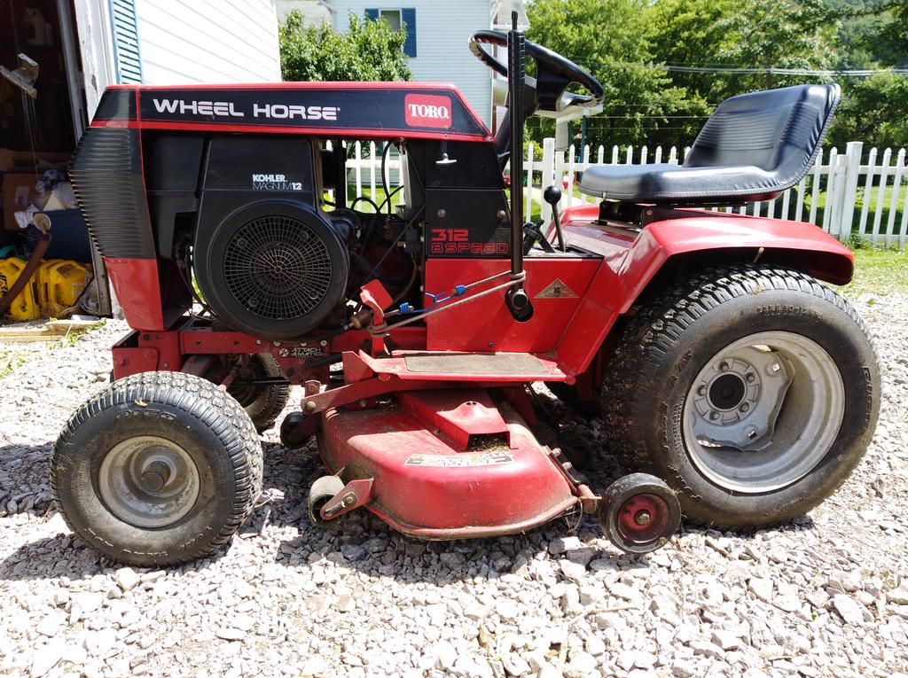

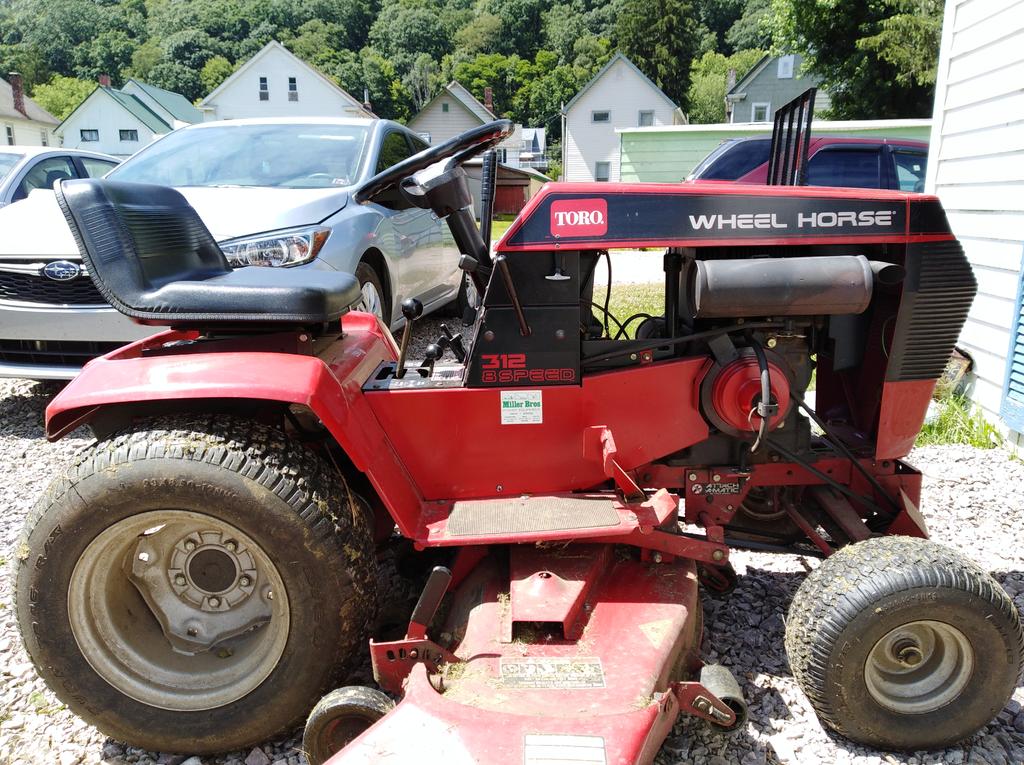

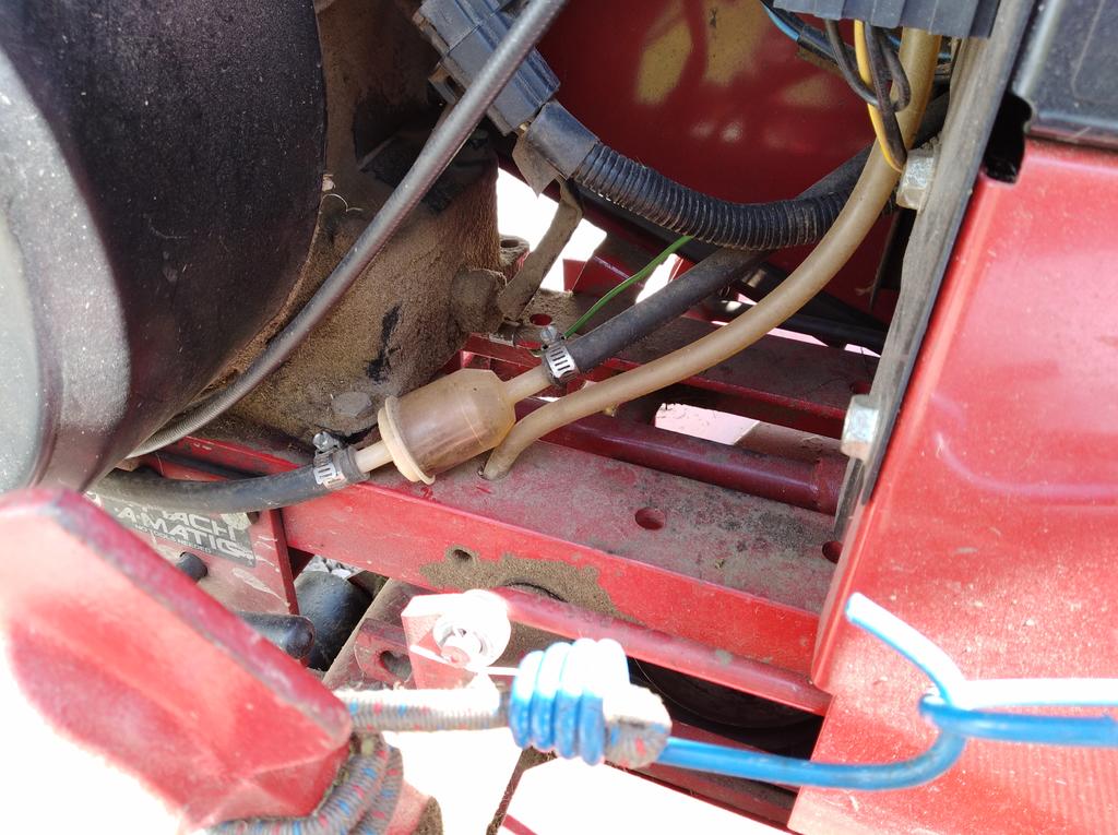

Rugith 6 #1 Posted July 2, 2019 I got this tractor last fall. She mowed pretty good the last couple mowings of the year and did good the first one of this year. I thought this year all I would need to do is get it cleaned up, change the fluids, and maybe new blades. Well, the last time I mowed with it, I ran the tank dry, filled it up, and haven't been able to start it since. Now excuse me for being so mechanical challenged but I swear I'm a fast learner with guidance. So I checked the gas bulb thing that appears to have a filter in it. Although there is a small amount of gas in it, it's by no means full. I'm wandering if it's vapor locked or something? Any thoughts would be great. Also you can see in the pictures that the clutch is rigged up with a bungie cord. If anyone could give me idea what to fix there that would be great. Hopefully it is as simple as swapping a spring 😁 Share this post Link to post Share on other sites
oliver2-44 11,214 #2 Posted July 2, 2019 First off lot of friendly help here. Your 312-8 is a great tractor. I restored a 1985 version for my son when he bought his first house. An engine needs Fuel, Air and Spark to run, so........ FUEL -Since running out of gas seemed to cause a change lets start with the fuel system. Your gas tank is located under the rear fender seat area, and is barely above the level of the carburetor when full. When you run out of gas you can suck any crud that might be in the bottom of the tank into the carburetor, the fuel pump, the in-line filter or the screen that is inside the bottom of the tank connected to the tank fuel shut off valve. The easiest place to start is to verify gas is getting to the carb. On the front of the engine, under the carb, disconnect the gas hose the goes between the fuel pump and the carb. Crank the engine over and see if gas is pumping out of the fuel pump. If you have gas there, it might be time to clean the carb. But next check... SPARK-The next easiest thing to do is verify you have spark. for safety, wipe up any gas that may be on or around the engine/floor from testing the gas flow. Pull the spark plug, and with the spark plug wire connected and the threaded part of the plug held against the top of the engine (to ground it) have someone crank the engine and watch if you see spark at the bottom end of the plug. (PS take a picture and show us what the end of it looks like ie clean or dirty, to help us help you. AIR-The next easiest thing to do is make sure all the parts of your engine are working to move air in and exhaust out. Remove the engine air filter and have some one crank the tractor over several revolutions, while covering the exhaust with your hand. The engine should suck enough air in and force it out the exhaust for you to feel air pumping out the exhaust. If you have SPARK and AIR, lets go back to FUEL. if you don't have gas spurting out of the fuel pump, work backwards toward the tank disconnecting the line at each connection until you get gas flow. (be ready to close the gas shutoff valve located at the bottom of the tank when you get flow). If you have flow before the fuel pump it means your pump needs to be cleaned or replaced. If you get to the shut off valve and still don't have flow, it means the screen inside the tank is plugged and needs to be replaced. if you had fuel coming out the carb side of the fuel pump, let us know and we can help you clean the carb. Make those checks and let us know what you find. Once you get it back running we can help you do a through maintenance on it. 5 Share this post Link to post Share on other sites

peter lena 9,764 #5 Posted July 2, 2019 that clutch issue is probably a broken return spring, trace the linkage lever back to the trunion swivel point . along side of transaxel. go to hardware store and pick up a similar size and tension spring . that fuel issue was probably growing for a long time before you got the horse. agree with above on fuel, engine state of tune issues . remember you are recovering neglect, probably won,t get it all the first time, stay with it , you will get it , pete Share this post Link to post Share on other sites

ohiofarmer 3,383 #8 Posted July 2, 2019 Before going through all the what ifs on the fuel system, what I would do is disconnect the fuel line back at you tank and add some line and a slave tank maybe five feet off the ground. My slave tank has a shut off valve as well for testing carbs against leaking What you want to do is get the air out of the fuel lines and prime the fuel pump. Once primed, the tractor may run normally the rest of the season . Even if it doesn't fix the problem, you still have a good diagnostic tool. 1 Share this post Link to post Share on other sites

gwest_ca-(File Mod) 12,000 #12 Posted July 3, 2019 One thing I have learned is the fuel hoses need to be soft and pliable when they are installed on the nipple. A hard hose will allow the fuel pump to suck air at the nipple connection but the fuel will not leak out at the same location making a leak hard to detect. Since air is compressible once it is mixed with the fuel the small fuel pump stroke is not large enough to overcome the air. The vacuum created by the pump just expands the air volume at each pulse with nothing left to pull the fuel along. These mechanical pumps are quite capable. I had a fuel cap vent plug up on a 312-8. The pump collapsed the tank and pulled the cap through the rear fender pan before the engine starved for fuel and quit. Had to pull the pan to get the cap off and blow the tank back up to full size. Garry 1 Share this post Link to post Share on other sites
clueless 3,348 #13 Posted July 3, 2019 These tank in the back single cylinders can be a bear to start when they've sat for awhile and even worse when run dry. The old blowing in the tank fill hole my help get things moving, just don't do it with more than a half of tank . I would empty the tank clean it and check the on off valve, then replace the fuel lines with new ones and a new filter, all petty easy and cheap. Then fill the tank about 1/4 full and spin it over, you need a fully charged battery, that may get it flowing. When I replaced the fuel lines on my 312-8 I put a outboard motor fuel squeeze ball between the line under the seat, again cheap fix. It can sit for months, lift the seat give it a couple of good squeezes, she fires right up . Share this post Link to post Share on other sites
Racinbob 12,765 #14 Posted July 3, 2019 As far as your clutch problem, \that model uses a gas spring located on the right side. It is attached to the idler arm and some point on the frame. It doesn't have the spring on the left side. Get a #108035 return spring and install it on the left. Remove the gas spring completely and you'll be good to go. Share this post Link to post Share on other sites
Rugith 6 #15 Posted July 11, 2019 Well, I finally found some time to do some diagnosing and i found out i don't have any fuel leaving the tank. I'm going to drop it this weekend and get it all cleaned out. Thanks for all the great replies. 2 1 Share this post Link to post Share on other sites
AHenry014 128 #16 Posted July 12, 2019 New tank petcock and grommets are very cheap and good insurance to ensure you have good flow. I install new fuel line on any tractor i get for good measure. I too have had the same issue as you when i ran the tractor dry. What i did was pull the fuel line from the inlet side of the fuel pump and drop the line below fuel tank level to draw the fuel up the line. Once its there, reconnect to the pump and you should be good to go. Sometimes the pump has a hard time self priming. Share this post Link to post Share on other sites
