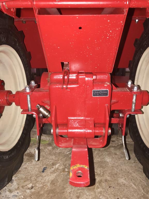

TimC121 0 #1 Posted July 1, 2019 does the rear axle attachment bracket c121 8 speed need to be centered on the axle or is it offset to one side? if so what are the measurements to install the axle bracket? Share this post Link to post Share on other sites
The Tuul Crib 7,340 #2 Posted July 1, 2019 (edited) Ive always centered up by eye the best you can . I dont think there any measurements specific to the installation. to!! of your C121!! Heres a shot of mine Edited July 1, 2019 by The Tool Crib 3 Share this post Link to post Share on other sites
Sparky-(Admin) 24,204 #3 Posted July 2, 2019 I have always kept mine a wee bit closer to the right side (looking at the machine from the rear) to make sure the plow frame clears the tranny drive pulley. 1 Share this post Link to post Share on other sites
