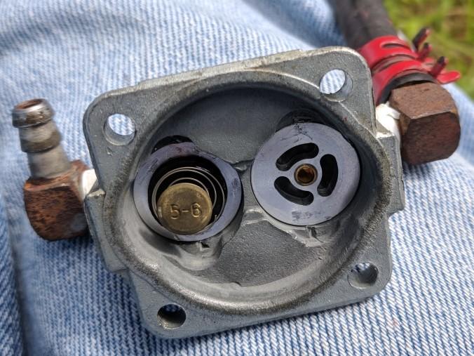

Still need help:
1. Please see the picture.
2. This is a metal pump rebuilt. New valves, new diaphragm.
3. Yes the machine has run fine - even a couple weeks ago.
4.The fuel is new.
5. Just replaced fuel filter. (correct direction)
6. Screen on tank valve is not clogged - flows well.
NEXT QUESTION: Please look at the picture. I rebuilt the pump myself using a kit and the tractor has run. But does it look like I did anything that might be going wrong?
How critical is the seating of the valves? In the instructions it said to use a flat head and hammer to tap a couple spots of aluminum housing next to the new valves to hold them in place. I did - as you can see.
I blew on the line going into the pump and air went right through. I blew on the outlet hose and a little air went through although barely.
Do I need to fill the fuel line somehow to get the whole thing primed?? Or should it just pull the fuel up?
thanks again! Really appreciating the assistance.

Those little pods are check valves and the flow direction is towards the carb. just like you found out by blowing into it. They "check" the flow in the other direction so it's a one way flow. The fuel pump may air lock and not be able to pull the fuel into it so pressurizing the tank by blowing it or using compressed air or a squeeze bulb will force the air out and fill it with fuel. Since you got a rebuild kit I assume the diaphragm is good.
953 nut
With a tank under the seat the fuel level is lower than the pump and fuel pumps are better pushers than suckers. Fill the tank, jack up the rear, remove the fuel line (with a container under it) from the pump and get the line full of fuel and put it back on the pump. Once it is liquid solid it should hold a prime.

Thanks everyone for your help. She's up and running again. Running fuel up into the lines did it well. Now I hope it holds the prime.
Thank you! Solved again!
