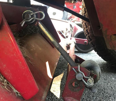

HerbS 6 #1 Posted July 1, 2019 I think this is called a deck stop. I'm missing one on my 518-H. Anyone know where I can get one. Share this post Link to post Share on other sites
gwest_ca-(File Mod) 12,015 #2 Posted July 1, 2019 Items 18 and 19 on this page? https://www.partstree.com/parts/toro/mower-deck-assemblies/05-48ms05-toro-48-side-discharge-mower-deck-1986/side-discharge-mower-42-in-107-cm-vehicle-identification-number-05-42ms04/ Garry Share this post Link to post Share on other sites
Lee1977 7,570 #4 Posted July 1, 2019 After getting the part no. from Parts Tree. Check the price on RCPW I have found they are usually a little cheaper and have free shipping on most parts. You can find them in "Redsquare Links with a lot of other suppliers. Share this post Link to post Share on other sites
gwest_ca-(File Mod) 12,015 #5 Posted July 1, 2019 Do you know the model number of the deck you have? Seems to me the rod size was increased from 3/8" to 1/2" so the parts may not be the correct size. There was a service bulletin on it that I can not find at the moment. Garry Share this post Link to post Share on other sites
gwest_ca-(File Mod) 12,015 #6 Posted July 1, 2019 Found it. Click on the fuzzy picture Good time to update your deck. Garry Share this post Link to post Share on other sites
