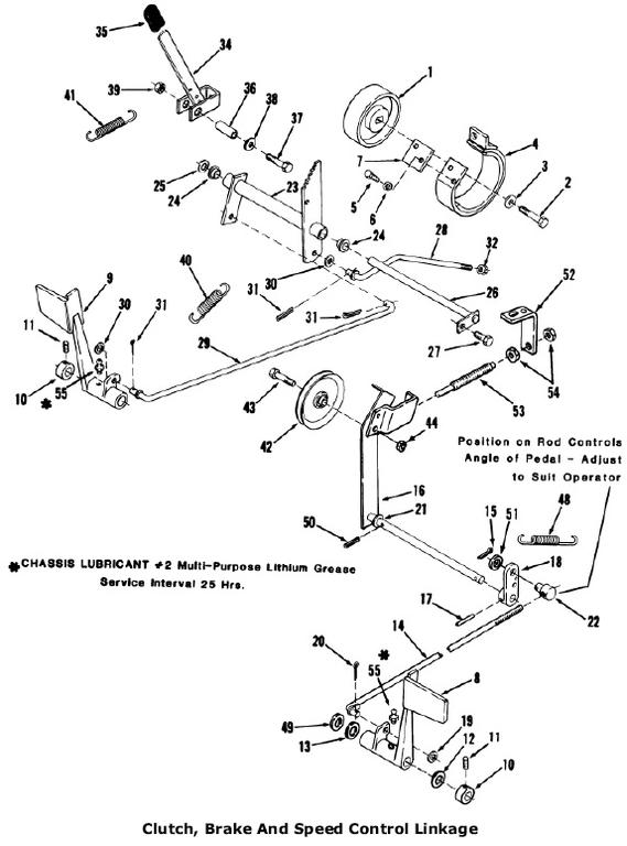

Islander 0 #1 Posted June 30, 2019 Hi. On my 1990 416-8 there is a piston type part on a bracket that is contacted by a plate connected to the clutch take-up pulley. When you let up on the clutch the plate contacts the piston. What is the purpose of this piston part? My clutch plate is misaligned and didn’t touch the piston, and all seems to work fine. Sorry that I don’t know the official names of the parts, but I hope my question is understandable. Thanks. Share this post Link to post Share on other sites

gwest_ca-(File Mod) 11,471 #4 Posted July 1, 2019 The first design is what I would call an air shock. There is a small hole that allows air to enter and exit the cylinder as the plunger is moved. Dust and dirt gets sucked into it affecting it's operation. Have cleaned this type up and made them work again. The damper is #53 Return spring is #48 on the left side of the transmission Garry 1 Share this post Link to post Share on other sites

Islander 0 #6 Posted July 1, 2019 3 hours ago, gwest_ca said: The first design is what I would call an air shock. There is a small hole that allows air to enter and exit the cylinder as the plunger is moved. Dust and dirt gets sucked into it affecting it's operation. Have cleaned this type up and made them work again. The damper is #53 Return spring is #48 on the left side of the transmission Garry Thanks Garry. Do you happen to know if the strike plate on the arm #16 is welded, or just bolted? It appears to be misaligned with the damper, but I don’t know if it is adjustable. Share this post Link to post Share on other sites
