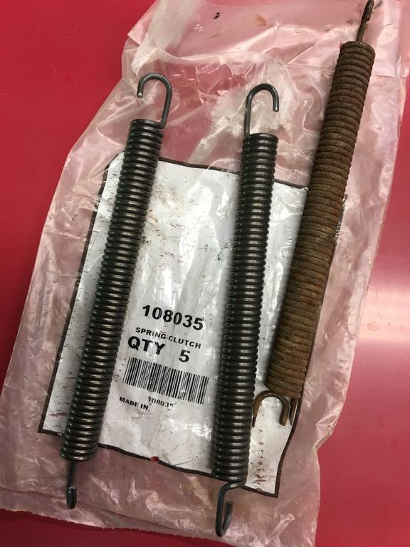

Cookie 0 #20 Posted June 3, 2022 I have a 1994 WH 314-8 it has both the gas shock on the right side of the tractor and a spring on the left side that is hooked to the end of the clutch rod and my clutch pedal "chatters" when the tractor is running. I haven't checked the shock to see if the shock is worn out, but if it is and I remove it will that stop my pedal from "chattering" or could the spring (#108035) be stretched out too ? If I just replaced the spring (#108035) will that stop my pedal from "chattering" ? Share this post Link to post Share on other sites
Racinbob 12,800 #21 Posted June 3, 2022 7 minutes ago, Cookie said: I have a 1994 WH 314-8 it has both the gas shock on the right side of the tractor and a spring on the left side that is hooked to the end of the clutch rod and my clutch pedal "chatters" when the tractor is running. I haven't checked the shock to see if the shock is worn out, but if it is and I remove it will that stop my pedal from "chattering" or could the spring (#108035) be stretched out too ? If I just replaced the spring (#108035) will that stop my pedal from "chattering" ? In 2009 I purchased a 2005 Classic GT with only 100 hours on it. Having been on Wheel Horses since 1960 this was by far the newest machine I ever had. Right off the get go I noticed a slight lag in the clutch engagement and didn't like it. Looking in to it I discovered the hydraulic damper. Garbage. I removed it and then I had a slight chatter. Not wanting to put the damper back on I replaced the belt even though it looked good. Problem solved and I'm still running the same belt. The moral of the story is that these machines worked fine with just the spring for decades and they still will. 3 Share this post Link to post Share on other sites
Cookie 0 #22 Posted June 3, 2022 Which belt did you replace ? Share this post Link to post Share on other sites
Racinbob 12,800 #23 Posted June 3, 2022 1 minute ago, Cookie said: Which belt did you replace ? The drive belt. I had posted the problem here and someone suggested it to me. A bad belt may not look bad. I can only assume that the stupid damper harmed the belt after only 100 hours. Share this post Link to post Share on other sites
Cookie 0 #24 Posted June 3, 2022 Alright, I'll try that, I really didn't want to spend all that money on the damper if I didn't have to. I just spoke to a WH dealer and he said it could be either the belt or the idler pulley. Thank you for your help. Share this post Link to post Share on other sites
Racinbob 12,800 #25 Posted June 3, 2022 1 hour ago, Cookie said: Alright, I'll try that, I really didn't want to spend all that money on the damper if I didn't have to. I just spoke to a WH dealer and he said it could be either the belt or the idler pulley. Thank you for your help. He could be right about the idler but I'm laying odds on simply the belt Share this post Link to post Share on other sites
