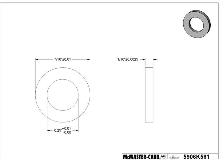

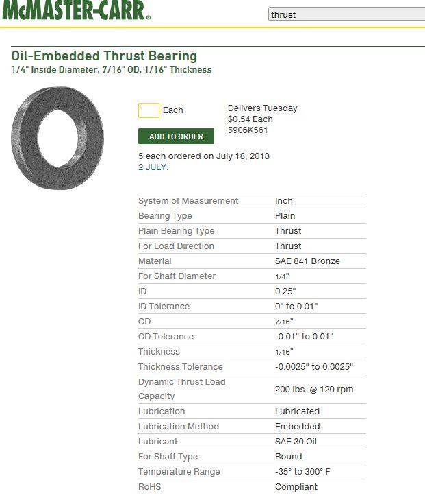

pfrederi 19,278 #3 Posted June 30, 2019 If you need alot 3 Share this post Link to post Share on other sites
