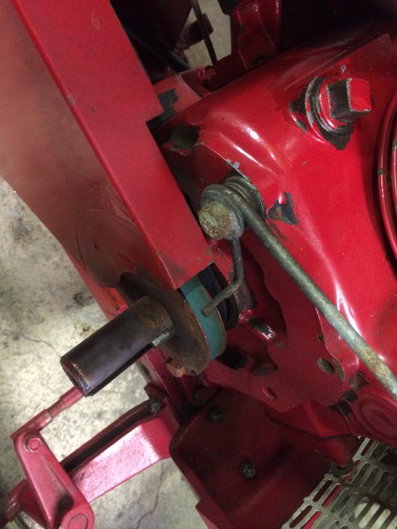

squonk 45,935 #6 Posted June 29, 2019 Guys, My 953 belt guard has no tabs to speak of on it and no evidence there was ever one on it. I bought the tractor at the show and the belt was worn. Calls for an 82" belt. I got a new belt and am having the same problem. The metal guide wire that bolts to the engine, does it go under the front edge of the belt guard? I have been slipping the belt in 3rd gear to "wear the belt in and it is getting better. I found a picture of the inside of the belt guard on E bay. The only guide I see is for the hyd pump. 1 Share this post Link to post Share on other sites

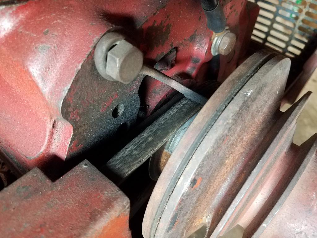

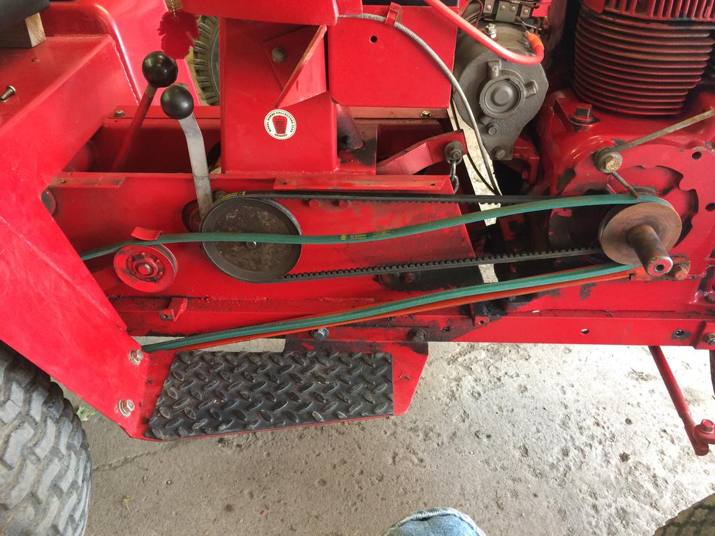

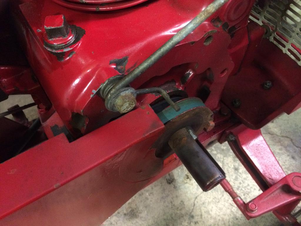

Shynon 7,545 #9 Posted June 29, 2019 Here's mine 4 3 1 Share this post Link to post Share on other sites

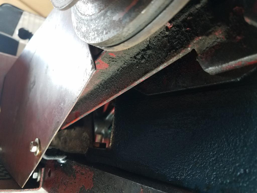

squonk 45,935 #10 Posted June 29, 2019 Thanks Tom. I know my front guide was no where near that position. I'll have to check the back. 2 Share this post Link to post Share on other sites

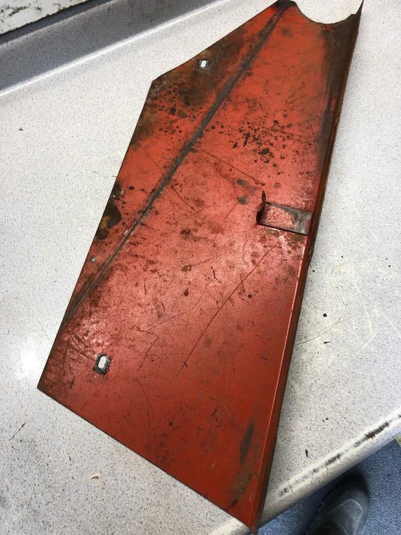

squonk 45,935 #11 Posted June 29, 2019 Here is a pic of my front guide Looks shorter than Tom's . The rear guide is missing. 2 Share this post Link to post Share on other sites

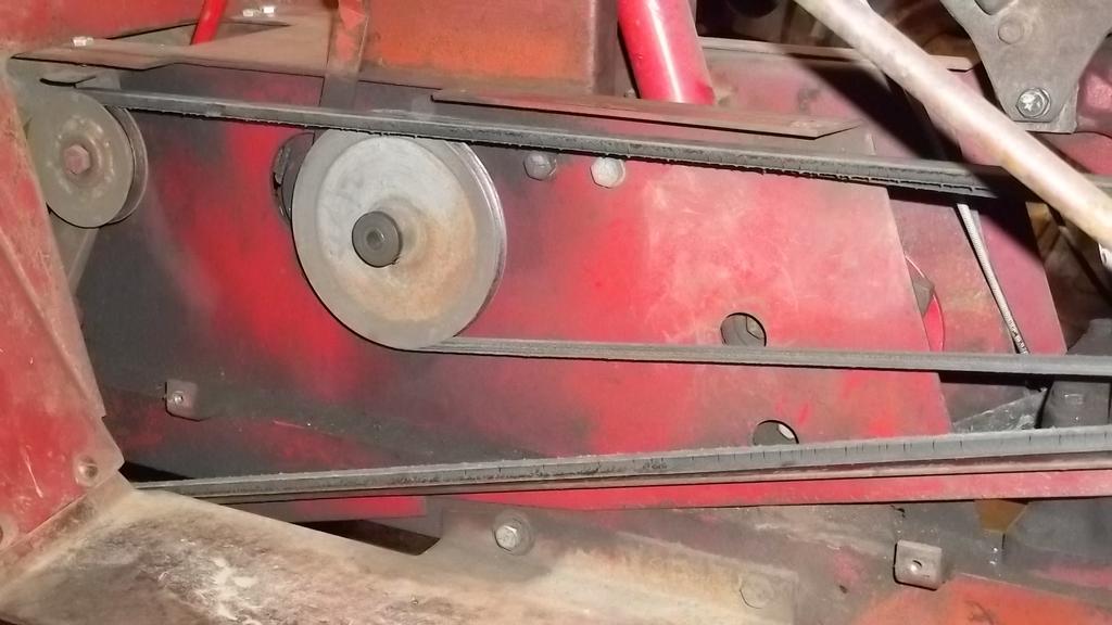

squonk 45,935 #14 Posted June 29, 2019 Here is a picture of my belt in the pedal depressed position. It is acting better. I can stop the belt if in gear and the brake on. I can shift between gears. If I run it in neutral and depress the clutch the belt doesn't stop and I cannot shift into a gear. I do have a Napa green belt on it which tends to be a little more grippy. Perhaps some more wearing it in will take care of it. Share this post Link to post Share on other sites

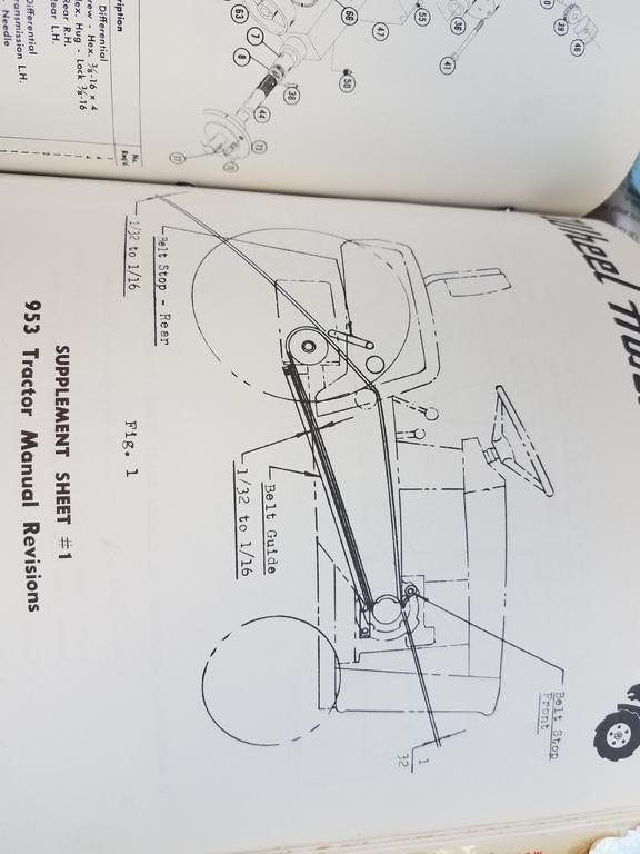

Shynon 7,545 #15 Posted June 29, 2019 Here's a picture from the manual 2 Share this post Link to post Share on other sites

Baxter 1 1 #19 Posted June 30, 2019 On 6/29/2019 at 7:47 AM, Shynon said: Here's a picture from the manual Do you have the manual you can post? I need to figure out where the clutch adjustment is. Share this post Link to post Share on other sites

Shynon 7,545 #22 Posted June 30, 2019 20 minutes ago, Baxter 1 said: I am looking for the operating manuals. click on download the file, then there are 3 choices, download the 1st one and scroll down you will find what you are looking for. 1 Share this post Link to post Share on other sites

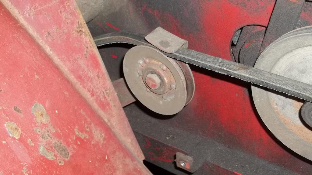

squonk 45,935 #23 Posted July 6, 2019 (edited) I took the 953 out for another ride today. Before I did I made another adjustment. Look at the picture from @WHX24's 953. The belt retainer thingy on the idler pulley is toward the rear. I had mine in the middle and tried it towards the front. I moved it to the rear (like Slim Jim's ) put the guard back on and went for a ride. I don't know if it was coincidence or not but the belt now will stop even in neutral with the clutch depressed. Edited July 6, 2019 by squonk 1 Share this post Link to post Share on other sites

953 nut 64,898 #25 Posted July 7, 2019 9 hours ago, squonk said: The belt retainer thingy on the idler pulley is toward the rear. I had mine in the middle and tried it towards the front. I moved it to the rear Mine is at the top with the clutch released. With the clutch depressed it grabs the belt slack. 1 Share this post Link to post Share on other sites
