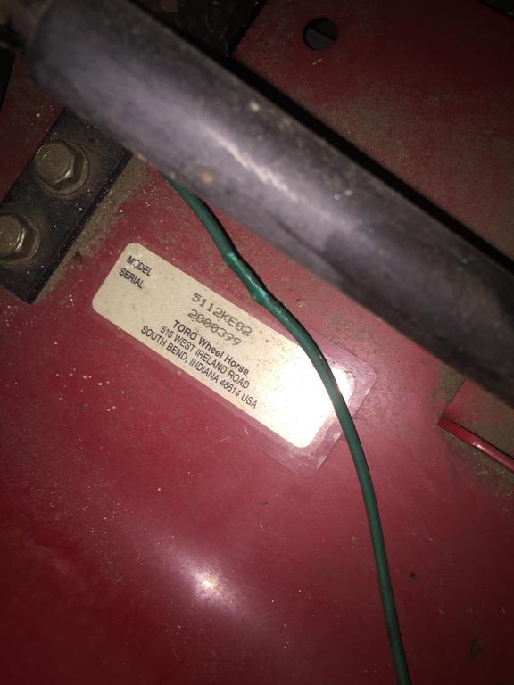

gwest_ca-(File Mod) 11,990 #6 Posted June 25, 2019 35 minutes ago, NYJack said: Sorry, it is 312 Hdryo with the 12 HP Koehler. Still not enough to identify. By chance do you have the model number and serial number from the decal on the rear fender pan under the left side of the seat? Failing that post all the numbers off the engine decal including the serial number. Garry 1 Share this post Link to post Share on other sites

gwest_ca-(File Mod) 11,990 #9 Posted June 26, 2019 I think 953 nut misread your model number. Your tractor is a 1992 model 51-12KE02. Might not make any difference but just in case it does ---- Garry Share this post Link to post Share on other sites
