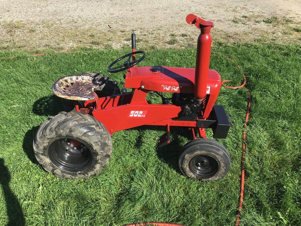

Pullstart 68,956 #11 Posted June 26, 2019 I put an 8 speed out of a C-101 into my 502. All the work that @ri702bill mentioned seems very accurate to me too here are a couple pictures showing the shortened dipstick and some other details. 1 Share this post Link to post Share on other sites
