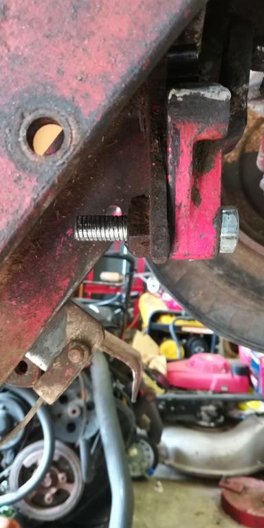

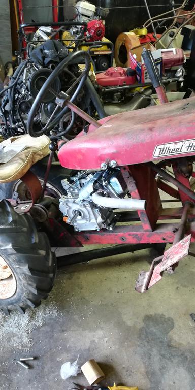

Brent Fabian 57 #1 Posted June 23, 2019 So I have finally gotten around to starting my wheel horse build. First thing I am starting with is the engine, nothing too important or significant modification here. It is a predator 79cc from harbor freight, cheap and simple. The only modification that you need to do to put it on your 400 is remove the predator gas tank and run a fuel line to the original tractor tank, and re route the exhaust, as the standard predator exhaust exits directly into the hood support. Other than that, they bolt directly into the holes for the original k91 motor. I also discovered the threads for the steering sector gear on this one are different thread than the ones on my other horse, as I ran the bolt into the hole it pretty much flattened the threads on the bolt. But its in and it works. This is the easiest part of the build, can't wait to continue the build, next up is getting wheels to fit! 4 2 Share this post Link to post Share on other sites

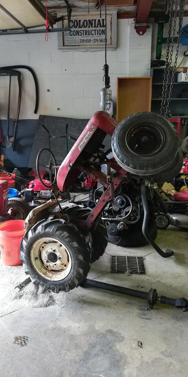

Daron1965 644 #2 Posted June 29, 2019 Hoist looks very helpful. Good job, more pics please. Share this post Link to post Share on other sites
Pullstart 67,260 #3 Posted June 30, 2019 46 minutes ago, Daron1965 said: Hoist looks very helpful. Good job, more pics please. It almost looks like the trouble light is the lifting agent! I’d like to see how that 79cc works for this project, maybe we’ll build one a Kohler and one Predator powered RJ! 1 2 Share this post Link to post Share on other sites
RandyLittrell 3,906 #4 Posted July 2, 2019 Keep posting pics, we like them around here!! I have a 401 that I want to go ratrod with to keep up with you guys!! Randy Share this post Link to post Share on other sites
953 nut 60,724 #5 Posted July 2, 2019 On 6/29/2019 at 8:09 PM, pullstart said: looks like the trouble light is the lifting agent! IT IS! That chain is just hanging there in the background. That trouble light reel has a very strong spring in it! 1 Share this post Link to post Share on other sites
LengerichKA88 1,883 #6 Posted July 3, 2019 (edited) Wait.... you guys don’t use drop lights and extension cord to hang stuff? Oops Edited July 3, 2019 by LengerichKA88 Share this post Link to post Share on other sites
