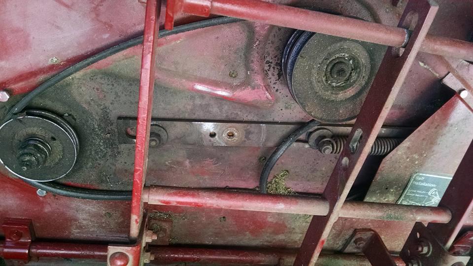

Paul Boy 31 #1 Posted June 22, 2019 While mowing today I seem to have lost the center bearing from the center pulley of my 36" rear discharge mower. Looked everywhere and could not find the part. Checked all local places in my city for something to solve my problem to no avail. The pulley is a 31/2 inch pulley. I've taken the numbers from the deck and hope someone might be able to help me in getting this fixed or a replacement part. My mower identification number is 0536mr01 - 5411 and the number under that is 9253. My tractor is a C-111. Grass is growing as we speak. Can anyone offer a suggestion? Share this post Link to post Share on other sites

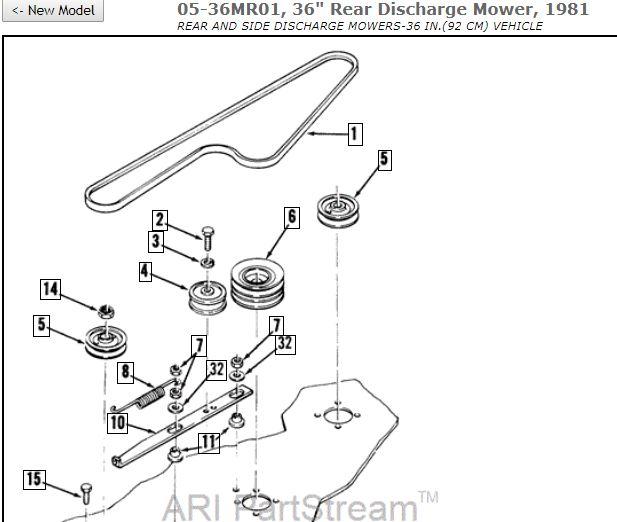

daveoman1966 3,882 #2 Posted June 22, 2019 (edited) The center pulley (# 6 in this schematic) is # 107439... about $120 bux ....or more NEW. The IDLER PULLEY... # 4 is # 7434 (or 112426) .... about $16 on-line sources. Edited June 22, 2019 by daveoman1966 1 Share this post Link to post Share on other sites
oliver2-44 11,214 #3 Posted June 22, 2019 You might check with A-Z Tractor in our vendor section for a good used one. Share this post Link to post Share on other sites
Lee1977 7,554 #4 Posted June 22, 2019 (edited) If I read your post right, You are looking for the idler pulley ( some thing about a bearing ). The part number is 112426 idler pulley. RCPW (Replacement Commercial Parts Warehouse ) has Toro part 112426 idler pulley for $18.76 with free ground shipping. i have ordered from them and they usually get the part out quick. Edited June 22, 2019 by Lee1977 Share this post Link to post Share on other sites
peter lena 9,768 #5 Posted June 22, 2019 you might pull that pulley and check it against similar at your local T/S store , or local mower shop for quickest back on line time. pete Share this post Link to post Share on other sites

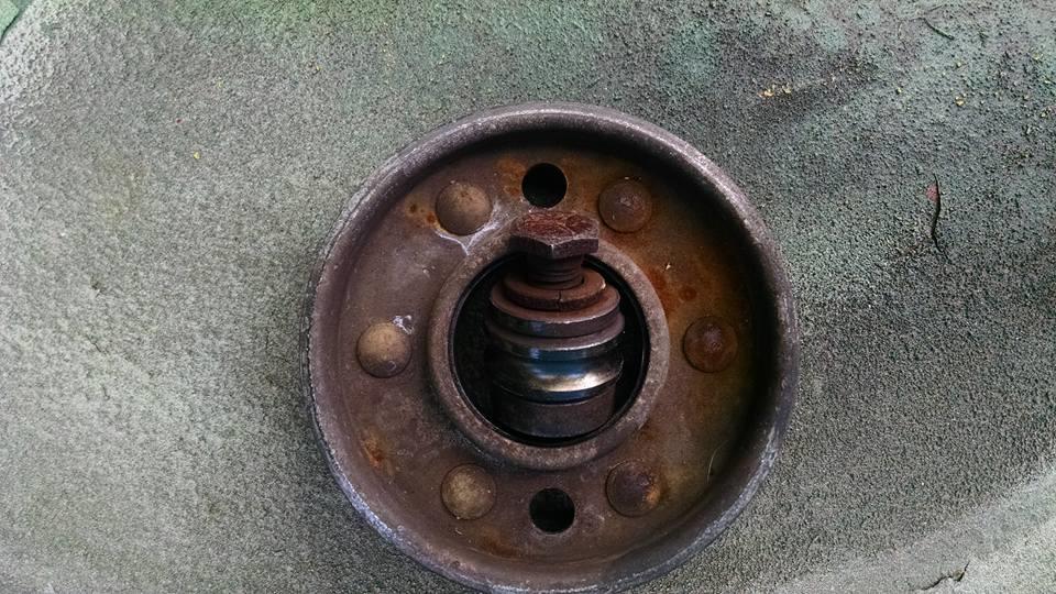

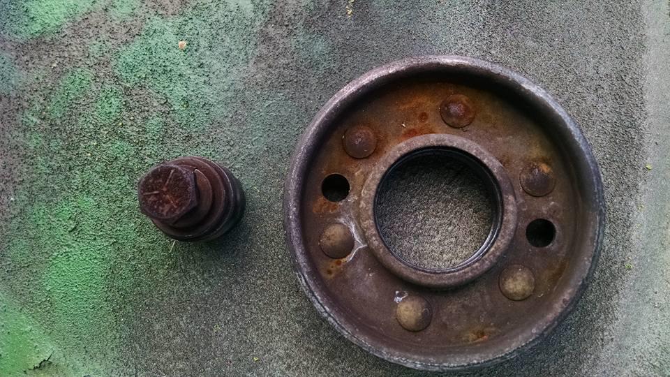

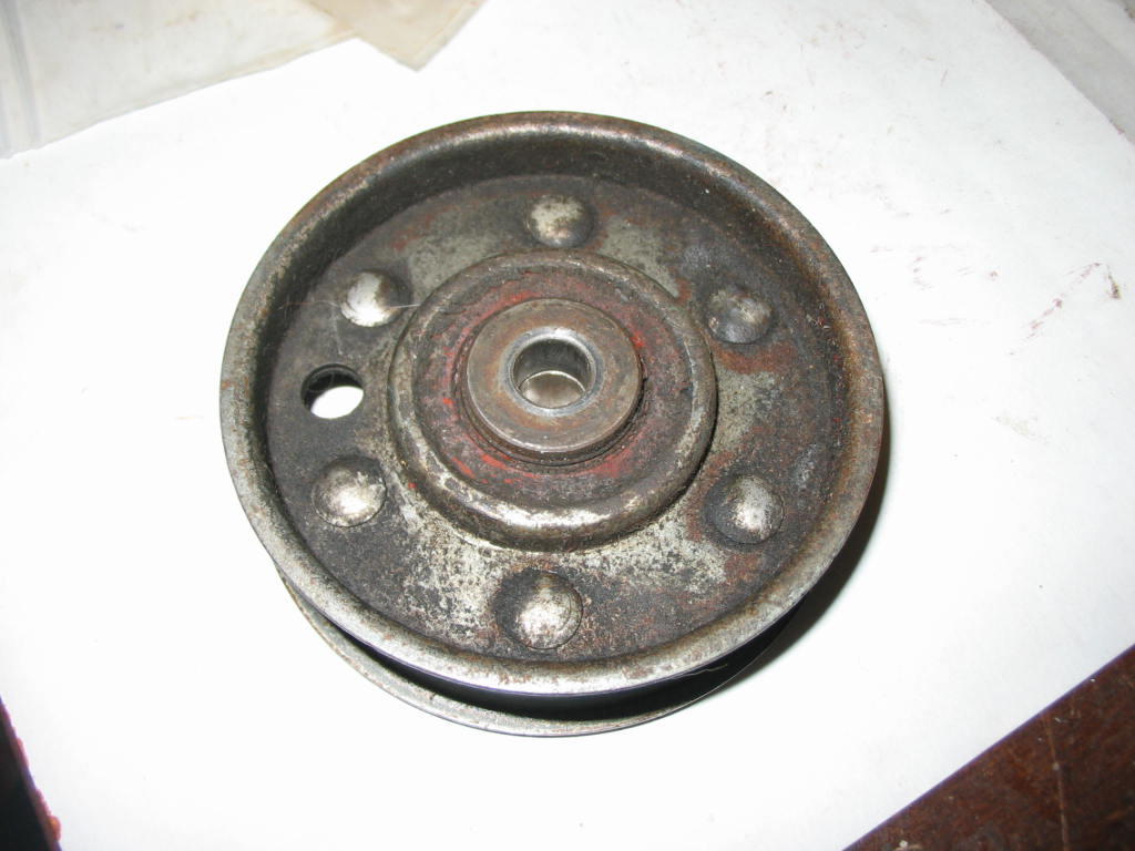

Paul Boy 31 #6 Posted June 22, 2019 (edited) I will take a photo of what I need and put it on here. I am not sure that I am describing it right. Edited June 22, 2019 by Paul Boy PHOTOS Share this post Link to post Share on other sites
Paul Boy 31 #7 Posted June 22, 2019 30 minutes ago, Paul Boy said: I will take a photo of what I need and put it on here. I am not sure that I am describing it right. Share this post Link to post Share on other sites

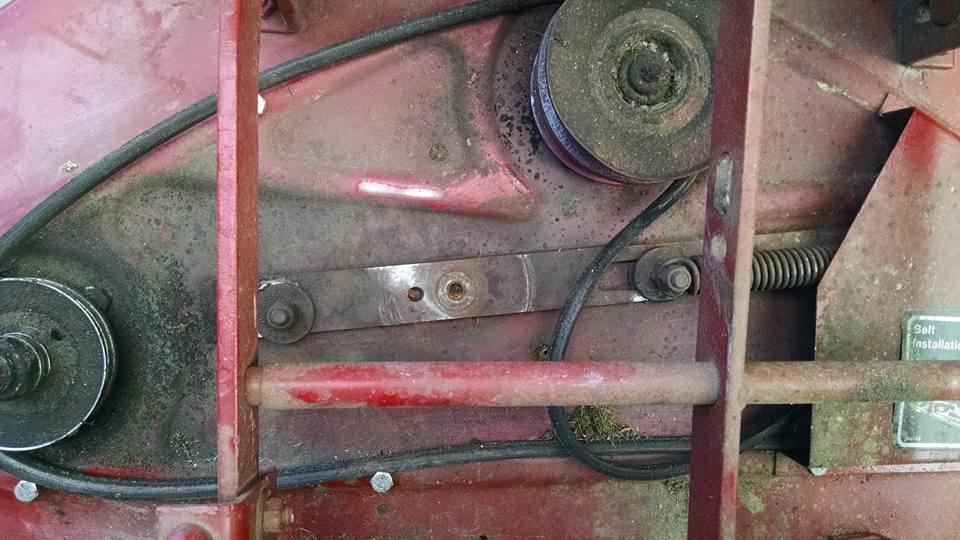

Paul Boy 31 #8 Posted June 22, 2019 The pulley goes into the hole shown on the deck. What I lost appears to be the ring with the bearings in it. I would like to find another complete pulley unit. Can anyone help? Share this post Link to post Share on other sites

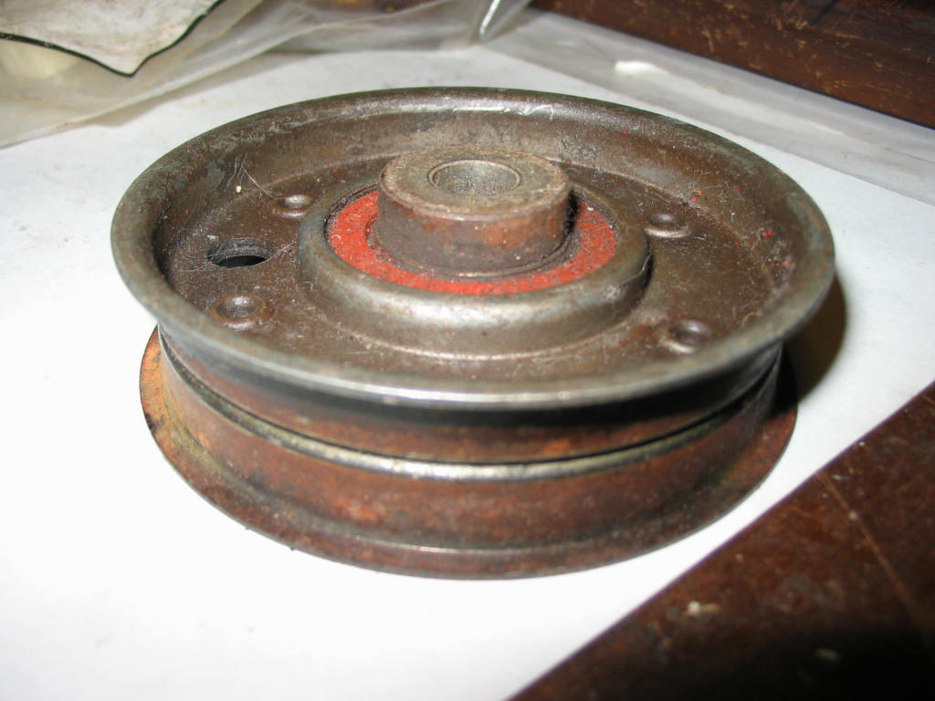

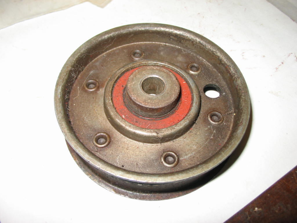

daveoman1966 3,882 #9 Posted June 22, 2019 I have that EXACT pulley...in my hand... you can have it for $15...shipped... Bearing is excellent...no drag and no wobble. Paypal works for me... 2 Share this post Link to post Share on other sites
Paul Boy 31 #10 Posted June 22, 2019 3 1/4 inches? I don't have paypal but I can send you a check Share this post Link to post Share on other sites
daveoman1966 3,882 #11 Posted June 22, 2019 You can send me a p check... OR... go to a convenience store and buy a $15 m.order (Preferred). PM sent with my address.... Open your MESSAGES for my mailing addreess... email is: daveoman@windstream.net Share this post Link to post Share on other sites

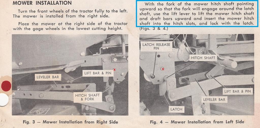

Paul Boy 31 #12 Posted June 27, 2019 Received the idler pulley for my mower today. Its back on and running and cutting well BUT .... its a rear discharge deck and it seems to be way too close to the rear wheels on the tractor after reinstalling the deck. What have I done wrong? Share this post Link to post Share on other sites
daveoman1966 3,882 #13 Posted June 27, 2019 You probably don't have it "locked" in the tach-o-matic hitch right. Look at this 'fork' and how it should be. Share this post Link to post Share on other sites
