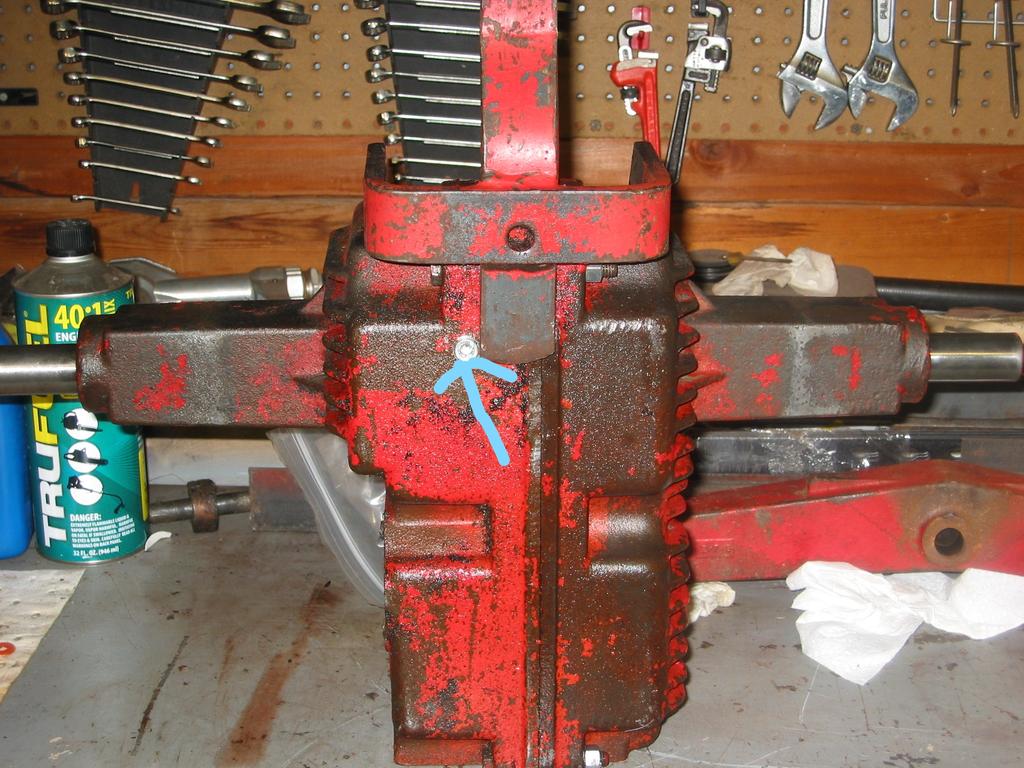

tunahead72 2,621 #5 Posted June 22, 2019 5 hours ago, pfrederi said: Drain plug 1/4" allen wrench needed Notice the drain plug is on the bottom of the transmission case, not the square plug on the top. No need to tip it to the side to get it to drain well. Share this post Link to post Share on other sites
