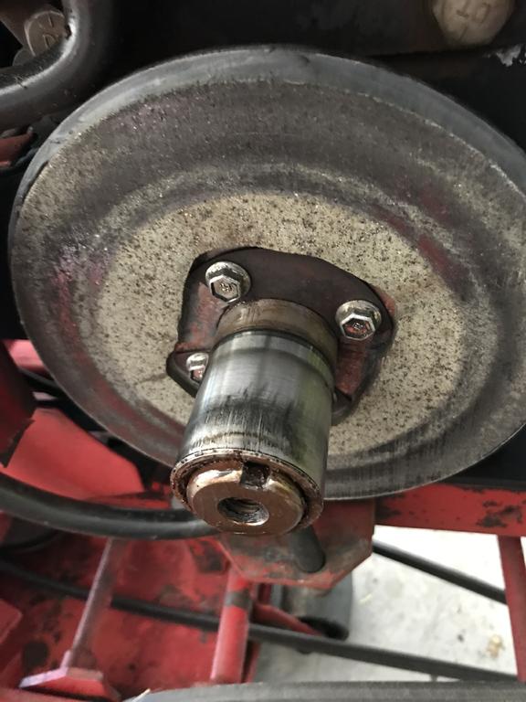

JoeA 3 #1 Posted June 21, 2019 Recently picked up 417a. The PTO slows down and stops when cutting have 48 inch deck I replaced the clutch surface and grease seal on PTO housing the blades seem to spin freely the mule pulleys seem to spin freely. When I do engage the blades they spin but on my 312 8 the spin up was quite loud these spin up but not that loud. I tightened the engagement rod but do not want to go to tight any ideas Share this post Link to post Share on other sites
JoeA 3 #2 Posted June 21, 2019 Ok so after some more trouble shooting this is what I have found when I engage the PTO the engine deflects I also found with the PTO engaged I can turn the outer pulley by hand. I think the linkage is tight enough since the engine is deflecting Any ideas ? Share this post Link to post Share on other sites

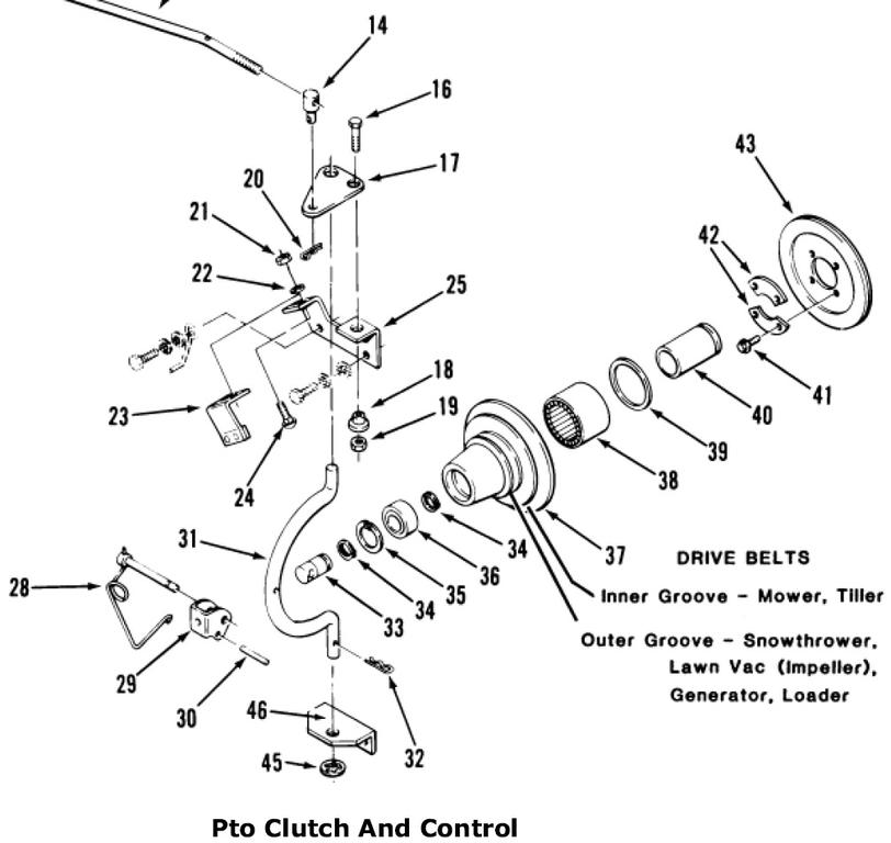

Lee1977 7,553 #3 Posted June 21, 2019 (edited) Could be the the rubber mounts between the engine plate and the frame. There is a metal replacement made by some one It was posted in the last week or so. Zack Kerber Machine & Design Solid engine mount set $24.50 You said 417 A I was think C-175 above. Your engine should be mounted solid but there is a plate under it. Are you sure the engine is moving. There Is a short shaft in the end of the PTO pulley with two C-clip with a bearing between connected to the PTO loop. If the bearing is bad or the out side C-clip comes off you can't adjust the PTO. Edited June 21, 2019 by Lee1977 Share this post Link to post Share on other sites
gwest_ca-(File Mod) 12,000 #4 Posted June 21, 2019 If you can turn the pulley by hand with the pto engaged it is not tight enough and slipping. Check to make sure the snap ring 34 on the stub shaft 33 that pushes on the outer bearing has not popped out of it's groove. Retaining rings are punched out when made so one side has rounded edges and the other side has nice sharp edges. That sharp edge needs to face out in this case to stay in the groove. A rounded edge can slip out under pressure resulting in the stub shaft being pushed into the bearing instead of pushing the clutch in. Garry Share this post Link to post Share on other sites

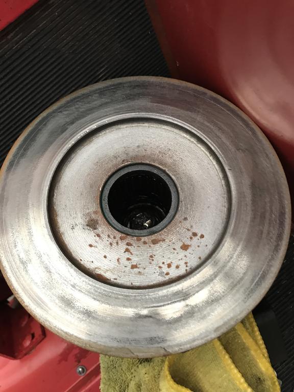

lynnmor 8,627 #5 Posted June 21, 2019 What kind of a mess do you have there? It appears that the clutch plate is on backwards and the whole center is broken out. Disassemble the PTO and give us photos of all the parts. 2 Share this post Link to post Share on other sites
Lee1977 7,553 #6 Posted June 21, 2019 3 minutes ago, lynnmor said: What kind of a mess do you have there? It appears that the clutch plate is on backwards and the whole center is broken out. Disassemble the PTO and give us photos of all the parts. I believe that's just a poor job of some one attaching clutch material. Share this post Link to post Share on other sites
JoeA 3 #7 Posted June 21, 2019 The clutch is after market that I JB welded onto the old plate the center is carved out so the retrainer clips will fit the inside diameter was to large so needed to be modified. Stub shaft question and answer yes the snap ring is in place. Does the stub shaft float in and out when not under pressure or is it always in a fixed position Thank You Share this post Link to post Share on other sites
gwest_ca-(File Mod) 12,000 #8 Posted June 21, 2019 The stub shaft should stay with the 36 ball bearing because there is another 34 snap ring on the other side of the bearing. 35 is a large retaining ring keeping the 36 ball bearing in the pulley. Garry Share this post Link to post Share on other sites
Rfp55 33 #9 Posted June 22, 2019 By looking at 2nd pic, and parts diagram - your clutch disc #43 has the hub broke out of it. Small fix maybe. Share this post Link to post Share on other sites
clueless 3,348 #10 Posted June 22, 2019 I'm pretty sure what ever that is that's bolted to the pulley ain't gonna work. Share this post Link to post Share on other sites
gwest_ca-(File Mod) 12,000 #11 Posted June 22, 2019 I don't see how the friction material he added would compromise the performance. The replacement friction material he used just did not have a 4" hole or whatever it is like the original and he did the best he could with what he had to work with. I say it should work maybe even better than the original with the increased surface area. JoeA where did you get that friction disc? Garry Share this post Link to post Share on other sites
doc724 925 #12 Posted June 22, 2019 Only two things are root cause of the problem you described. First, there is not sufficient axial force on the clutch plate (friction disc). You can fix that by tightening the trunion. The second is that there is insufficient swept area or close contact between the disc and the bell. Take a look at the pictures, the surface of the bell doesn't look right. Looks like it was left out in the rain and became rusted. The friction disc also shows lack of good contact. As you said it was aftermarket fix and if you did not press the friction material on with a heavy weight, it may not be parallel to the surface of the bell. I would recommend you get the bell put on a lathe and faced off. The friction disc; if someone has a blanchard grinder, they can surface grind the friction material. Alternatively, just buy a new friction disc, it may be cheaper in the long run. Share this post Link to post Share on other sites
JoeA 3 #13 Posted June 23, 2019 This is the friction disc that I used I had to use a dies grinder to removed the center material..... not pretty but functional..... I think https://www.amazon.com/gp/product/B07B1KWTW8/ref=ppx_yo_dt_b_asin_title_o02_s00?ie=UTF8&psc=1 Share this post Link to post Share on other sites
