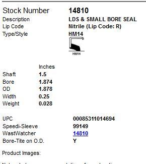

The Tuul Crib 7,347 #5 Posted June 18, 2019 2 hours ago, oliver2-44 said: If you have some wheel bearing grease it will work fine, it's probable close to what it had originally. If I were buying some, I would buy synthetic. The bearing grease does not work hard in this application. The grease is working when the bearing is "idling" with no load. When you engage the clutch and put load on the pulley, the bearing becomes fixed so the grease is not doing any work under a "loaded" condition. You can get a new seal for the PTO bell at napa . Not sure of the part number off hand. 1 Share this post Link to post Share on other sites
squonk 45,597 #6 Posted June 18, 2019 Napa # 14807 Not stocked in many wharehouses. My DC has 1 as does about 8 others. Share this post Link to post Share on other sites
The Tuul Crib 7,347 #7 Posted June 18, 2019 1 hour ago, squonk said: Napa # 14807 Not stocked in many wharehouses. My DC has 1 as does about 8 others. They actually come from the manufacture here in Tennessee three hours from me. Share this post Link to post Share on other sites

josephd2212 2 #9 Posted June 20, 2019 On 6/18/2019 at 10:34 AM, The Tool Crib said: You can get a new seal for the PTO bell at napa . Not sure of the part number off hand. the PTO bell has a seal? Share this post Link to post Share on other sites
The Tuul Crib 7,347 #10 Posted June 20, 2019 30 minutes ago, josephd2212 said: the PTO bell has a seal? Yes and lm trying to find the part number unless someone else does first Share this post Link to post Share on other sites

pfrederi 19,954 #12 Posted June 20, 2019 WH 6663 CR 14810 Share this post Link to post Share on other sites
josephd2212 2 #13 Posted June 21, 2019 I will have to take mine back apart and check to make sure that seal is in good condition. When I removed it, to replace the clutch plate, I did not notice any issues with anything else. I just saw the purple grease on the bearing, inside the pulley. Didn't look like there was much left, and it may have never been greases in its life. I'll probably just put a small glob inside and put it back together. Share this post Link to post Share on other sites
