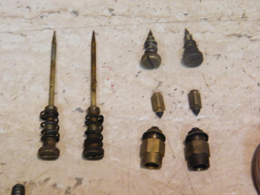

stevasaurus 23,568 #8 Posted June 16, 2019 Pull out your high needle valve from the top of the carb. Notice the small holes in the shaft (needles on the right)...one near the top and another near the pointed end. Take a small wire and some carb clean and poke and clean the holes. Put the valve back in...gently bottom out and back out 2 1/2 turns. start horse and make the fine adjustment. 7 times out of ten, this is the problem. Share this post Link to post Share on other sites
71_Bronco 1,072 #9 Posted July 13, 2019 I apologize for not updating this thread sooner, I didnt realize this was almost a month ago. Anyways, I pulled the high speed needle, and the holes were fine and the needle looked okay, no issues. I put it back into the carb with the 2-1/4 turns out as the manual states I had previously reset the governor arm, so that is all set. I went to start it up today to mow, and it ran perfectly. I didnt have to mess with it at all. No surging issues at all. I think I may have had it too rich, as I had to mess with the needle a lot previously, and it was pretty far out of the carb compared to where it is now. Thanks again for all the help! 1 Share this post Link to post Share on other sites
