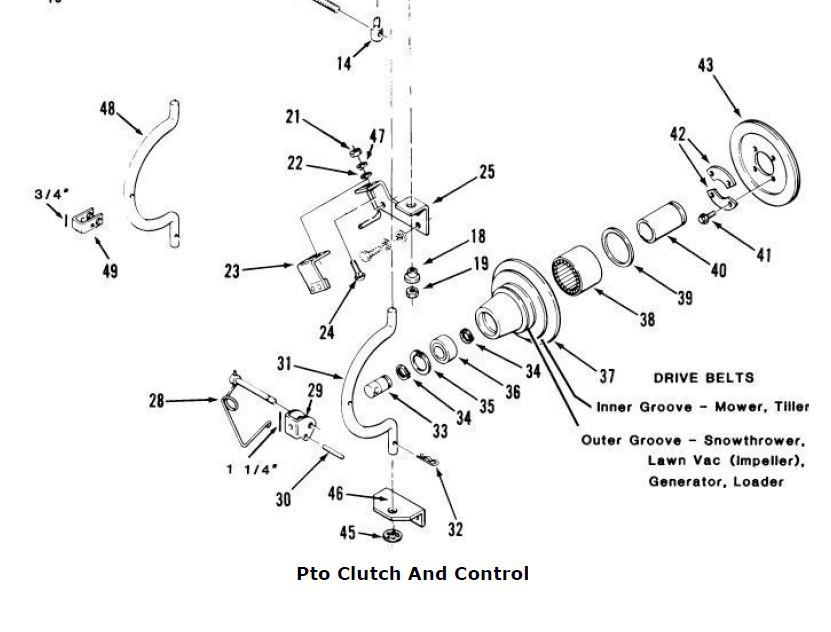

pfrederi 18,969 #6 Posted June 16, 2019 One thing if you remove the isolation mount you will need to get or make a lower mount for the PTO hoop. WH# 102870 Number 46 in picture 1 Share this post Link to post Share on other sites
