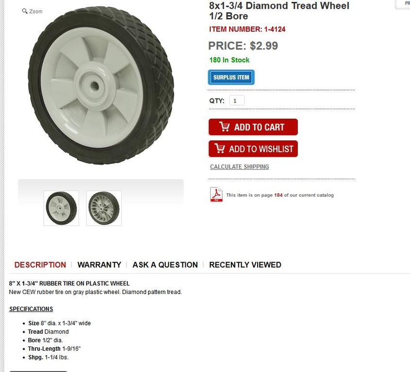

pfrederi 19,278 #3 Posted June 11, 2019 Welcome to Red Square. You could go to larger wheels on the back of the deck. I have used some like this. They will not last forever but are cheap enough to be replaced. you may have to use some washers to shim them. Also make sure you re-level your deck front to rear. 2 Share this post Link to post Share on other sites

Roaddogg 5 #6 Posted June 11, 2019 1 hour ago, pfrederi said: Welcome to Red Square. You could go to larger wheels on the back of the deck. I have used some like this. They will not last forever but are cheap enough to be replaced. you may have to use some washers to shim them. Also make sure you re-level your deck front to rear. I may try the bigger wheels if all else fails. With cutting and rewelding the lever assembly I can get the back wheels to rotate down farther now but it seems like the front mounting bar is binding on the transport lift stops when leveling it but I need to look into it more to see if there's a way around it maybe. 1 Share this post Link to post Share on other sites

tunahead72 2,591 #13 Posted June 24, 2019 On 6/13/2019 at 1:11 PM, Roaddogg said: Yes I'm on the top lever setting so the wheels are all the way down and it's 3" from the concrete floor to the bottom of the blades. I would like it to be a little higher since it seems the yard likes that more. I would like at least 3.5". I think what Eric was suggesting is to raise your deck ALL the way up with the lift lever, so the deck is in the transport position. I mow with mine set that way a lot, but I do hear it can cause excessive wear on the lift assembly. But after 30 plus years, I don't see it yet. I would actually like to try using larger diameter wheels, probably 8" like Paul showed above, just haven't gotten to it yet. 1 Share this post Link to post Share on other sites
