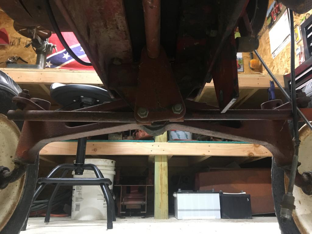

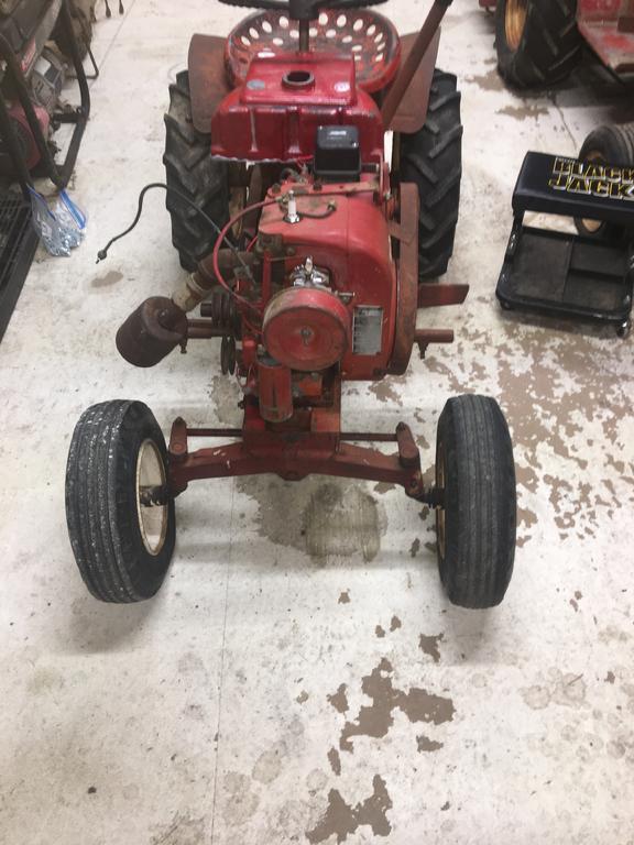

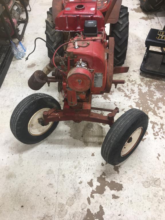

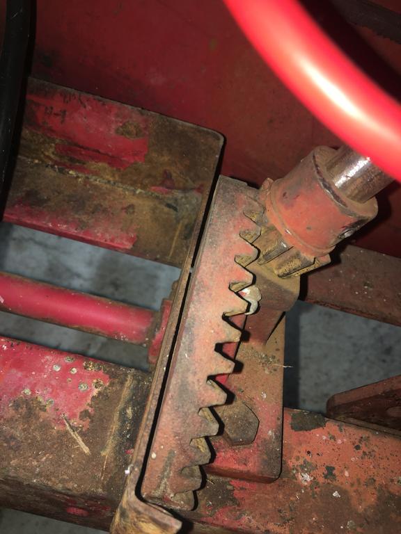

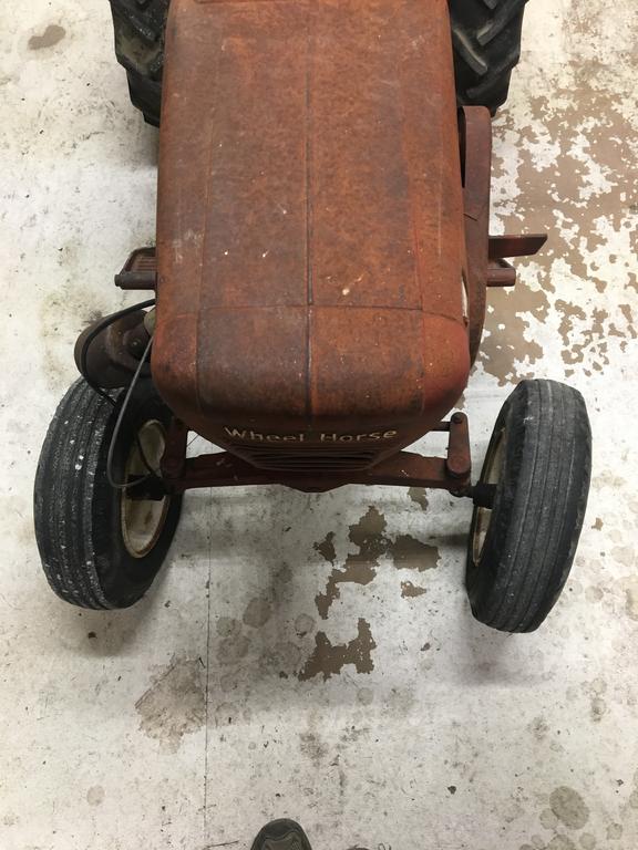

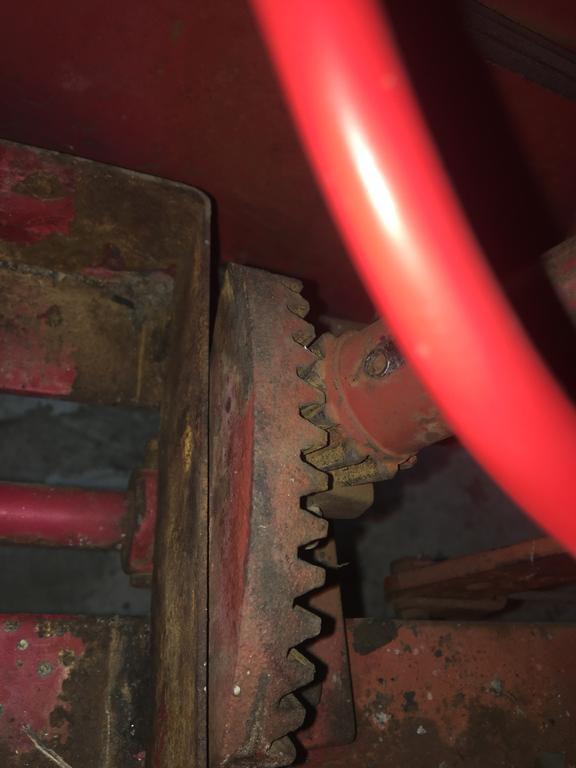

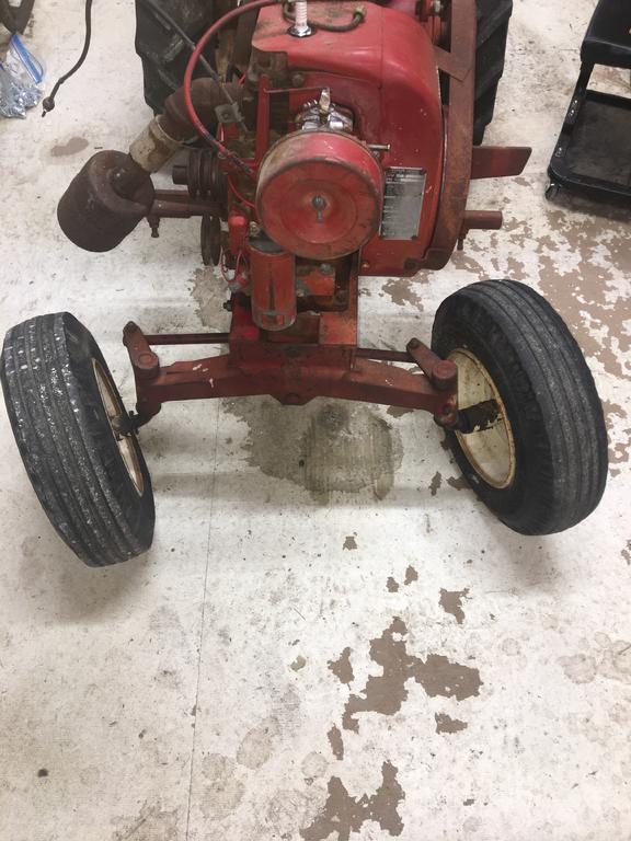

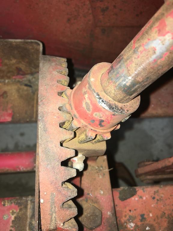

ClassicTractorProfessor 5,455 #1 Posted June 11, 2019 Need help guys...can’t figure this one out. My 753 turns a lot sharper to the right than it does to the left...with the tires straight ahead the gears aren’t lining up straight ahead...nothing I can see is bent and looks like everything is in the correct place Straight ahead All the way to the left All the way to the right Share this post Link to post Share on other sites
formariz 12,354 #2 Posted June 11, 2019 Perhaps its just an optical illusion but on second photo it looks like your tie rods need adjusting? 2 Share this post Link to post Share on other sites
ClassicTractorProfessor 5,455 #3 Posted June 11, 2019 4 minutes ago, formariz said: Perhaps its just an optical illusion but on second photo it looks like your tie rods need adjusting? There’s no adjustment in them...it does look off...a lot of it comes from the fact that the bearings are completely gone...making the wheels sit all funky like Share this post Link to post Share on other sites

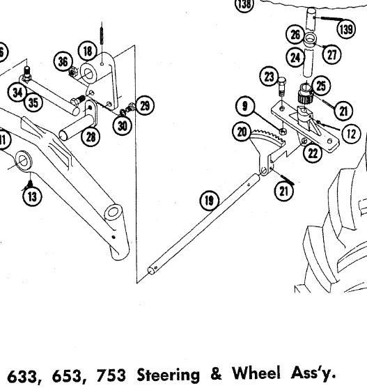

gwest_ca-(File Mod) 12,000 #7 Posted June 11, 2019 Seems to me some of the lower steering shafts were not assembled correctly. When 20 is straight up 18 needs to be straight down. In other words both need be centered at the same time. Garry 1 Share this post Link to post Share on other sites

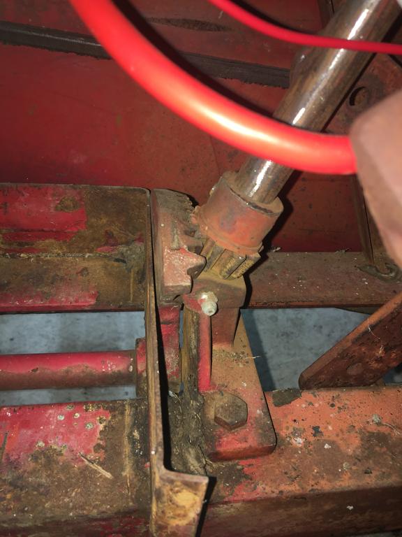

953 nut 64,125 #8 Posted June 11, 2019 You need to take a look at the roll pins on both ends of the horizontal shaft from the fan gear to the steering sector. 1 2 Share this post Link to post Share on other sites
gwest_ca-(File Mod) 12,000 #9 Posted June 11, 2019 The outer tie rod ends are mounted correctly but are the inners? Left and right assemblies are different and different tractor models use them differently - left for right and right for left The inner ends mount on the front of the sector. The 753 uses them like the tie rods shown below the axle in this illustration. Garry 1 Share this post Link to post Share on other sites
wallfish 19,319 #10 Posted June 11, 2019 All go info posted. There are pins holding the steering arms as well. All of those pin locations wear and after a combination of all of them, it will change the steering along with worn tie rods. You can tighten up all of those pin locations by drilling the holes to the next larger size roll pin and install new pins, Adjustable tie rods will give some adjustment too. 2 Share this post Link to post Share on other sites

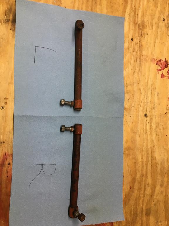

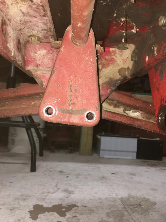

ClassicTractorProfessor 5,455 #12 Posted June 11, 2019 You may be on to something Garry...looking at it from underneath it looks like the tie rods may be in the opposite spot from where they are...think I’ll switch them tonight and see if it helps 1 Share this post Link to post Share on other sites
ClassicTractorProfessor 5,455 #13 Posted June 12, 2019 Can someone clarify the difference between the 1772 and 1773 tie rods...both of mine look identical to each other...both measure 8.75” long I centered the steering sector and crawled underneath to look, the pitman arm (that’s what I would call it???) is straight up and down when the sector is centered, and with everything centered this is how the wheels sit Share this post Link to post Share on other sites
