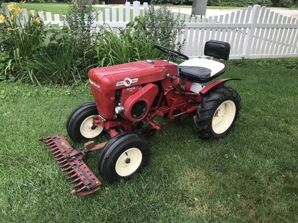

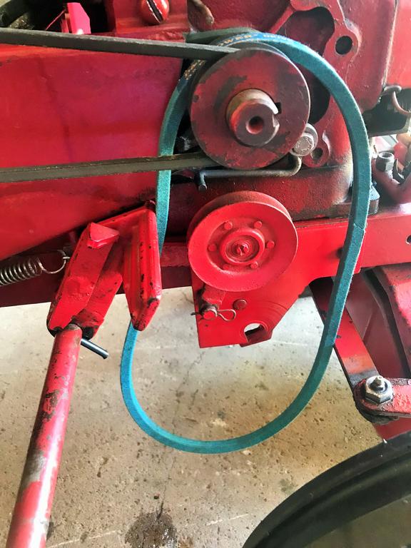

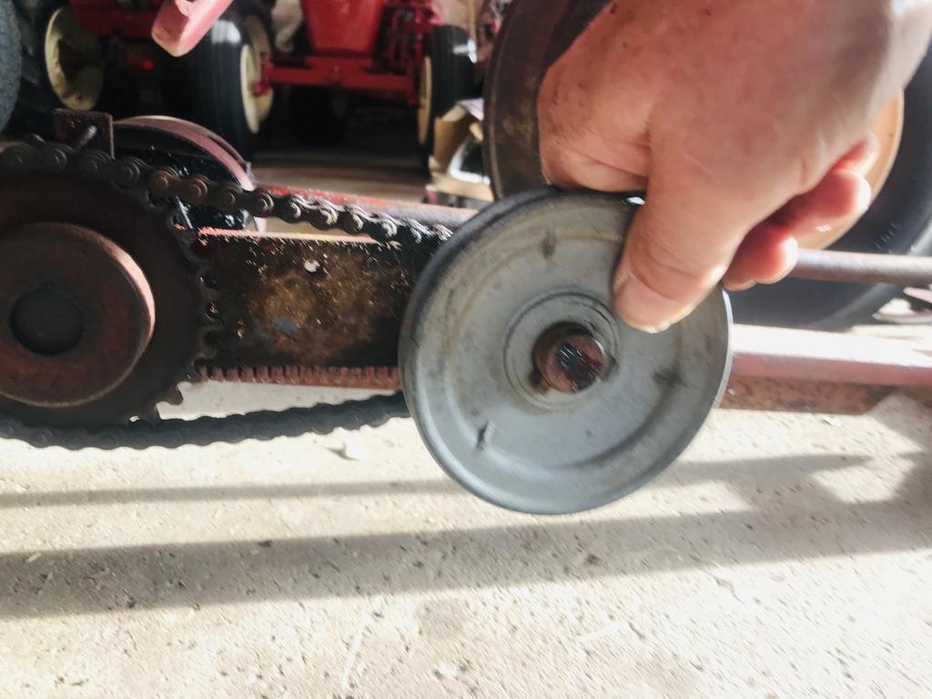

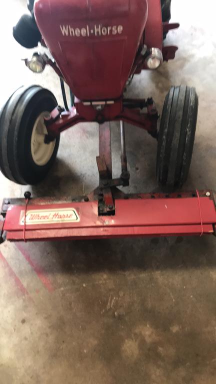

Lane Ranger 11,815 #1 Posted June 11, 2019 (edited) I worked on the 701 Wheel Horse mower clutch today and placed a 38 x 1/2 inch belt on the engine drive pulley to run the CBR- 327 Front Sickle Bar Mower I am bringing to the Big Show in Gettysburg, PA next week and the Garden Tractor Daze Show in Portage, Wisconsin in July. I had sickle bar in another place today and did not get to confirm the belt size needed to drive this rare front sickle bar mower. However, I placed a 38 x 1/2 belt used on the RJ front cutter bar. The 38 however may be too big as the 701 used a smaller pulley than the RJ version. Any Red Square member who has one of these CBR-327 front cutter bars or knows from seeing one what size drive belt needs to be on here , please let me know. When I get the bar on my 701 I will have a better idea for sure -just wanted to shake the trees and see what folks may know about this. I beleive the drive pulley on the CBR-327 is a 4 inch pulley. Edited June 11, 2019 by Lane Ranger 1 Share this post Link to post Share on other sites

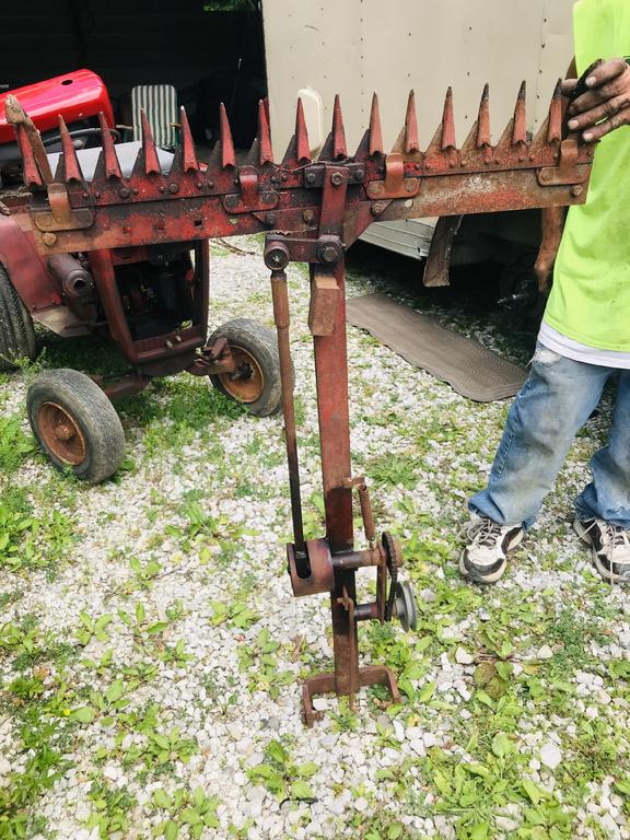

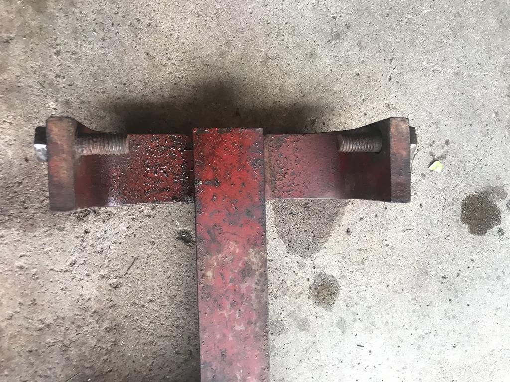

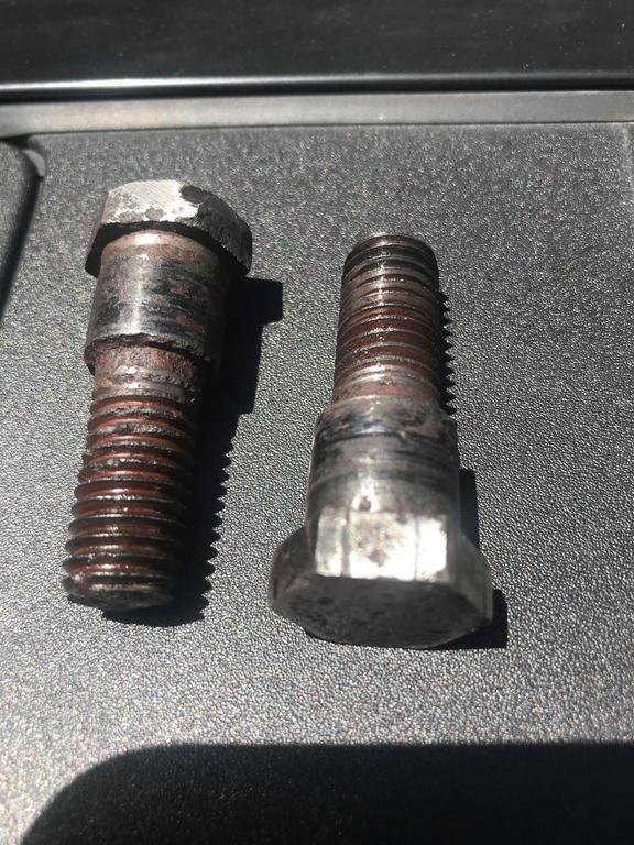

Lane Ranger 11,815 #3 Posted June 11, 2019 the Big Job needing completed today on the CBR-327 Front Sickle Bar Mower -getting the two shoulder bolts removed from the back of the frame for installing on the 701! The rear shoulder bolts were rusted into the cutter bar frame from sitting in Florida weather inside for thirty years! Had to be heated up to get them out! Now I can put this on the tractor and see if I have the correct sized belt to run it! 2 Share this post Link to post Share on other sites

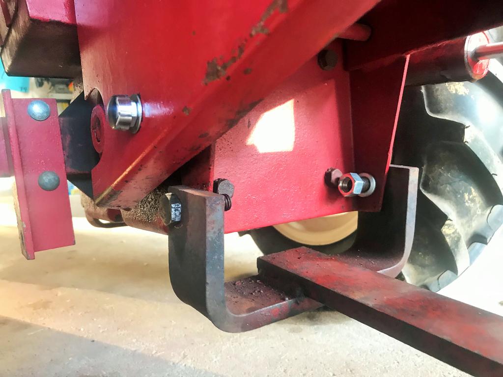

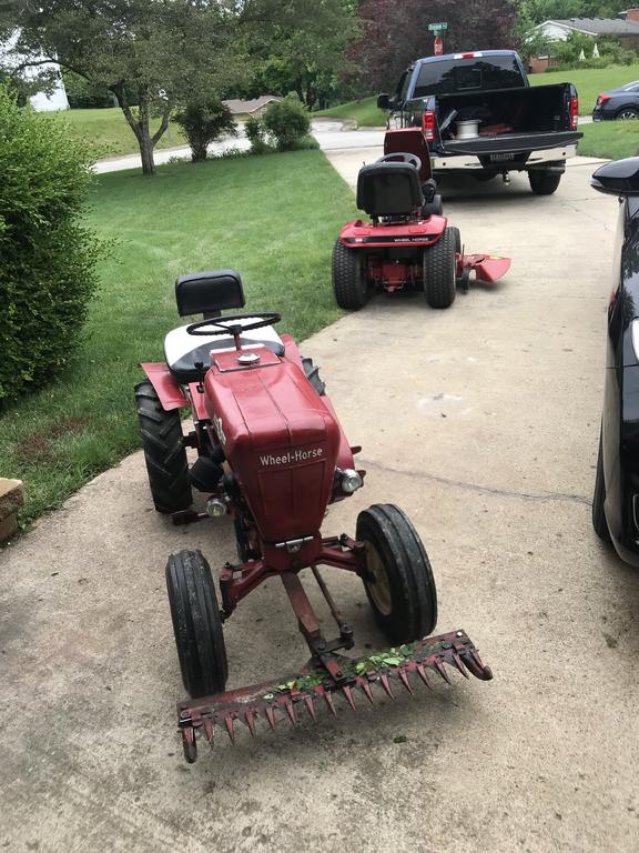

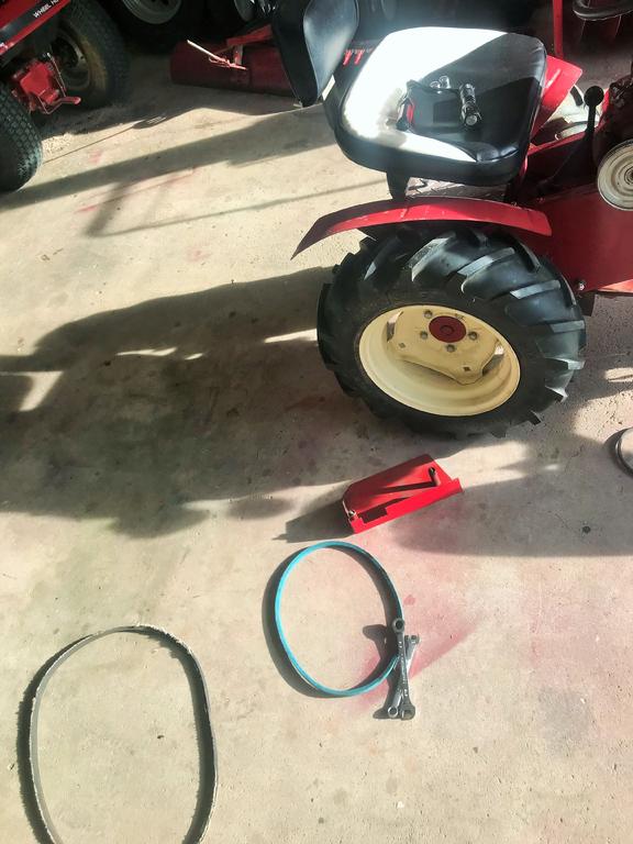

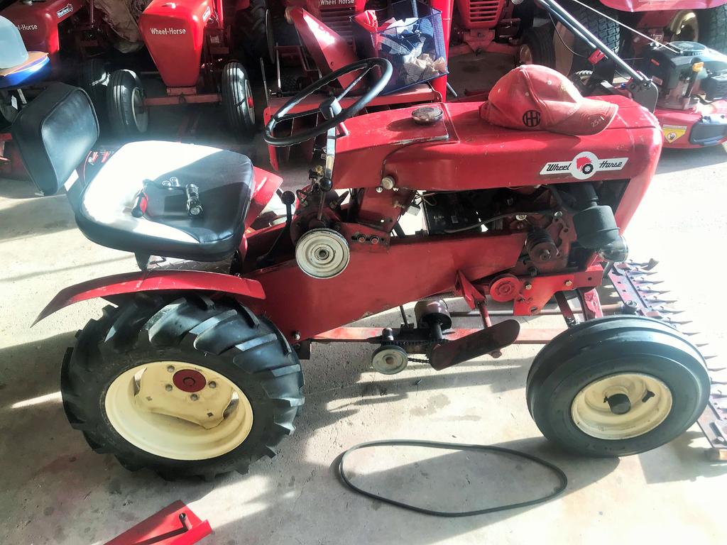

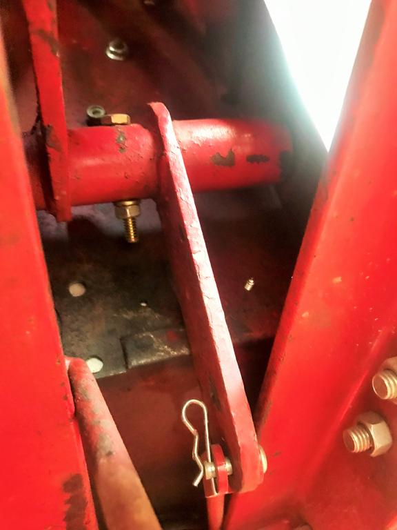

Lane Ranger 11,815 #4 Posted June 12, 2019 Working on belt size thsi am! Got the tractor out and put the CBR-327 Sickle Bar Mower on it! Now looking to get correct belt size. Going to have to go through a process of elimination. Smaller than 59 and bigger than 38 by 1/2! Looks to be in 46 to 50 size range! You have to put nuts on shoulder bolts behind the transmission bolts for clearance then tighten the shoulder bolts! Tight spacing! Lift rod fit perfectly on rockshaft! Now off to find a belt that will work ! 2 Share this post Link to post Share on other sites
WHX?? 55,221 #5 Posted June 12, 2019 Use a piece of rope to get you in the ballpark. then get a couple both sides of what the rope measures. Can always take the wrong ones back. 1 Share this post Link to post Share on other sites
Lane Ranger 11,815 #6 Posted June 12, 2019 Doing that now 51 too short! 18 minutes ago, WHX24 said: Use a piece of rope to get you in the ballpark. then get a couple both sides of what the rope measures. Can always take the wrong ones back. 1 Share this post Link to post Share on other sites

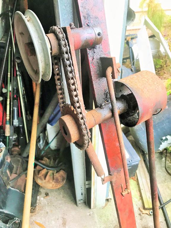

Lane Ranger 11,815 #8 Posted June 14, 2019 May not have my cutter bar operating at show! Going to have to devise a jackshaft operating system running trough attachamatic under the motor! Show will I’ll bring out some ideas from my fellow Wheel Horse nuts! Share this post Link to post Share on other sites

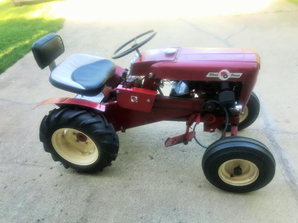

71_Bronco 1,072 #9 Posted June 14, 2019 Very cool attachment. Out of curiosity, with the way it mounts, would it also fit on any of the short-frame, square hood tractors? Or is there something specific about the 701 that makes it only fit that tractor? 1 Share this post Link to post Share on other sites
Lane Ranger 11,815 #10 Posted June 15, 2019 I think it would fit on all the pre-1965 round hoods 71_Bronco! Share this post Link to post Share on other sites

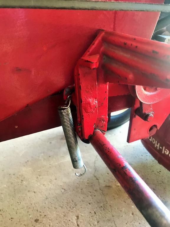

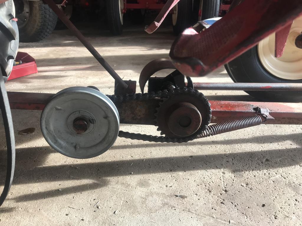

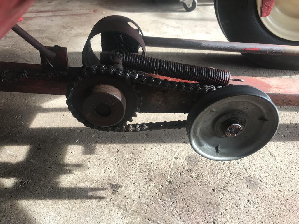

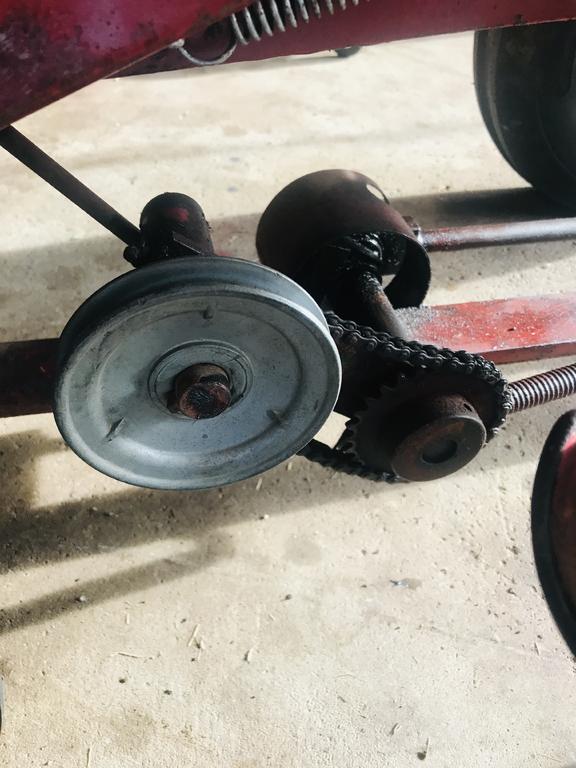

Lane Ranger 11,815 #11 Posted June 17, 2019 (edited) I had an ah ha moment this am on Fathers Day and realized the tension spring in the CBR -327 chain Drive Front Cutter Bar was on incorrectly! The prong was holding the drive pulley on the cutter bar back and when reversed it holds the pulley forward just under the motor! Thus us finding a belt to fit and operate is much easier! So the cutter bar with chain chain drive made for the 701 will be at the Big Show running the weekend! 0B10EA97-C02F-4CB1-9C2F-95AE6AC3AA85.MOV Edited June 18, 2019 by Lane Ranger 2 Share this post Link to post Share on other sites

Lane Ranger 11,815 #16 Posted June 18, 2019 Garry: I used a 35 belt to drive but I think a 37 would be better. My 701 mower deck clutch clutch is not very tight on this tractor. Share this post Link to post Share on other sites
