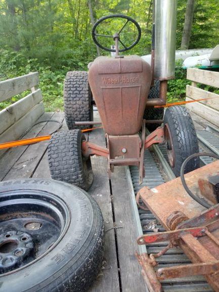

jammankel 24 #1 Posted June 10, 2019 (edited) brought this home the other day i believe its a suburban 400 ive got the original k91 mower deck and blade for it the only things im missing are the belt guards heat shield and throttle plate and foot rest. im planing on doing a full restoration Edited June 10, 2019 by jammankel 8 2 Share this post Link to post Share on other sites
dells68 7,499 #2 Posted June 10, 2019 Ouch! From my perspective, that muffler gives an all new level to the term nut roaster!! 7 Share this post Link to post Share on other sites

953 nut 64,124 #5 Posted June 11, 2019 3 hours ago, dells68 said: Ouch! From my perspective, that muffler gives an all new level to the term nut roaster!! Please tell us the thing pointed at the seat is the air filter and the stove pipe is the exhaust. 2 Share this post Link to post Share on other sites
jammankel 24 #6 Posted June 11, 2019 thats the muffler but ive pulled the motor already its on a self waiting for its own project 1 Share this post Link to post Share on other sites

formariz 12,354 #8 Posted June 11, 2019 (edited) 9 minutes ago, 953 nut said: Please tell us the thing pointed at the seat is the air filter and the stove pipe is the exhaust. If not that would make it the most efficient "ball burner" there is. Edited June 11, 2019 by formariz 3 Share this post Link to post Share on other sites

ZXT 2,401 #11 Posted June 11, 2019 Good looking tractor! Whoever put that engine on there with the muffler the way it is either wasn't much of an engineer, or never ran it! If they did run it, they won't be having kids. Post either in the classified section or the "big show" post, and I'm sure someone will post that they have every piece you need. Even if you can't attend the big show, I'm sure they'll ship to you.. More stuff for sale in that post than I've ever seen. Share this post Link to post Share on other sites

Pullstart 68,883 #13 Posted June 11, 2019 13 hours ago, 953 nut said: Please tell us the thing pointed at the seat is the air filter and the stove pipe is the exhaust. Thanks for pointing that snorkel out, it’s a beast! Share this post Link to post Share on other sites
