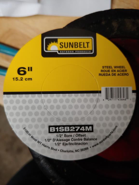

Jmshocker 3 #6 Posted June 11, 2019 i ordered some 6749 wheels but the offset is too wide to fit the studs coming out of the mower. I’m going to have to modify them heavily to make them work. They are 1 11/16” whereas I believe I need 1 1/2” or 1 3/8” Share this post Link to post Share on other sites
Jmshocker 3 #7 Posted June 12, 2019 I found one that fits perfect in every way. Same wheel just in a 6” size and painted white. Found it at the local hardware store for $6 ea. They are almost exact replacements minus the color. They don’t even hit the wheel when I lift the deck. Share this post Link to post Share on other sites
