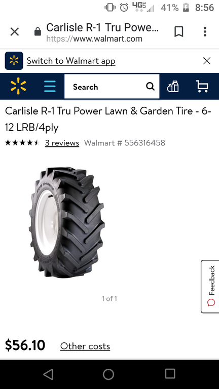

ebinmaine 76,508 #2 Posted June 6, 2019 This is what we used on Trina's 657. 1 Share this post Link to post Share on other sites

oliver2-44 11,137 #4 Posted June 6, 2019 We would enjoy some pictures of your project! I have one original tire off a suburban, and the Carslie 6x12 Tru-Power are very close for an Ag Tread 1 Share this post Link to post Share on other sites
