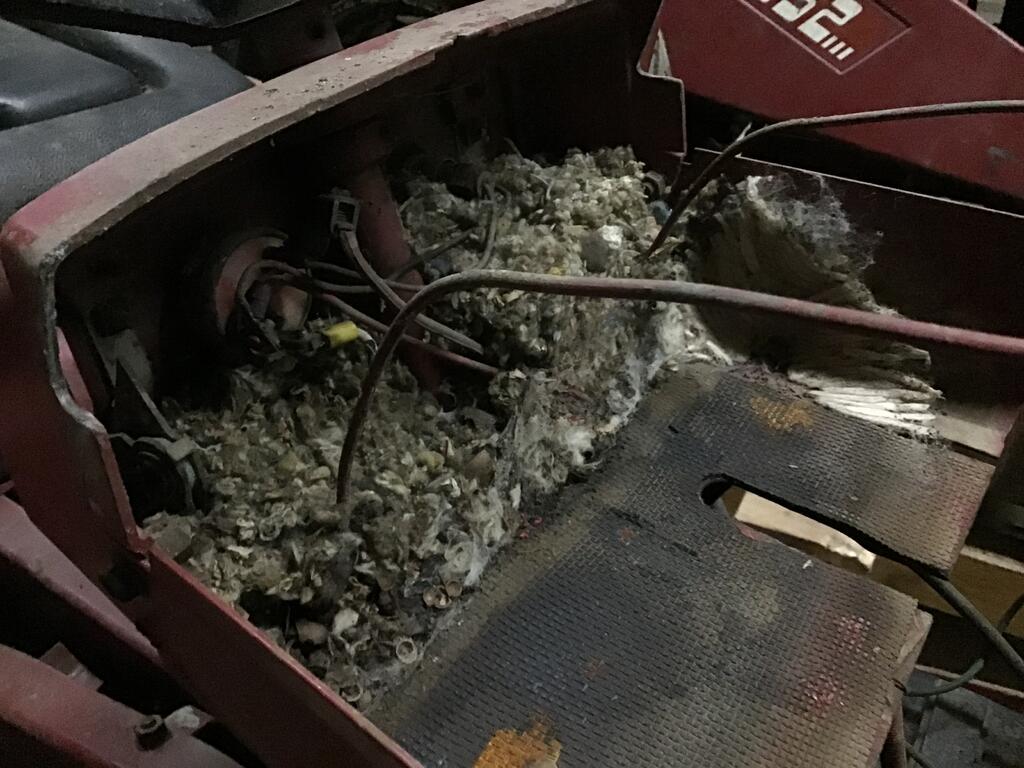

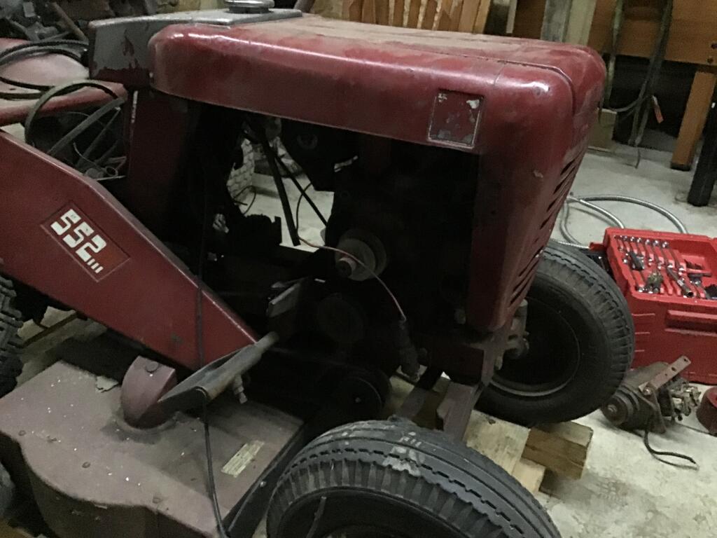

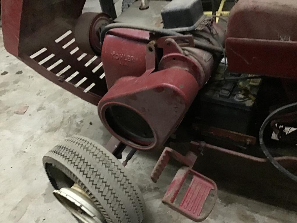

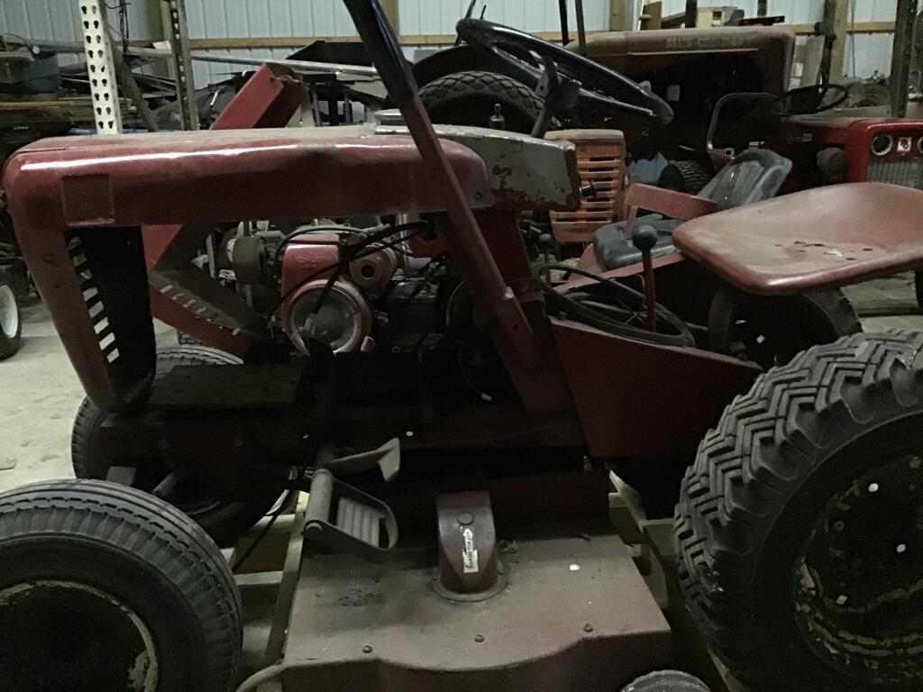

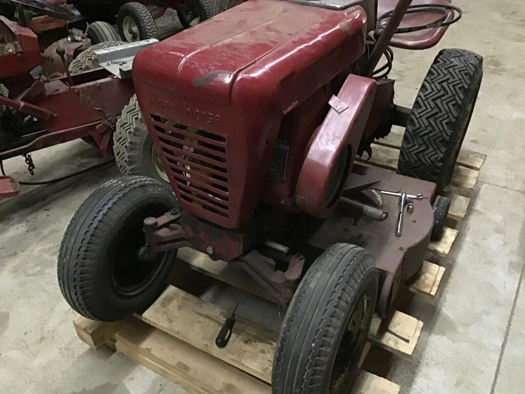

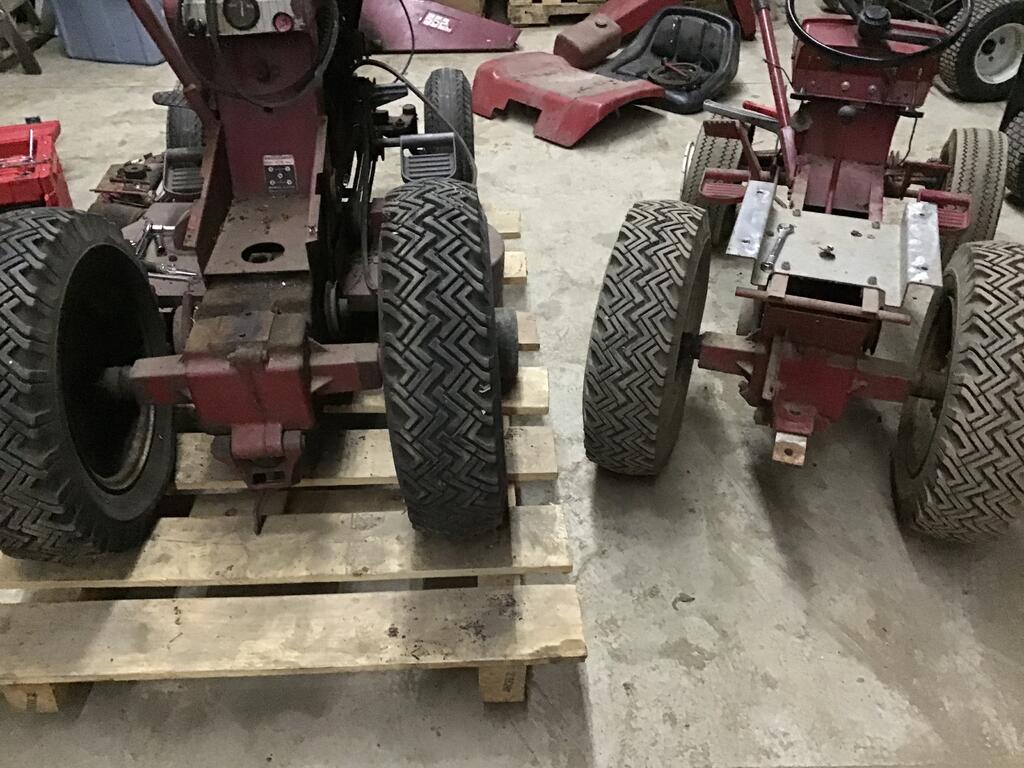

Pullstart 71,367 #28 Posted June 1, 2020 Almost a year this thing has been sitting. Well... I think it will look good with a double wide belt guard sticking out the side of the hood! 4 Share this post Link to post Share on other sites

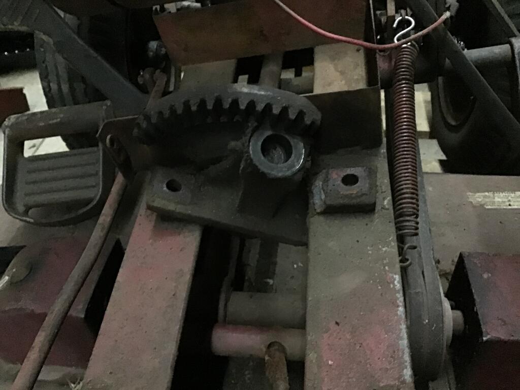

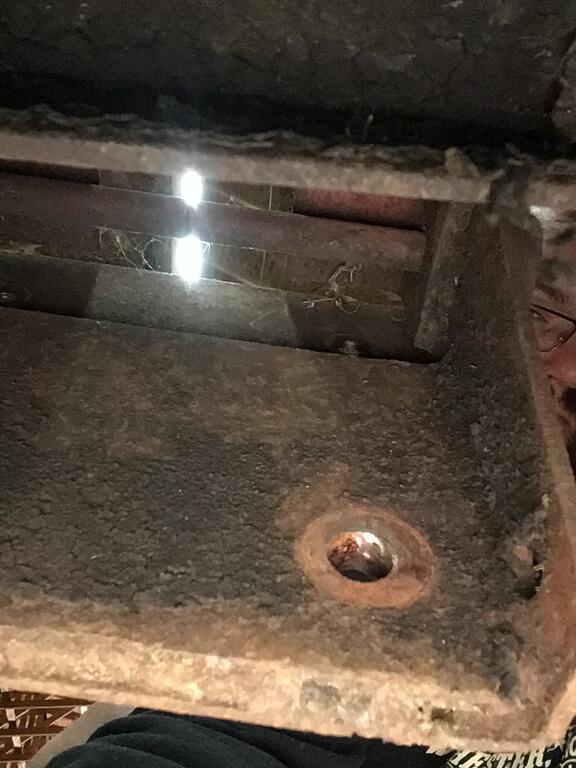

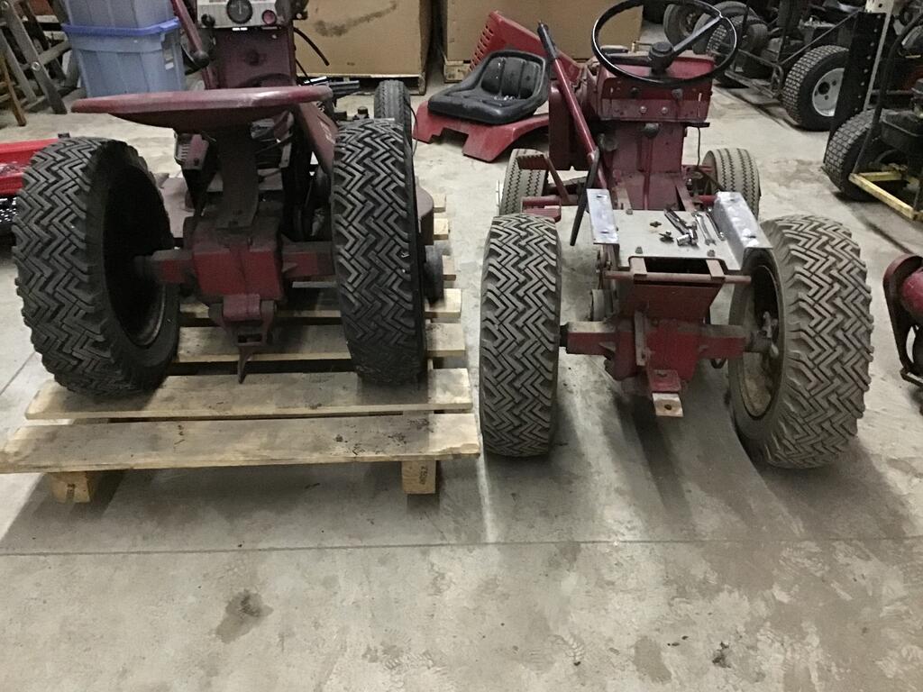

Pullstart 71,367 #29 Posted June 1, 2020 The 552 frame looks good, feels fairly tight! The fan gear support is cracked on one side, I bet I have a spare! 1 Share this post Link to post Share on other sites
Pullstart 71,367 #30 Posted June 1, 2020 Here Tom! Here Jerry! Come out with your hands up! 4 1 Share this post Link to post Share on other sites

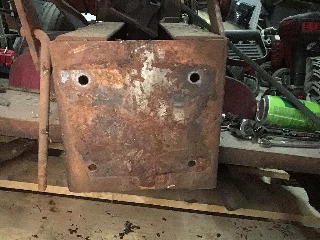

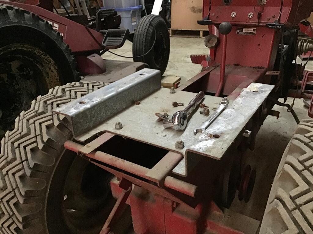

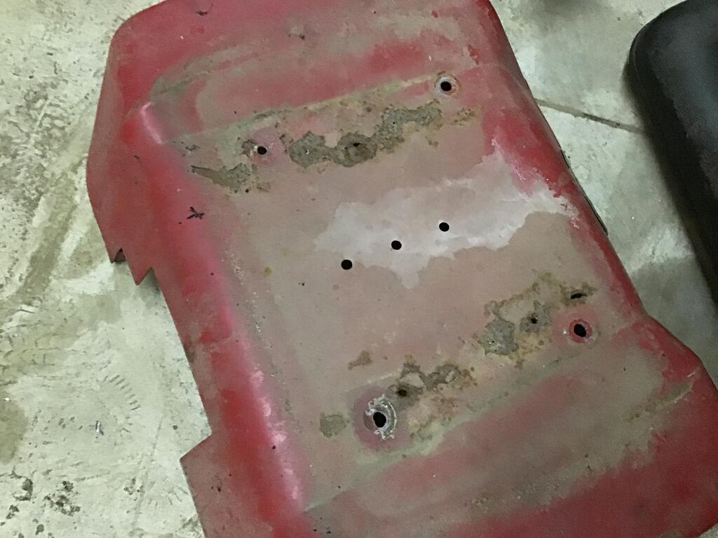

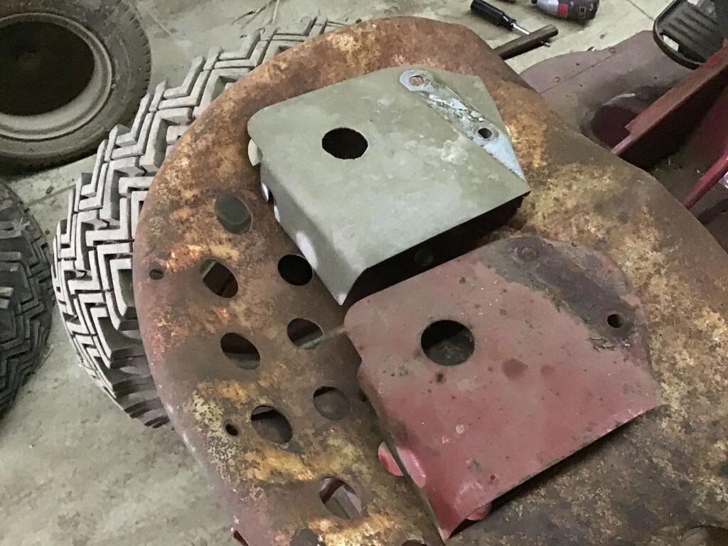

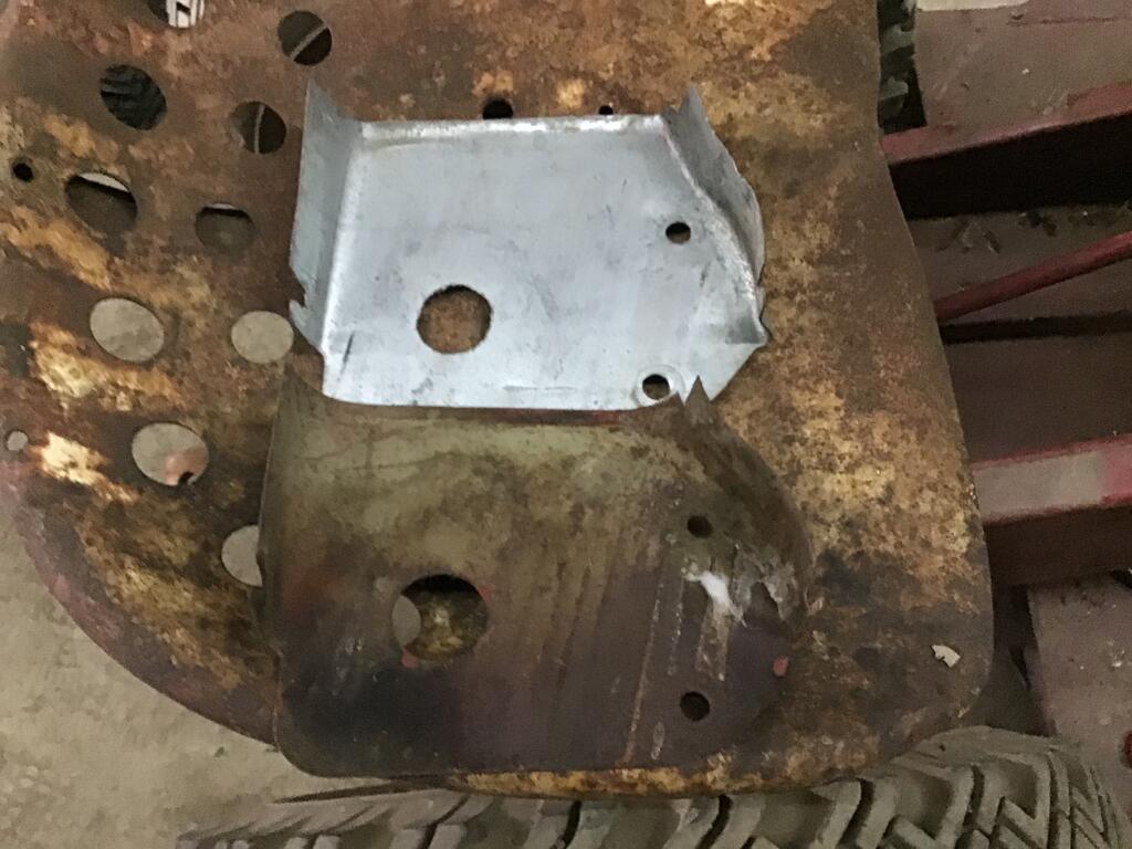

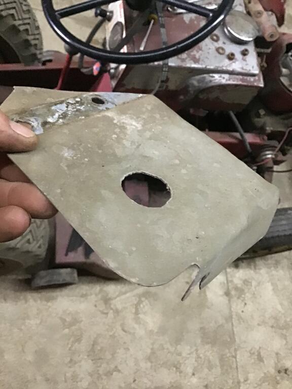

Pullstart 71,367 #33 Posted June 1, 2020 Though I likely won’t reuse this plate on the 1055, someone did a decent job building it! It bolts to the rear tins, then the fender is sandwiched to the seat. 1 1 Share this post Link to post Share on other sites

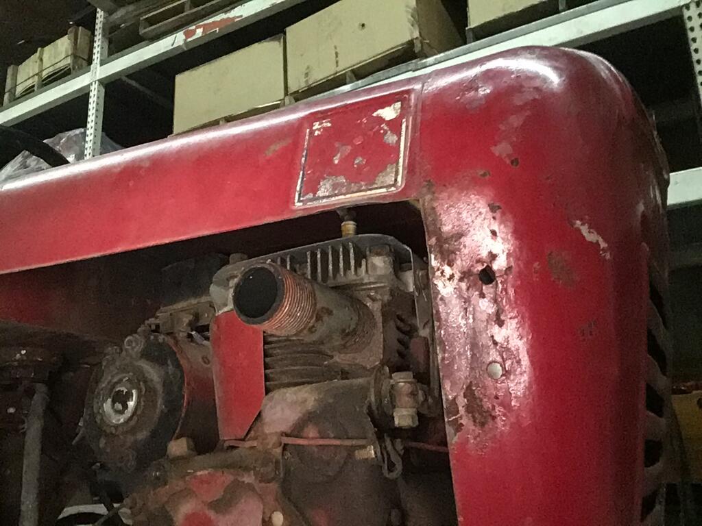

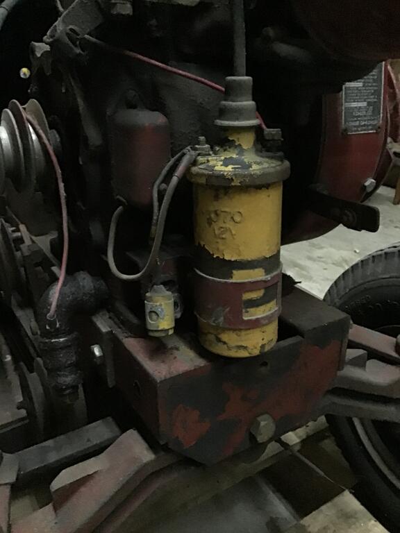

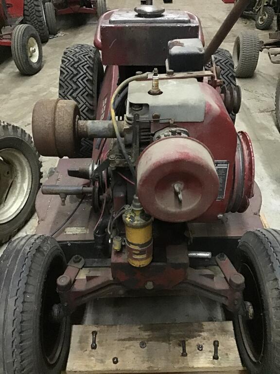

Pullstart 71,367 #35 Posted June 1, 2020 It’s moved over. I see the coil will need to move a bit to clear the hood. Share this post Link to post Share on other sites

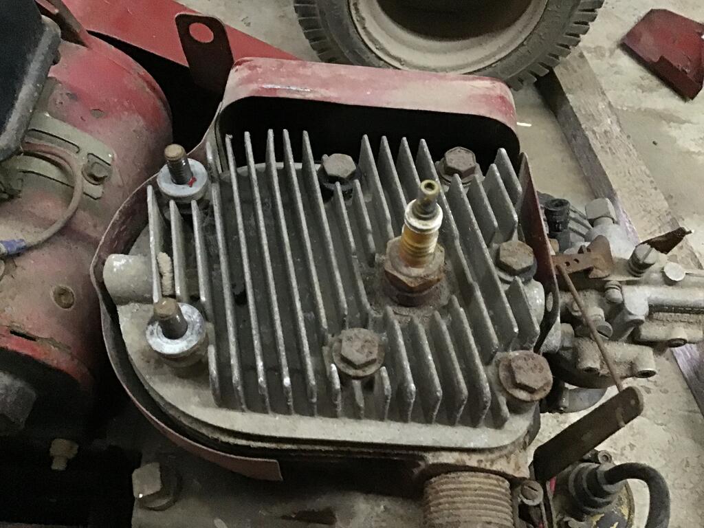

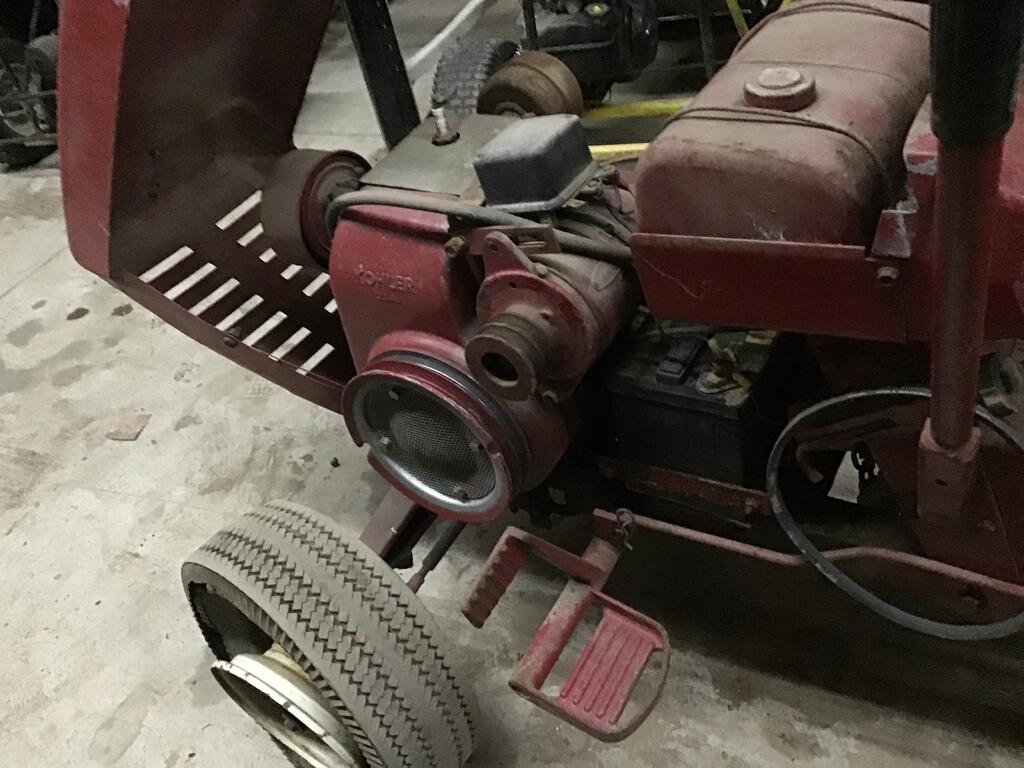

Pullstart 71,367 #36 Posted June 1, 2020 The muffler had to come off to clear the hood. Bummer. I’ll have to give it a stack I guess. The air cleaner is too deep to clear the hood too. 2 1 Share this post Link to post Share on other sites
Pullstart 71,367 #37 Posted June 1, 2020 The belt guard from the 1055 I believe was modified for the K-161. It works best. 2 1 Share this post Link to post Share on other sites

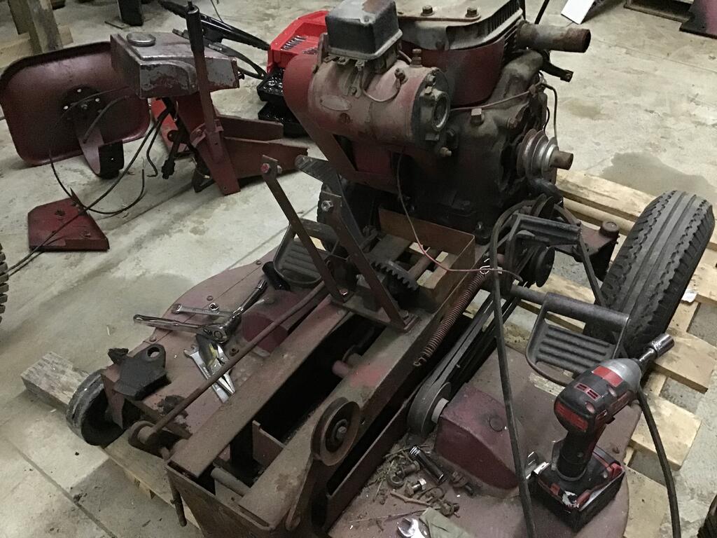

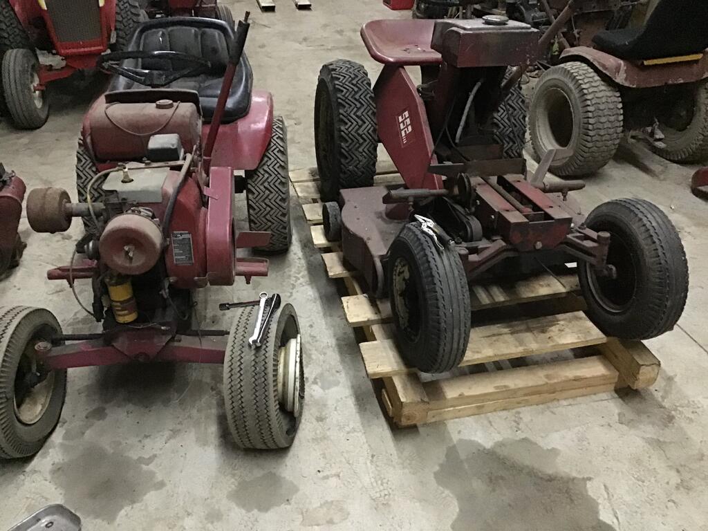

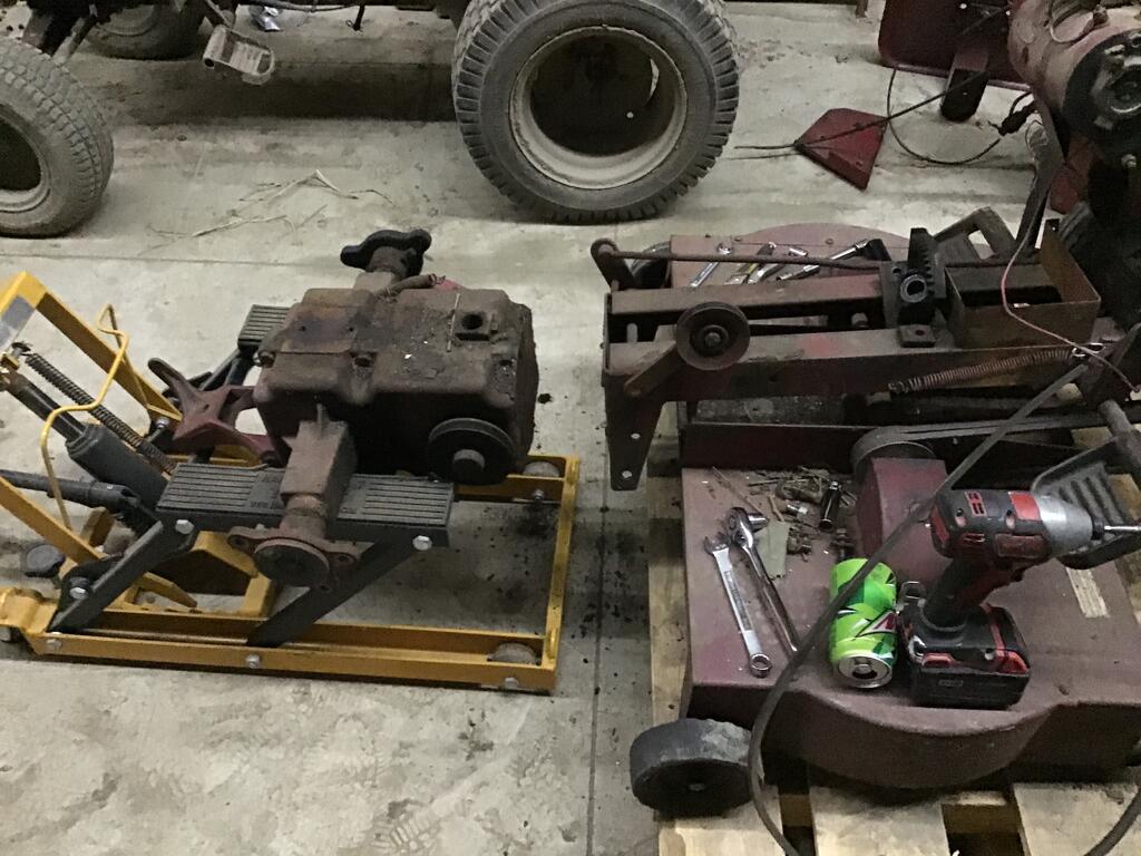

Pullstart 71,367 #38 Posted June 1, 2020 I need to swap transmissions too. The 552 trans is stuck and won’t roll. 1 Share this post Link to post Share on other sites
Pullstart 71,367 #39 Posted June 1, 2020 552 trans is out. Not surprisingly, the frame is cracked but has been plated well from the inside. This’ll be a perfect time to replace the broken steering block too. 5 Share this post Link to post Share on other sites

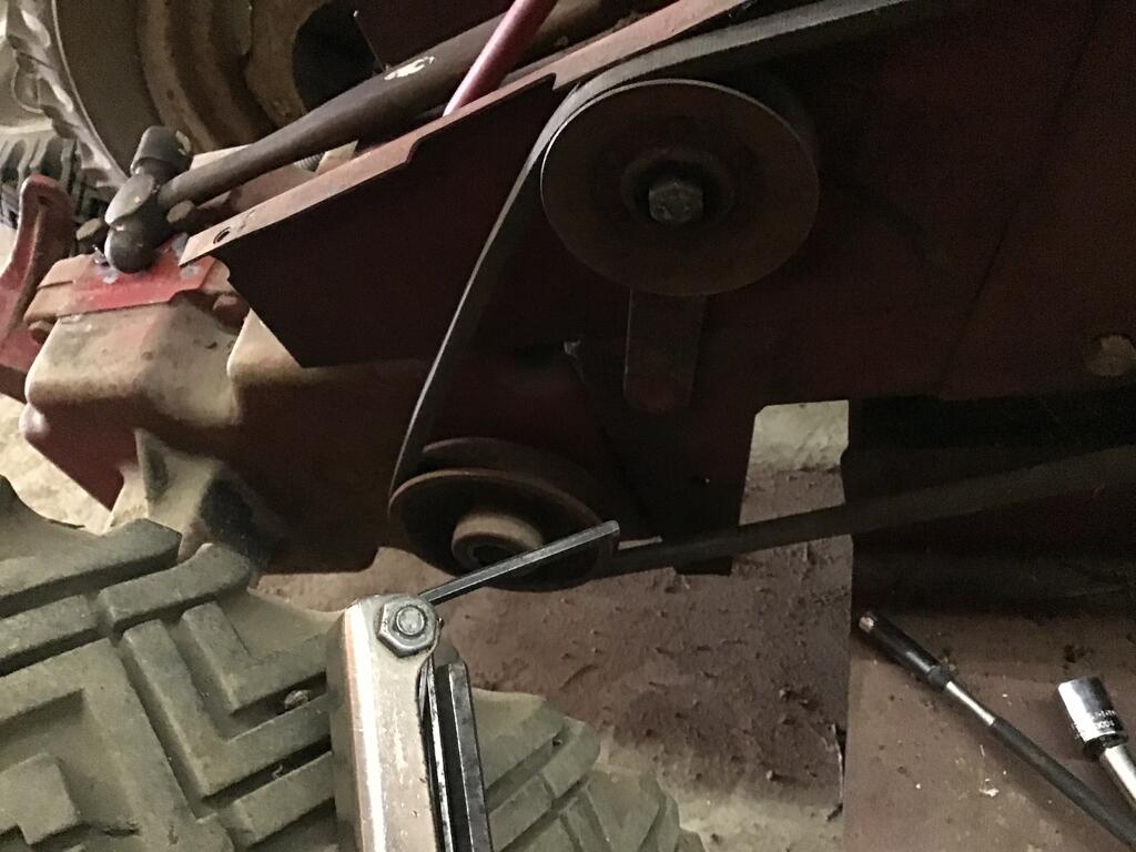

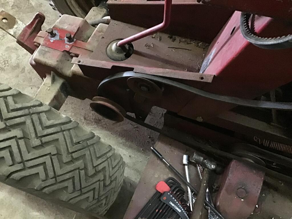

Pullstart 71,367 #44 Posted June 1, 2020 I accidentally put the transmission pulley on backwards. No big deal, but now the set screw I just tightened seems stripped out! 2 Share this post Link to post Share on other sites
Pullstart 71,367 #45 Posted June 1, 2020 I was able to find a hex key just slightly bigger and pound it in. Yay! 2 1 Share this post Link to post Share on other sites

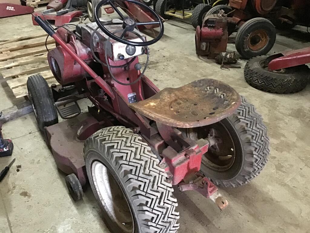

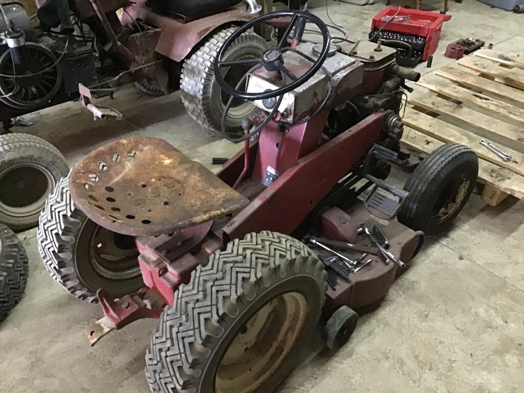

Pullstart 71,367 #46 Posted June 1, 2020 Hubs are snugged up, seat is on along with the belt guard. 4 Share this post Link to post Share on other sites

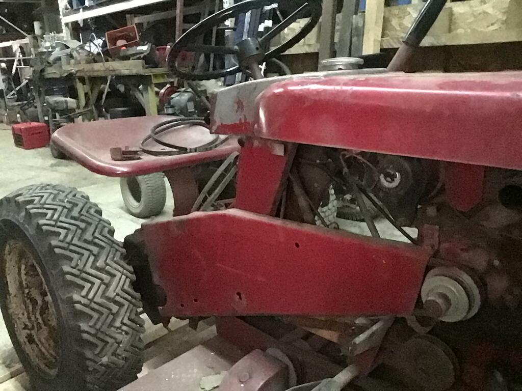

Pullstart 71,367 #47 Posted June 1, 2020 A guy’s gotta kinda hand it to whoever took the time to make this head tin! 4 1 Share this post Link to post Share on other sites
ebinmaine 80,960 #48 Posted June 1, 2020 39 minutes ago, pullstart said: gotta kinda hand it to whoever took the time to make this head tin! Agreed. That's good work. I'd paint it and run it. Share this post Link to post Share on other sites

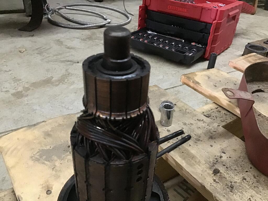

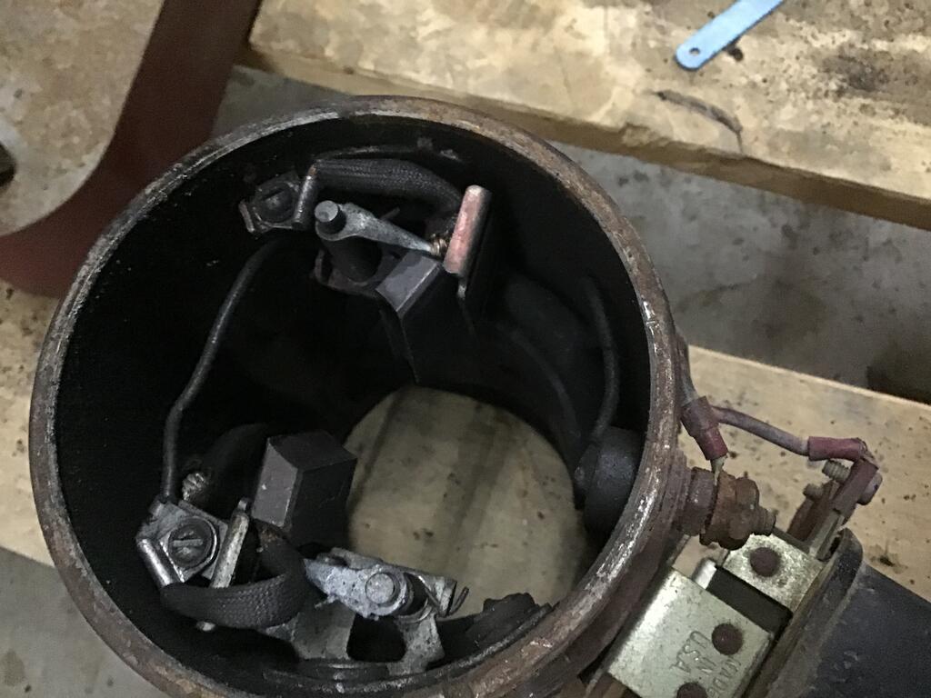

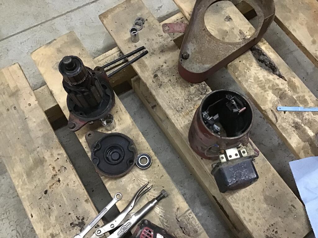

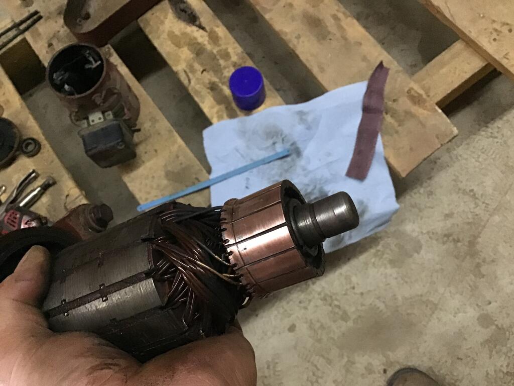

Pullstart 71,367 #49 Posted June 1, 2020 I hooked some juice to the coil and pulled the engine over with a piece of twine wrapped around the pulley. I have spark! The s/g doesn’t spin too fast, so I took it apart for inspection. It looked good and spins well, so I cleaned up the armature and put it back together. Still doesn’t spin too good. 2 Share this post Link to post Share on other sites
