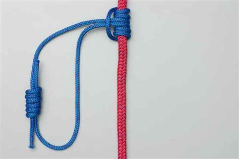

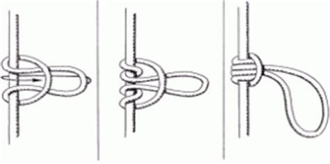

SylvanLakeWH 32,268 #28 Posted July 28, 2022 Gotta reiterate the absolute need for a dead man hanging off the cables on these winch / cable / come along set ups… heavy blanket, chain whatever to weight down and catch / slow the slingshot if it releases or breaks… I’ve used a prusik knot around cable tied to object being pulled. If cable slips / breaks the prusik will drop the cable… Share this post Link to post Share on other sites
c-series don 12,379 #29 Posted July 28, 2022 @SylvanLakeWH Prusik knot? Share this post Link to post Share on other sites
SylvanLakeWH 32,268 #30 Posted July 29, 2022 1 hour ago, c-series don said: @SylvanLakeWH Prusik knot? It’s a slip knot used in mountaineering to ascend rope or stop an unwanted descent. Slides when not under load. When under load it locks tight. 2 1 Share this post Link to post Share on other sites
