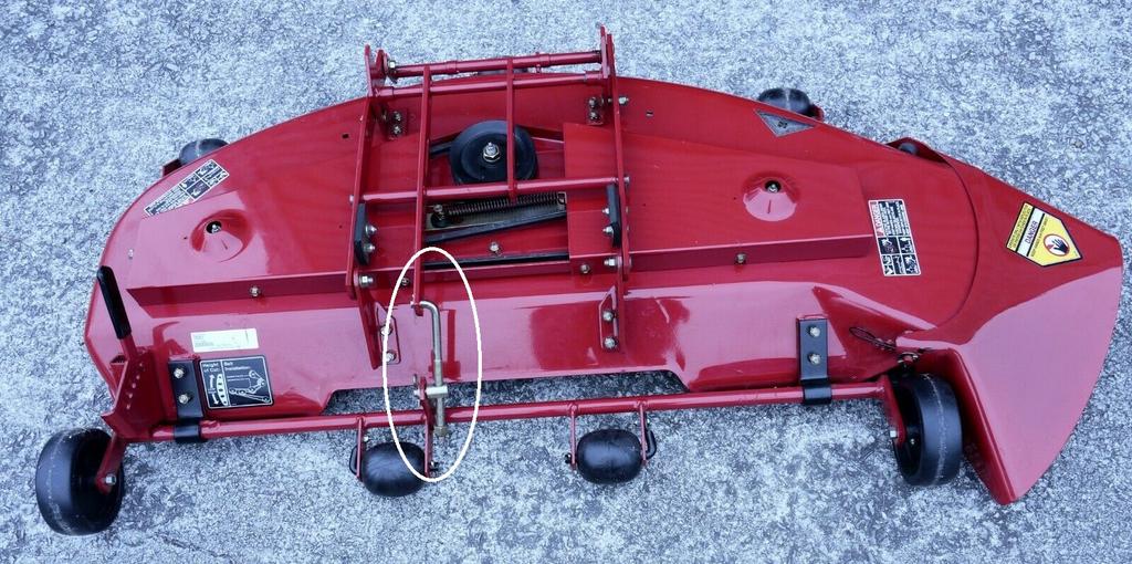

daveoman1966 3,882 #2 Posted May 30, 2019 mISSING THIS LIFT TRUNION??? (white circle) ps..this is a 48" deck, but the lift hdwe is the same. 2 Share this post Link to post Share on other sites
The Tuul Crib 7,347 #3 Posted May 30, 2019 Thats what sounds like to me dave. Share this post Link to post Share on other sites

953 nut 64,320 #7 Posted May 30, 2019 Take a look at Figure 5 of the owner manual, there is a small fork that must be aligned with the cross shaft so the mower will lift at the rear. This is easy to overlook while mounting the deck. 1 Share this post Link to post Share on other sites
JAinVA 4,638 #8 Posted May 30, 2019 A 520H with an electronic lift?Did I miss something? 1 Share this post Link to post Share on other sites
Ed Kennell 45,031 #9 Posted May 30, 2019 The threaded rod on the rear should be adjusted to set the front of the deck 1/8" lower than the rear when the deck is lowered to the mowing height. As Richard stated, the fork must be engaged on the rod of the mid mount. The lift lever should be in the slot. The two shoulder bolts on the front of the carriage can be raised in the slot to cause the rear of the deck to be lifted. I assume he meant hydraulic lift Jim. 1 1 Share this post Link to post Share on other sites
