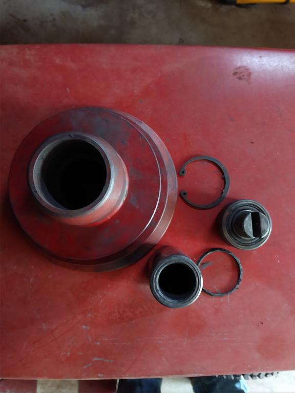

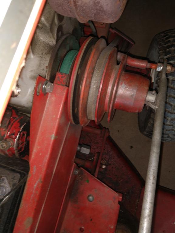

troutbum70 858 #1 Posted May 28, 2019 Not sure what allowed the pto hub to move out so far from friction disc and it will no longer engage. Included are a couple pictures. Top picture is the pto disassembled. Also found a lot of fine black residue the roller bearing in the hub has a lot of it packed around it. Share this post Link to post Share on other sites
Lee1977 7,553 #2 Posted May 28, 2019 It looks to me that the pulley and clutch disk have moved back too far. May just be the picture but it looks like the clutch disk is rubbing the belt guard. Share this post Link to post Share on other sites

troutbum70 858 #4 Posted May 28, 2019 Yes you are correct Lee1977 the disc is rubbing the very bottom of the belt guard and I did not see it, thank you for your observation. And yes gwest it is no longer a cast iron block it was replaced by one of the previous owners. I am not sure what the life expectancy is of the aluminum block is, but I don't really run it a lot so it will last me a while, according to the tag it is still a k181. Share this post Link to post Share on other sites
