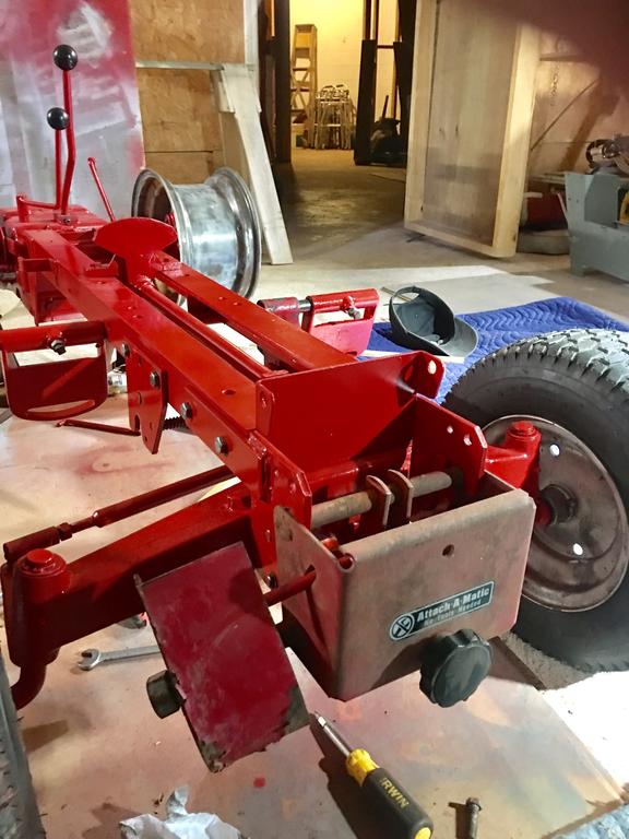

71_Bronco 1,072 #1 Posted May 28, 2019 What kind of options do I have for my 1968 Commando 8 as far as a mower deck? I'd like to stay at least 36" wide. Right now, I have a 5-2362, which is a gear-drive, 36" deck. The spindles, brackets, etc are all good, but the shell needs some help. With this tractor, am I limited as far as deck options? Would it be possible to convert this to an attach-o-matic style deck? Or would that not work well due to the short frame? I'd rather keep it with the gear-drive deck, as I think it's very cool and correct to the tractor, but parts and decks are not as common as the later style. Share this post Link to post Share on other sites
Ed Kennell 45,030 #2 Posted May 28, 2019 I'm afraid you are stuck with the gear drive decks. If you did find a 3 blade deck that would fit between the wheels, you would need a front mount attach-a-matic, a mule drive, and a working PTO. Share this post Link to post Share on other sites
The Tuul Crib 7,347 #3 Posted May 29, 2019 (edited) I have a 1067 that has a bracket on it that allowed me to use a newer deck. The only problem that l ran into was the muffler being in the way . Im not sure where to find these but a good welder can probably fab you a set if you have a long frame. Edited May 29, 2019 by The Tool Crib Share this post Link to post Share on other sites
71_Bronco 1,072 #4 Posted May 29, 2019 I have a bolt on attach-a-matic that came with my 71 Bronco (pre attach-a-matic), so fabricating a second set wouldn't be very hard. Plus, i have seen them for sale a few times. I have both the front mount, as well as the mid-frame set. The problem I have is that the Commando 8 is a short frame, and I don't know how a newer style deck will fit. On the Bronco 14, that has a long frame, so you have more room for a mid-mount deck. Share this post Link to post Share on other sites
