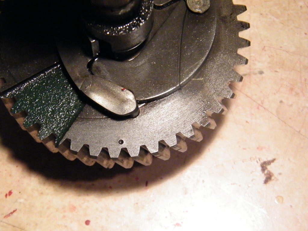

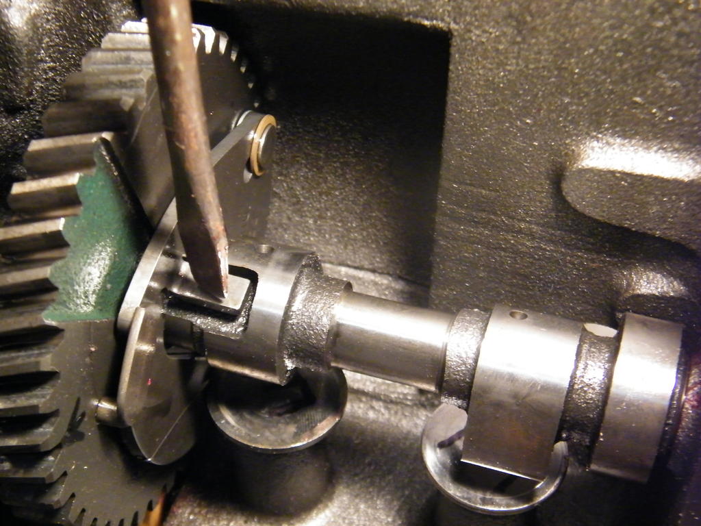

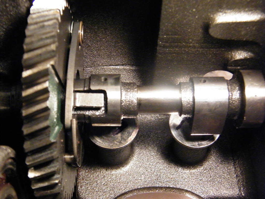

stevasaurus 23,568 #2 Posted May 27, 2019 I don't know if you can get a good reading on the "K" series Kohlers. They have a gift called ACR or Automatic compression release. It keeps the exhaust valve open slightly while cranking the engine or when pulling the rope. Makes cranking or pulling easier. Once the engine is going the ACR lets the valve close all the way. Here are a few pictures of the mechanism on the cam shaft. This is "K" 181. The screwdriver is resting on what would hold the valve partieally open. Share this post Link to post Share on other sites
