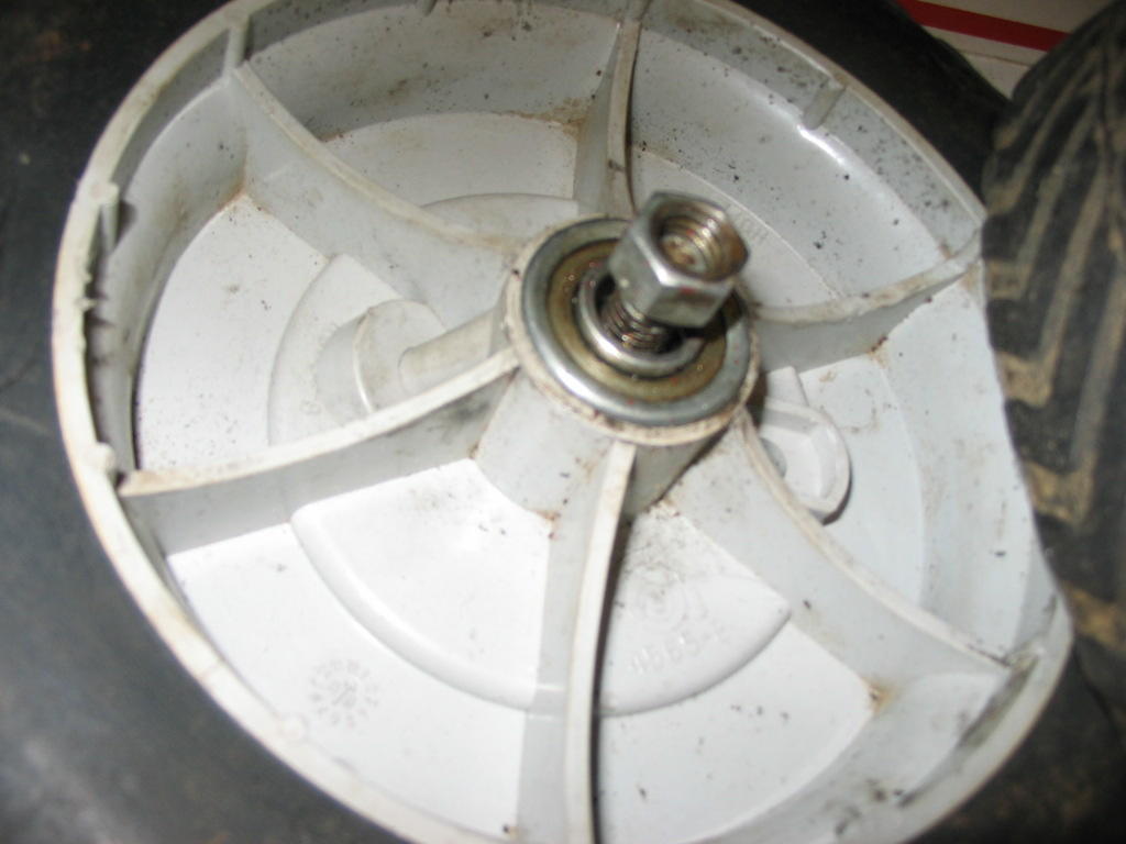

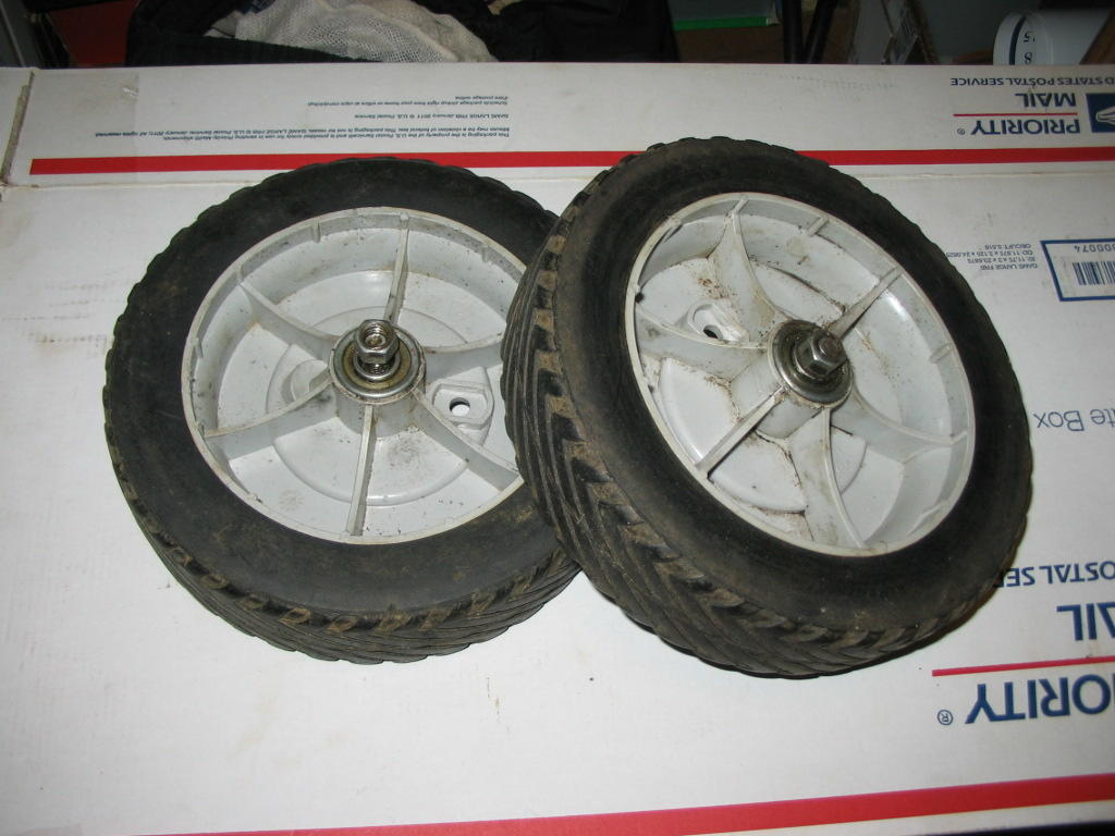

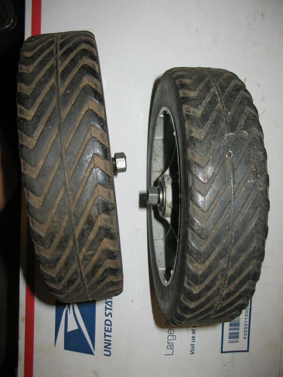

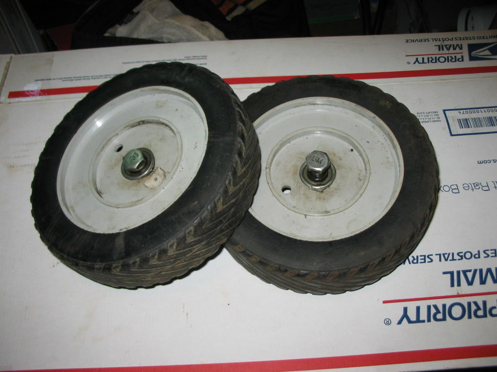

daveoman1966 3,882 #3 Posted May 27, 2019 Standard wheel are 6" diameter. I have a pair that are 8" dia, which would raise the rear of the deck by 1". That MAY solve your problem. These wheels come with shoulder bolt and TWO replaceable ball bearings in each one.. $22 plus 8 to ship to you in USA. 1 Share this post Link to post Share on other sites

oliver2-44 11,272 #7 Posted May 28, 2019 My 312-8 has a 42" SD deck and I use 7" tires on the rear of the deck. it give me another 1/2" height adjustment. 2 Share this post Link to post Share on other sites
