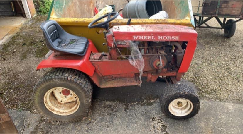

norton41 5 #1 Posted May 26, 2019 Hi guys. I am in UK and looking for a mower deck for my charger 12, which I have managed to get running with advice from this forum....thanks! Can anyone advise whether one that has been fitted to a 227-5 would fit? This is the ebay item i am looking at: https://www.ebay.co.uk/itm/wheelhorse-mower-deck/113757241611 Cheers! Share this post Link to post Share on other sites
Ed Kennell 43,156 #2 Posted May 27, 2019 (edited) The decks from the vertical engine tractors are not designed to fit a horizontal engine like your Charger. It would require the installation of a deck carriage support and possible modifications to the drive spindle pulley. Also, I cannot tell if the rear discharge deck is the correct rotation for your Charger. Edited May 27, 2019 by Ed Kennell Share this post Link to post Share on other sites
