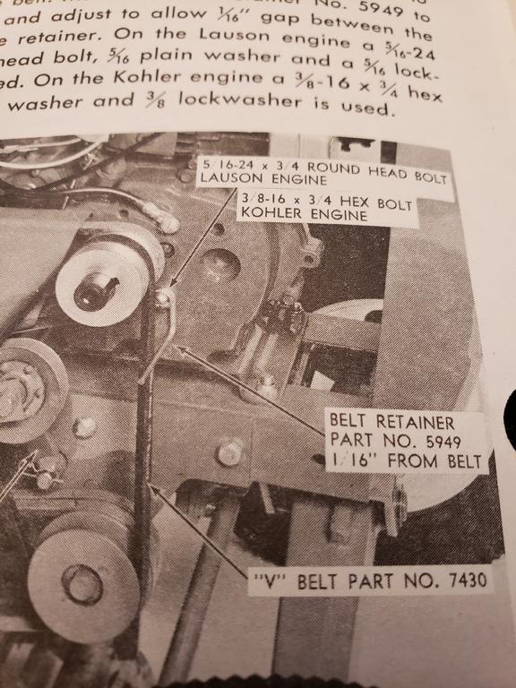

71_Bronco 1,072 #1 Posted May 23, 2019 (edited) Was wondering if anybody has one of these parts that I can get some measurements off. It's a piece of bent round rod that bolts to the motor block, and it helps retain the belt on my Commando 8. Cant seem to find any of these anywhere. Thanks! Edited May 23, 2019 by 71_Bronco Share this post Link to post Share on other sites

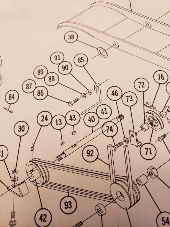

71_Bronco 1,072 #5 Posted May 23, 2019 It is part number 85 in this diagram. Share this post Link to post Share on other sites

71_Bronco 1,072 #7 Posted May 24, 2019 I bought an original wheel horse manual for my 5-2362 rotary mower deck, and in the setup instructions, it talks about this piece. When I tried to look for it, I obviously came up dry, but thought someone may have one on a tractor they had. Share this post Link to post Share on other sites
J854D 139 #8 Posted May 24, 2019 The one on my 854 has been broken for a while. I would like to replace it sometime. It is a little different than the 5949 in the illustration though. It has a small flat plate with holes to bolt it to the engine. The round rod was welded to the plate. That’s where mine broke off. Perhaps mine is an earlier version of the 5949, but I see no reason why the style in the illustration wouldn’t work on my 854. -JD- Share this post Link to post Share on other sites

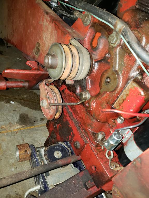

71_Bronco 1,072 #9 Posted May 25, 2019 Well, I'm a complete idiot. I never really looked hard at my motor, and when i did, it was in my dimly lit garage. Just took a better look at it, and realized the retainer was there all along. I'll get some dimensions for you if you still want them. Share this post Link to post Share on other sites
J854D 139 #10 Posted May 25, 2019 Yes on the dimensions, Thanks! No hurry, my 854 is still a work in progress. That is a good picture of the retainer! -JD- Share this post Link to post Share on other sites
jebbear 386 #11 Posted September 30, 2019 I just happened to stumble on to this old thread concerning the Part #5949 Belt Retainer. I am also in need of one of these as mine is completely missing from my 856 with an RM-366 mower deck. Does anyone know of a source for one of these? If not, I can probably fabricate one but not sure of the dimensions or rod diameter and whether or not is made out of any type of hardened steel or just any type of mild steel rod. On 5/24/2019 at 8:18 PM, 71_Bronco said: I'll get some dimensions for you if you still want them. 71_Bronco, that is an excellent pic of exactly what I am in need of. Could I possibly ask a favor and get the dimensions from you so that I can make one assuming that I can not come up with an original anywhere. If anyone knows of a source or has any info, Thanks in advance! Share this post Link to post Share on other sites
