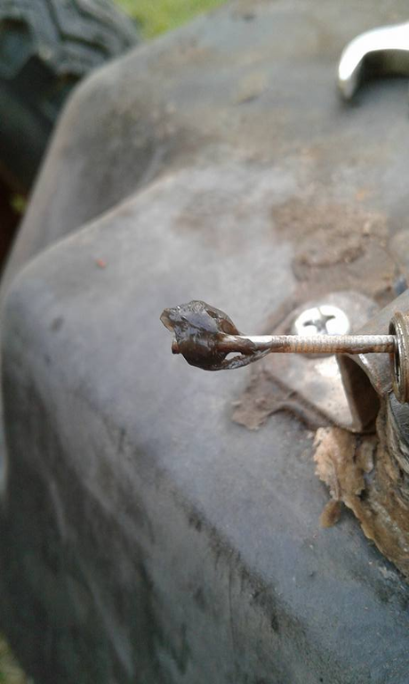

ClassicTractorProfessor 5,434 #10 Posted May 21, 2019 Had a similar problem with my C125 a couple summers ago, took the line coming from the tank off at the pump, little to no gas flow. Blow into it until I heard the gas gurgling in the tank, reattach the line and it would run for a few minutes. Ended up taking the tank off, emptying it, and running a torch tip cleaner up into the shutoff valve and pulled out this nasty booger. Previous owner worked at the grocery store here, and bought all his gas there, which is a 10% ethanol blend. Gave the fuel system a good cleaning and she's been running like a top ever since. 2 Share this post Link to post Share on other sites
