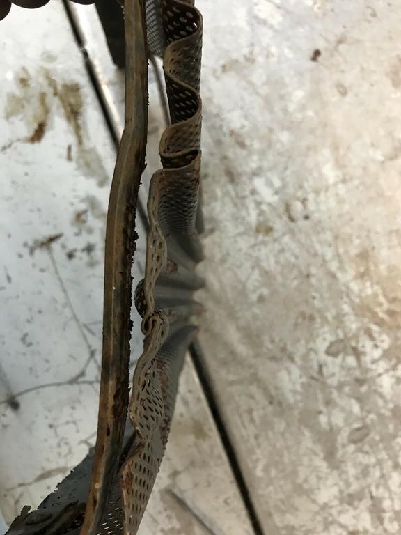

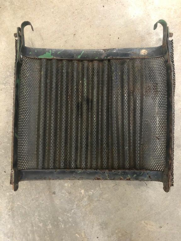

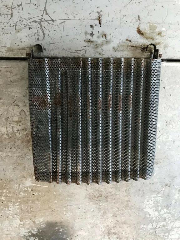

Mudrig150 385 #27 Posted October 1, 2019 (edited) 5 minutes ago, ebinmaine said: Gotcha. If it's a good price on a rare item then maybe you can wait a few weeks to get the ATF. From what I can tell, ATF is about 5$-7$ a quart. I need about 3 quarts. Either way, I'll have enough for the ATF, I think. The grille looks like it's a 68, it looks like its been painted black and the black is flaking off. The bentness and the rust it has fits Larry perfectly. Don't seem like the locking tabs are broke or anything, the whole thing's just bent. Edited October 1, 2019 by Mudrig150 1 Share this post Link to post Share on other sites
Mudrig150 385 #28 Posted October 1, 2019 You know what, I'm gonna do it. It's not everyday you find the perfect part to fit the patina of your machine, especially when the machine is as beat as Larry. And if I can get him down to 15$, even better. 1 1 Share this post Link to post Share on other sites

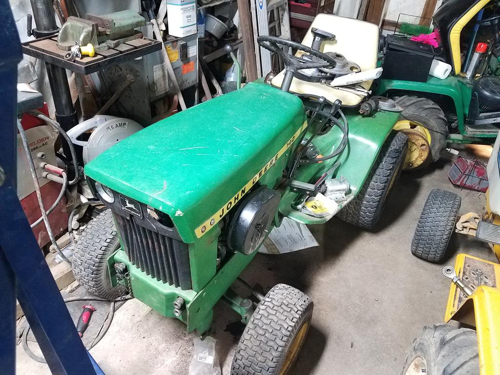

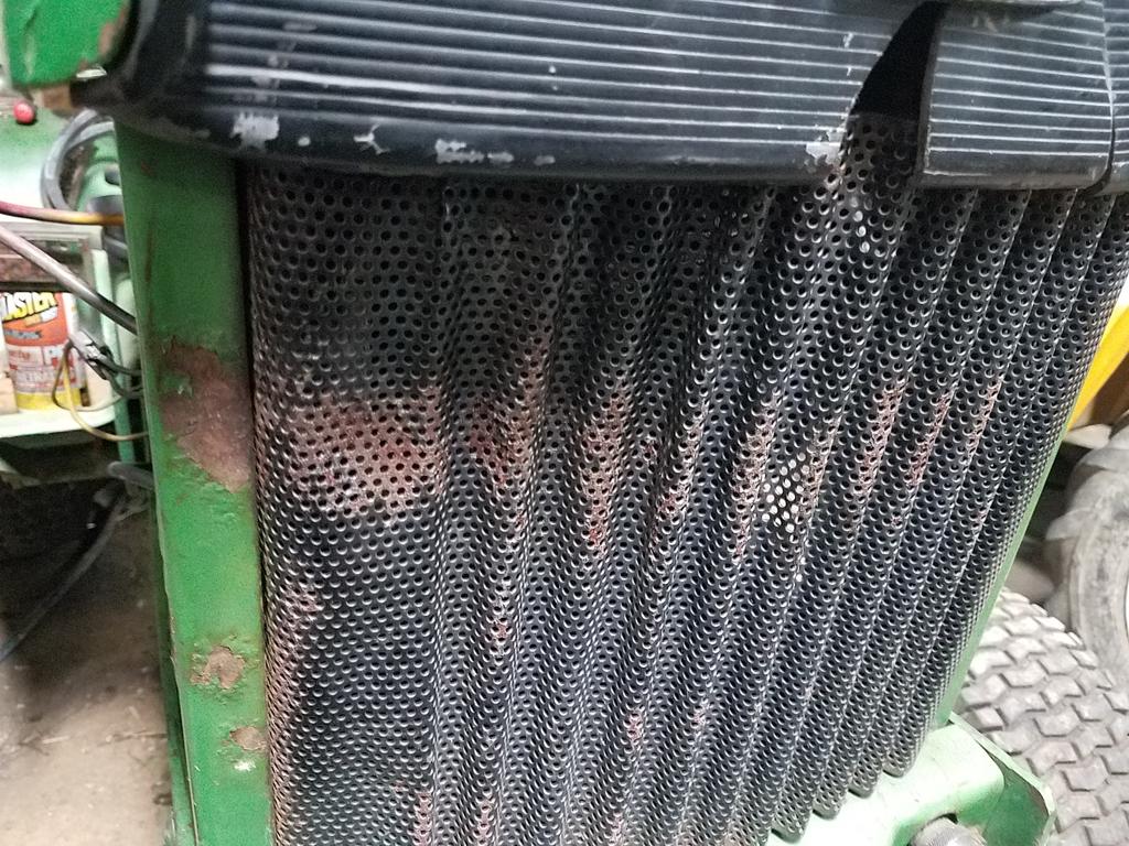

Mudrig150 385 #29 Posted October 11, 2019 Got my grille, and got it in. Larry is looking nice. Guess I'm only adding 2 pictures instead of all 3 because I can only upload 5.7 MB of pictures. Share this post Link to post Share on other sites
ebinmaine 78,300 #30 Posted October 11, 2019 Nice match on the patina like you said earlier. That was a good addition. You can get rid of the ads and have unlimited photos if you become a supporter. Always a great idea as that's what keeps this website running. 1 Share this post Link to post Share on other sites
Mudrig150 385 #31 Posted October 11, 2019 13 minutes ago, ebinmaine said: Nice match on the patina like you said earlier. That was a good addition. Even the rust line across the hood support lines up. 1 Share this post Link to post Share on other sites

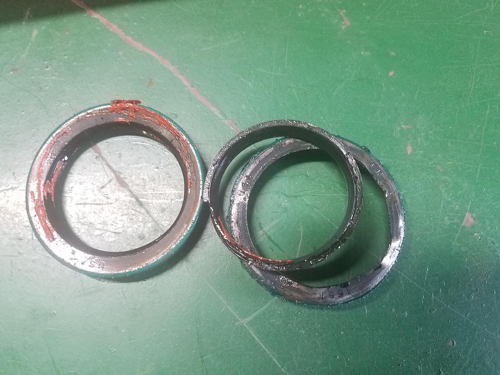

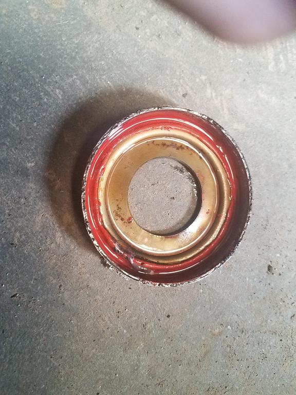

Mudrig150 385 #32 Posted October 28, 2019 So excited! Got my axle seal in. Also found out why the brakes on my 210 didn't work, lol. On the left is the old brake disc, right is a new one. Notice something...missing? Pulled the brakes off, and found out that the bolt for the brake adjustment was falling out, which is why my brakes don't work. Checked out patio 140 and the rotor is so worn that, even when the nuts are on the bolt shoulder, the pads don't touch when the brakes are locked. Now I should have turning brakes, but the pedals are locked together. Any tricks for separating them? Surprised when I pulled the axle apart and found there were two seals, previous owner literally just put a second seal in front of the first one when the old one started leaking. Only problem is that they put the the new seal in backward. When it started leaking, they covered literally everything in orange RTV and called it a day. It still leaked, so they just gave up. Also found my keyway has a small chunk out of it from when they tried knocking the key out with a hammer. It's also missing the felt washer on the outside dirt shield. I ATF on the outside and rubber part of the seal, put it in rubber side in, and lightly tapped it in. Did I do it right? So excited, Larry, who's been sitting for over 2 decades is finally going to run, just need to drill out the screws in the brand new Carter 26 carb I have, and get it on the K241! Share this post Link to post Share on other sites

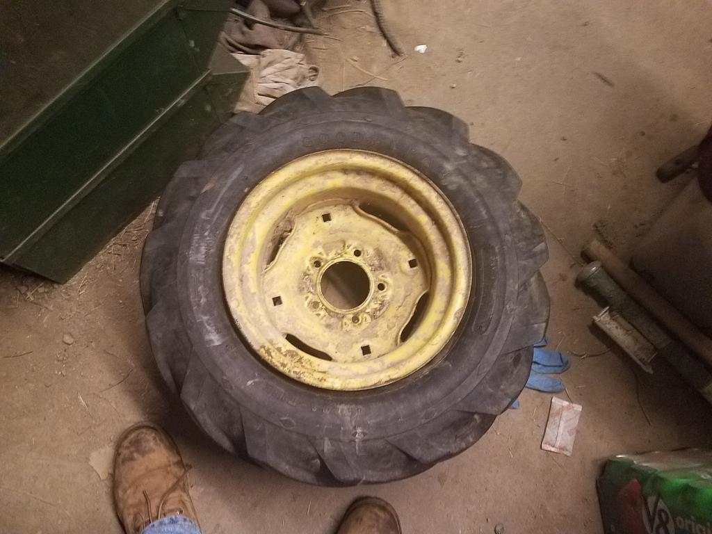

Mudrig150 385 #34 Posted November 6, 2019 After getting my carb done I decided to mount my ag tire on the rim. Went through the trouble of marking the rim, fighting it on with its stiff bead, and even got the tire machine stuck on the bead of the tire, then found out there was a staple in the bag that the tube came in, which punctured a hole in it. Had to pull the tube BACK out so my pap can patch it. Thanks UPS for ruining a brand new tube before it even left the box... Share this post Link to post Share on other sites

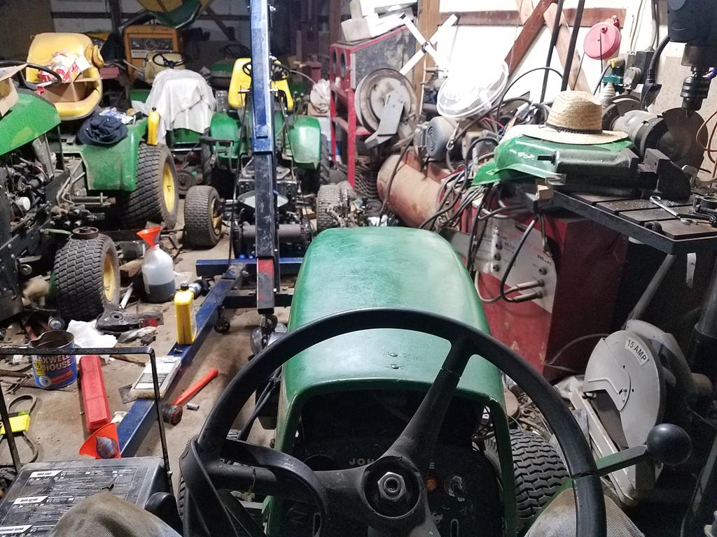

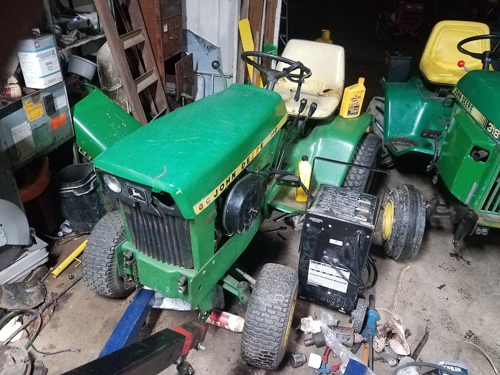

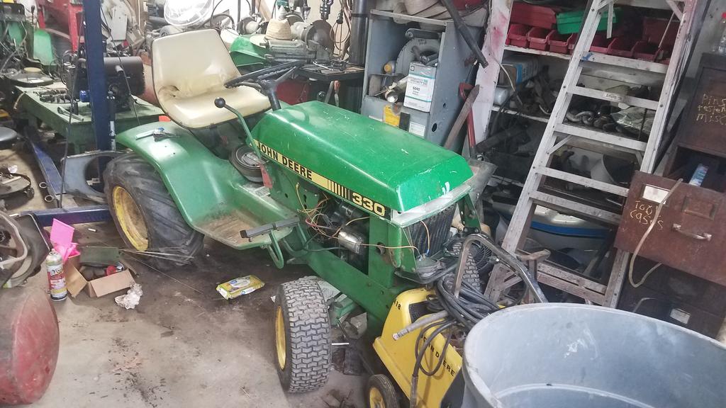

Mudrig150 385 #36 Posted November 8, 2019 Larry is ready. Engine bolted in, muffler pipe cut and muffler on, air cleaner on, electrical reworked, cables hooked up, oil and ATF in, and driveshaft bolted up. Also hooked up my headlight (yes, headlight, as in one) Now to pull the battery tray and fix the loose steering box and throw my ag tire together and put the set on before I run him. 1 Share this post Link to post Share on other sites

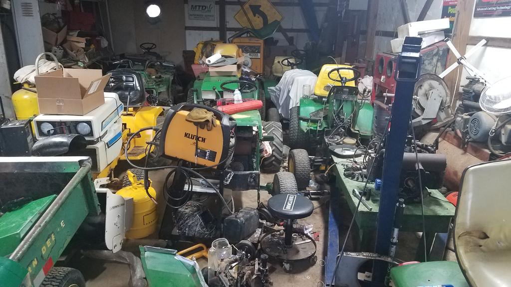

Mudrig150 385 #38 Posted November 21, 2019 This makes me feel... VERY uncomfortable. Also, our shed is a wreck. He still have to get the 455 out to replace the power steering lines. Share this post Link to post Share on other sites
