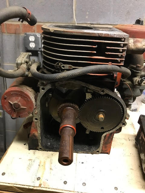

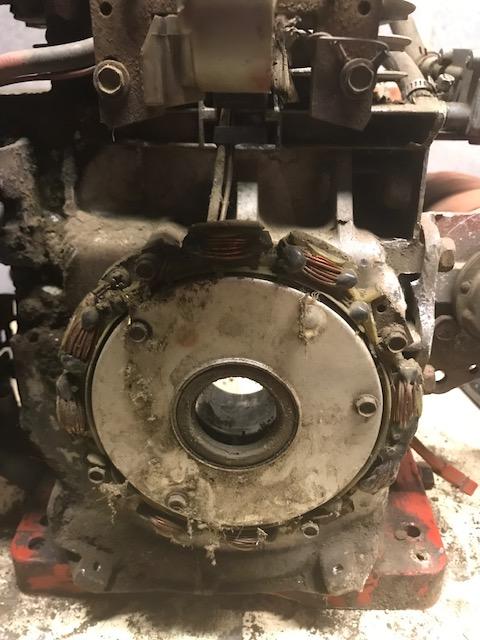

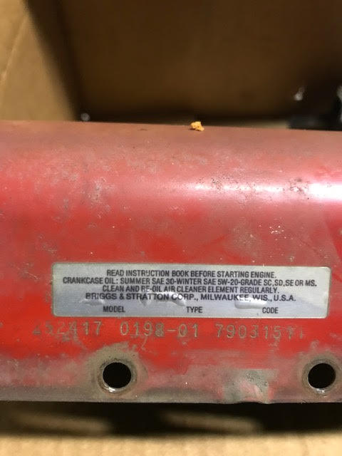

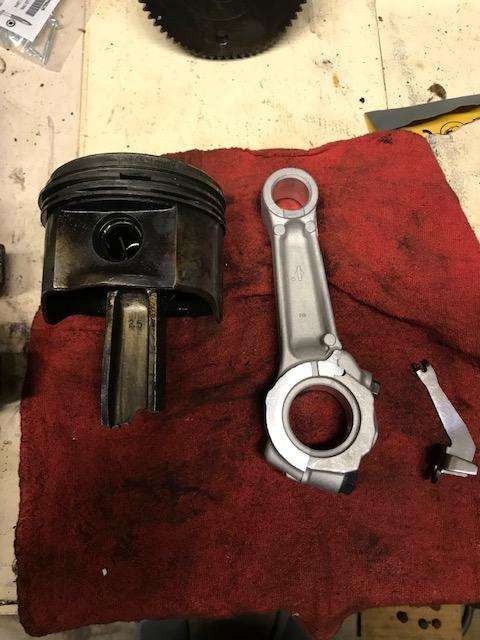

Cecil Davis 14 #1 Posted May 17, 2019 New to the forum. Helping my Dad fix his engine on a C-111 He can't mess with them anymore, but he is a great adviser. Attached some pictures. Working on the engine first, broken piston connecting rod. Would be grateful for sites to buy rebuild kits or parts. 4 2 Share this post Link to post Share on other sites

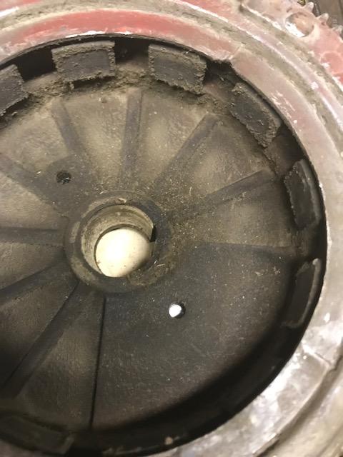

Cecil Davis 14 #11 Posted June 6, 2019 This flywheel did not come off easily. But now it is off! There is considerable aluminum buildup on the journal where the old connecting rod seized. I have seen muriatic acid used to remove the aluminum. A couple of questions, what is the clearance on the connecting arm when I reattach it, and what is the torque on the connecting rod bolts? Share this post Link to post Share on other sites
953 nut 63,974 #12 Posted June 6, 2019 This service manual should give you the information you need. You are correct about Muriatic Acid removing aluminum. When you install the flywheel do not use any oil or other lubrication, it is supposed to be difficult to remove. 2 Share this post Link to post Share on other sites

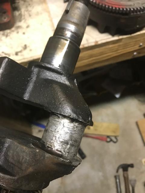

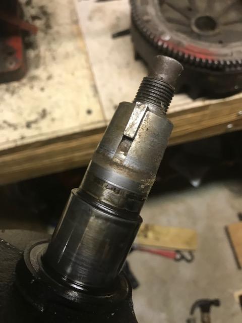

Cecil Davis 14 #14 Posted June 7, 2019 A look at the journal after cleaning with Muriatic Acid (nasty stuff) and the broken connecting rod and the replacement. The journal is fairly smooth after the acid, but not perfect. Will that be a problem? Share this post Link to post Share on other sites
ebinmaine 77,079 #15 Posted June 7, 2019 That should be turned to get it smooth, if possible. Or replace the crank. That would likely eat another bearing. 1 1 1 Share this post Link to post Share on other sites
Pullstart 68,776 #16 Posted June 7, 2019 Yeah, you shouldn’t be able to journal with a fingernail. That looks like much more clean up work is needed. Our local NAPA hub has a machine shop. Possibly you could search around for one that could turn the crank for you, your dad’s tractor will thank you Also, if I haven’t said so already! 1 Share this post Link to post Share on other sites
Cecil Davis 14 #17 Posted June 8, 2019 Thank you, I will get the journal cleaned up and machined if necessary. I appreciate the input. If I get it machined will change the connecting arm that I would use? Also, am I using this forum correctly by adding to this topic, or should I start new topics with each question? Share this post Link to post Share on other sites
ebinmaine 77,079 #18 Posted June 8, 2019 2 hours ago, Cecil Davis said: Thank you, I will get the journal cleaned up and machined if necessary. I appreciate the input. If I get it machined will change the connecting arm that I would use? Also, am I using this forum correctly by adding to this topic, or should I start new topics with each question? Your best bet on the machining question is to bring it to the machine shop that you would use and let them answer it for you. I don't know enough about small engines to tell you for sure but in the larger ones, sometimes you would change to a different size bearing. It's also possible there is enough damage on that to warrant just getting another part. Any decent small engine machine shop will have the knowledge and the tools necessary to help you make that decision. As to the topic question, you're doing fine. You could start a new topic with a group of questions about say, an engine, in the engine section. Obviously that would carry over with other parts to other sections. It does help sort out the threads for searching and for future users. 1 Share this post Link to post Share on other sites

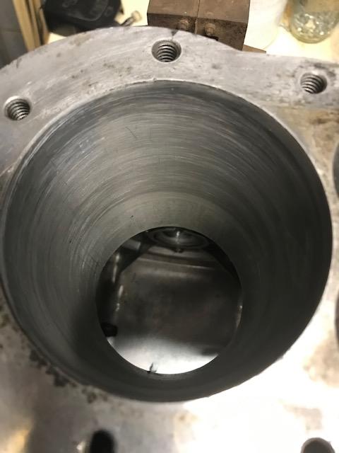

Cecil Davis 14 #19 Posted June 8, 2019 Thanks! I honed the cylinder today and their is a small ridge at the top that I have to figure out what to do with also. 1 Share this post Link to post Share on other sites
ebinmaine 77,079 #20 Posted June 8, 2019 1 hour ago, Cecil Davis said: ... ridge at the top that I have to figure out what to do with also. I would do the same with that as with the crank and rod. Bring it to the machine shop and have them inspect and measure with the appropriate tools. The cylinder bore will need to be measured in multiple places to determine the amount of wear and also out of round. 1 1 Share this post Link to post Share on other sites

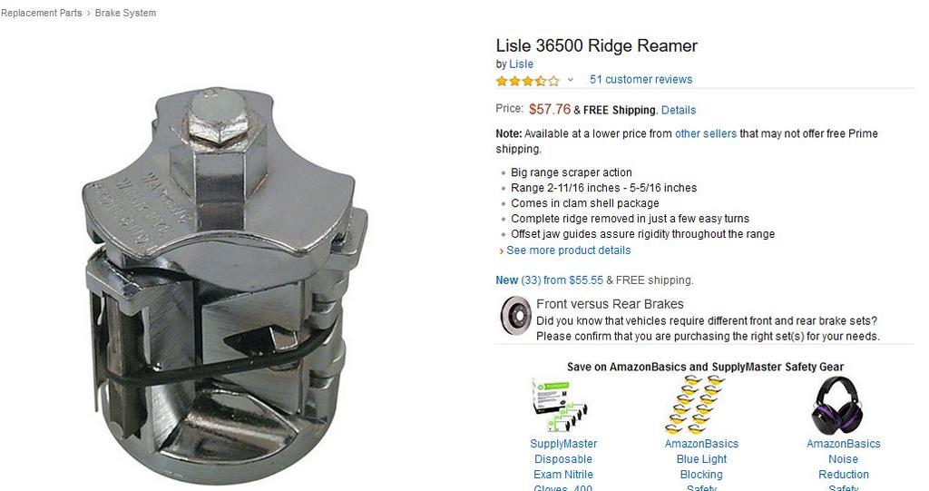

pfrederi 19,794 #21 Posted June 8, 2019 There is a tool for it, a ridge reamer or you can use a razor blade 2 1 Share this post Link to post Share on other sites
Cecil Davis 14 #22 Posted June 8, 2019 Thanks, I talked with a machine shop guy today. The ridge is slight and does not go around the whole cylinder. Share this post Link to post Share on other sites

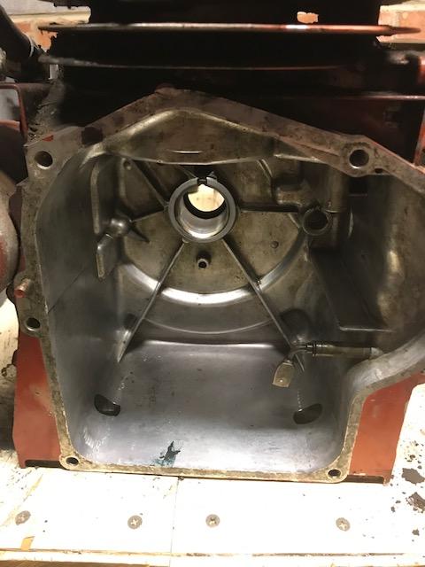

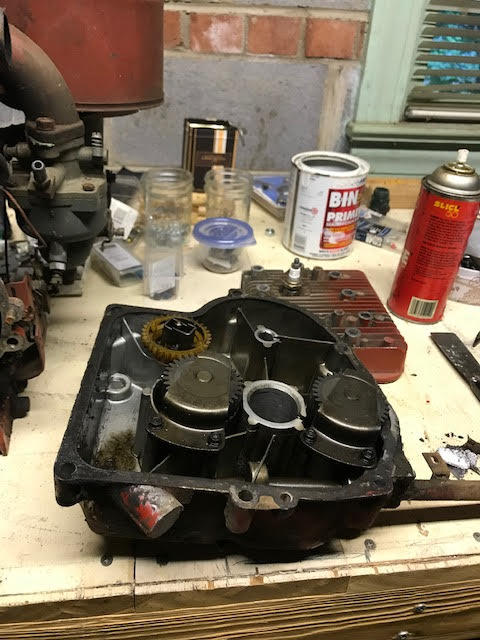

Cecil Davis 14 #23 Posted June 19, 2019 A few new pictures, the cylinder after honing, I have also reamed out the ridge using the technique that was posted on this thread. I took the crankshaft to my Dad (a machinist) and he signed off on the clean up job on the journal after making a few recommendations. There is a picture of the cleaned crankcase. Also, everyone has told me not to reuse the clips on the piston, so the new ones came in today. 3 Share this post Link to post Share on other sites
