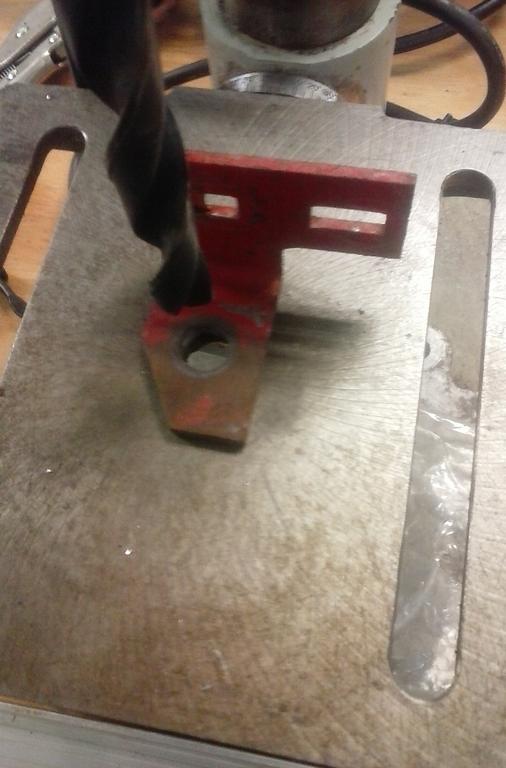

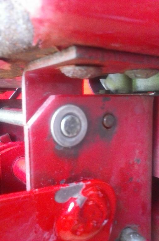

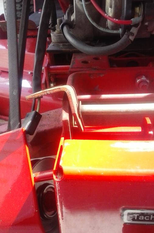

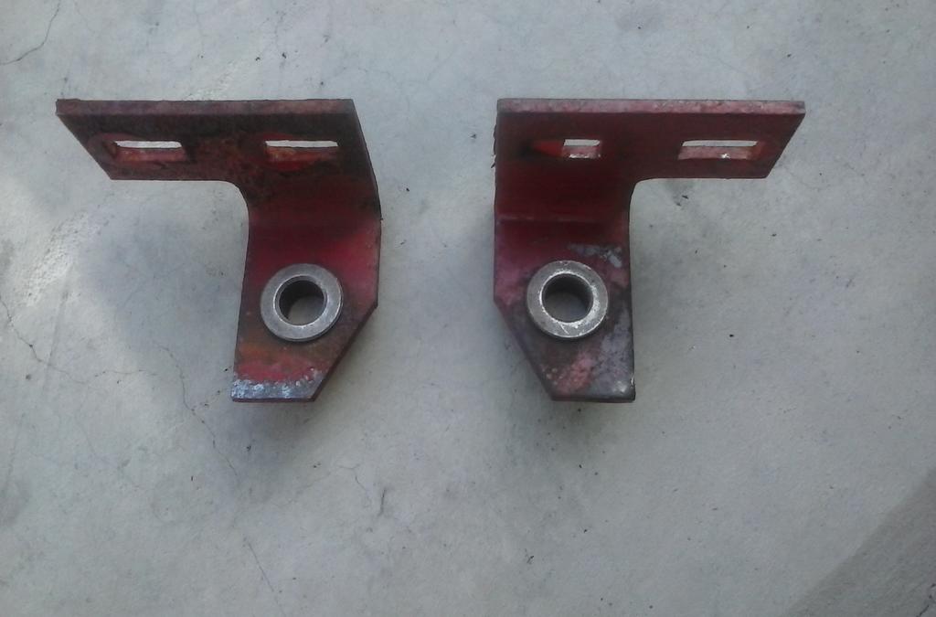

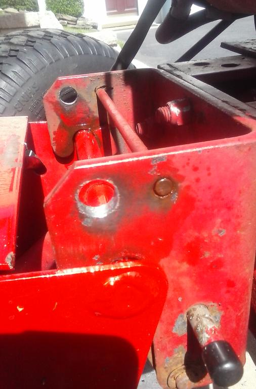

Bigtrx34 321 #51 Posted December 15, 2019 On 6/10/2019 at 9:40 PM, 76c12091520h said: Since I'm using/debugging this beast prior to the major teardown, I decided to fix the squeaking hood that's been driving me nuts. Removed the hood, threw away what was left of the shredded nylon hood hinge bushings, drilled out the worn hood hinges and the mount plate on the frame and installed bronze 70's-80's GM door hinge bushings. If they can hold a 100lb GM door a 5lb hood won't ever wear them out. Squeak is gone and works nicer than new without any wobble (they'll be made pretty later) Will be stealing this modification for use down the road. Good thinking looks clean! 1 1 Share this post Link to post Share on other sites

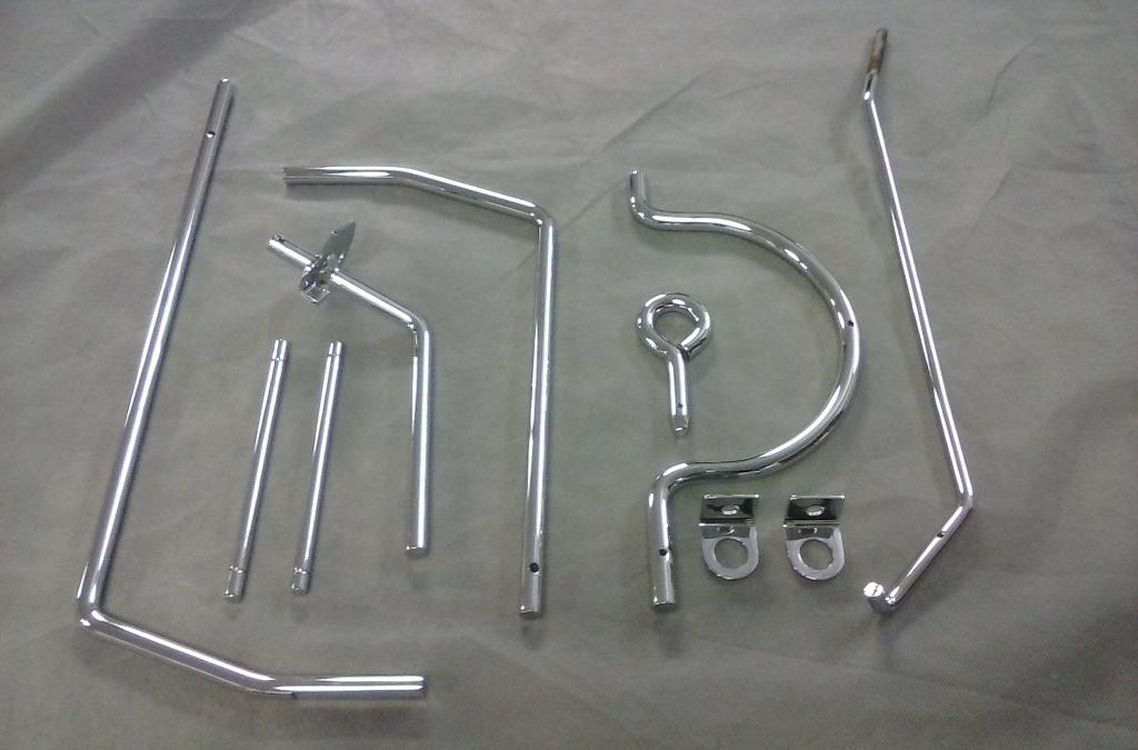

76c12091520h 4,290 #52 Posted December 31, 2019 Santa came a little late, but at least he brought me something nice 4 2 Share this post Link to post Share on other sites
Pullstart 71,296 #53 Posted January 1, 2020 Oooooooooohhhh so shiney! 1 Share this post Link to post Share on other sites
Greentored 3,221 #54 Posted January 2, 2020 Man, you are going ALL the way with this thing! Looks killer!! I’m doing a mild chassis up resto on my 520 right now, nothing close to your caliber. I did steal your hood hinge idea haha and it worked perfect👍 1 Share this post Link to post Share on other sites

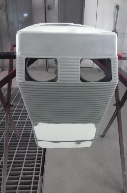

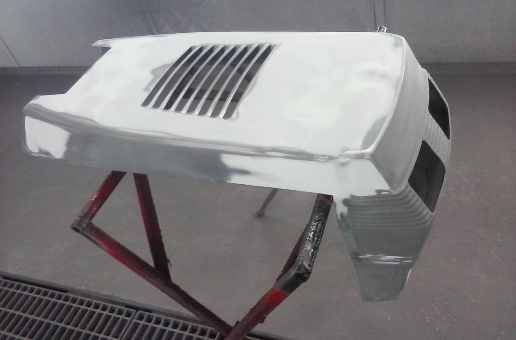

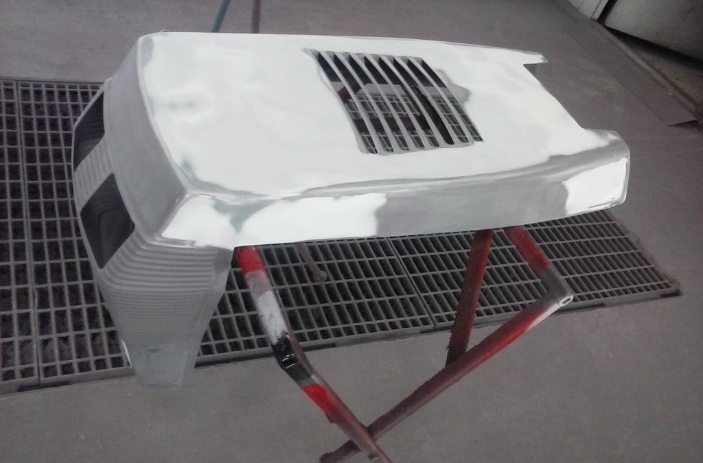

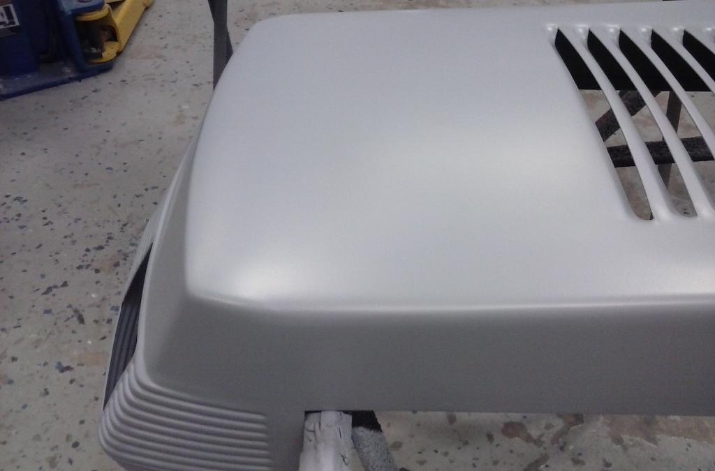

76c12091520h 4,290 #55 Posted January 19, 2020 Spent a snowy Saturday sucking dust.......filled 10001 rust pits and the spot welds at the back of the hood and finished up all the bodywork on all of the red tins and got everything in high-build primer. Bye-bye hood seam! Next step-sand and paint. 7 Share this post Link to post Share on other sites
Greentored 3,221 #56 Posted January 20, 2020 Dude, what are you doing in my paint booth? Or was I in your paint booth? Looking good! 3 Share this post Link to post Share on other sites

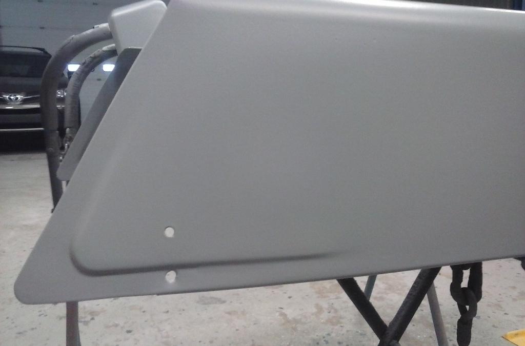

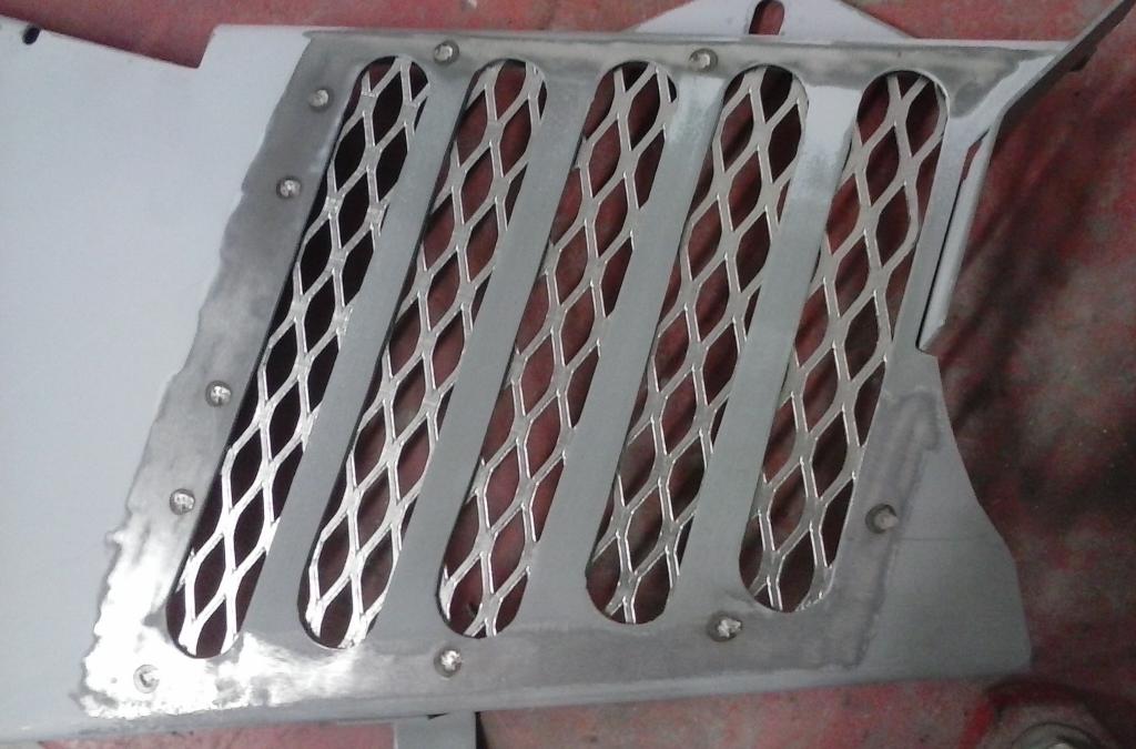

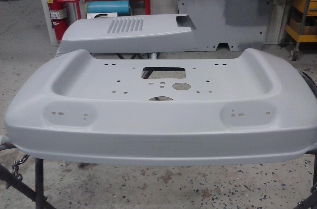

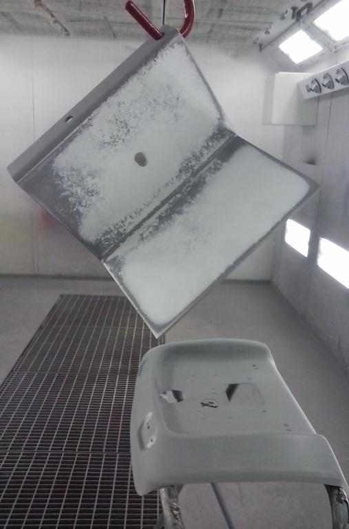

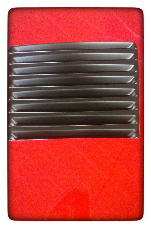

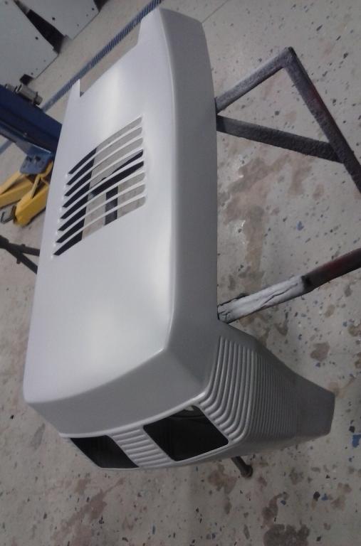

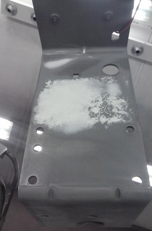

76c12091520h 4,290 #58 Posted February 6, 2020 Added a screen to the openings that I cut into the belt guard; spot welded it in place and finished prepping it for paint. Hopefully Saturday we'll see some red ! 4 2 Share this post Link to post Share on other sites
Pullstart 71,296 #59 Posted February 6, 2020 Are those resistance welded, or just tacked from the back? They look like factory spot welds! Share this post Link to post Share on other sites
76c12091520h 4,290 #60 Posted February 6, 2020 Resistance spot welded; pity some guys in 30-40 yrs when they are trying to decide if this is factory or not! 2 1 1 Share this post Link to post Share on other sites

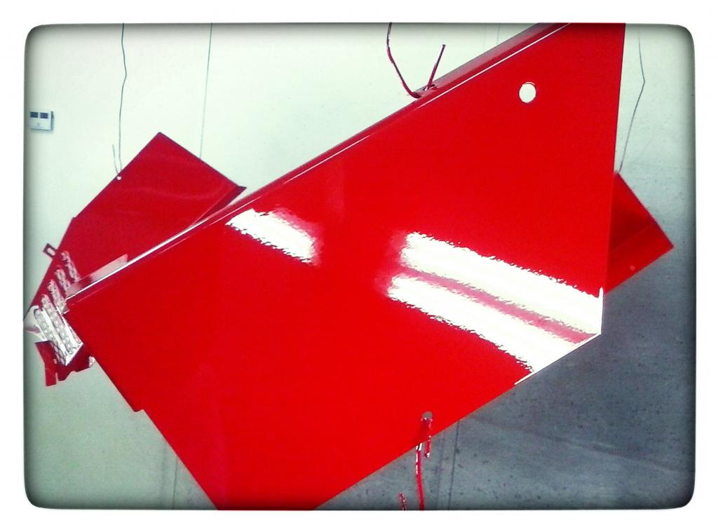

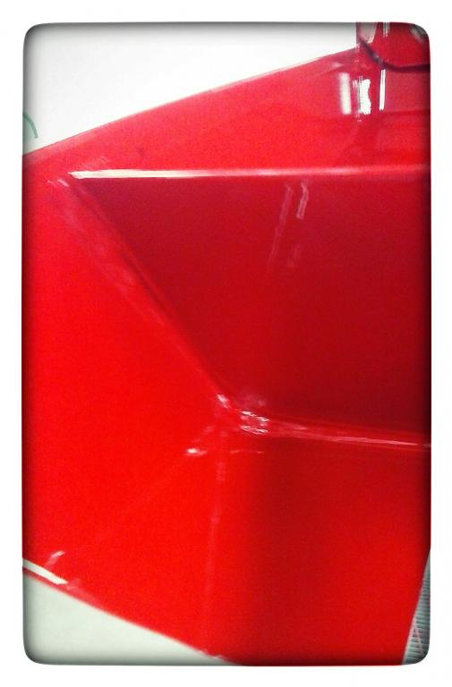

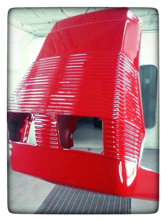

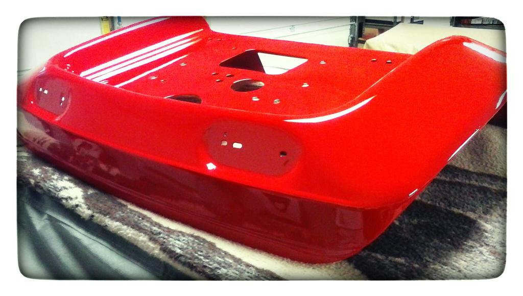

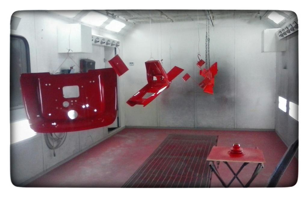

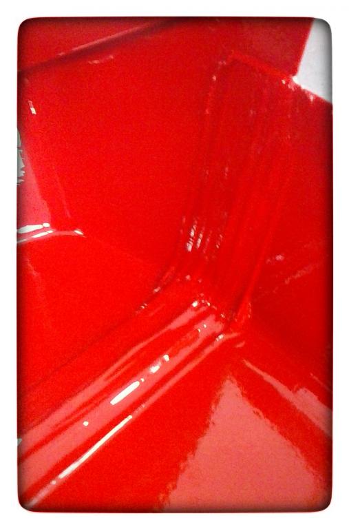

76c12091520h 4,290 #61 Posted February 9, 2020 Got the rest of the sheetmetal painted today. Used PPG single stage concept for the first 2 coats followed by 2 more coats mixed 50 % with clear. Gives it a nice , deep , durable finish. You can also see where I sealed the inside of the hood and used structural adhesive to bond some of the panels on the inside. No more flex or wobble from this hood. Everything has a nice factory looking finish right now. Will be color sanding and buffing after it's reassembled. Black will get painted on the hood in a couple weeks. 1 8 Share this post Link to post Share on other sites
c-series don 12,483 #62 Posted February 9, 2020 Holy cow,wow,damn you do some beautiful work! 2 Share this post Link to post Share on other sites
76c12091520h 4,290 #63 Posted February 10, 2020 Thanks, Don . It's a blessing and a curse. I've made a decent living doing paint and collision work for 30+ yrs, but I can't keep my hands off anything and I can't do anything halfway. 8 months into this redo and it's nowhere near done. After the hood's finished up I can start on the chassis........ 3 1 Share this post Link to post Share on other sites

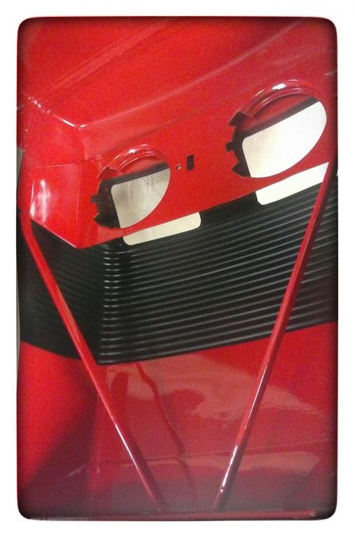

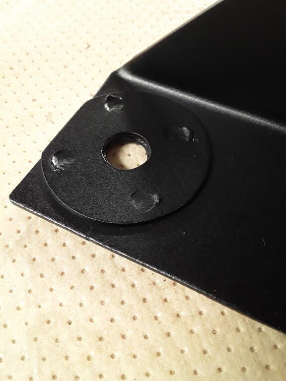

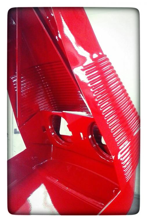

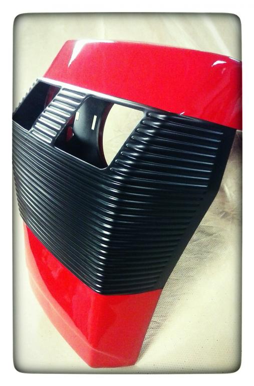

76c12091520h 4,290 #64 Posted February 18, 2020 Did manage to get the blackout on the hood done Saturday; added a few unique touches. Figured if it's black on the outside, it should be black on the inside...... 1 9 Share this post Link to post Share on other sites
Greentored 3,221 #65 Posted February 18, 2020 Cant wait to see this finished project! What are your plans for her? Share this post Link to post Share on other sites
Pullstart 71,296 #66 Posted February 18, 2020 Is that round bar an addition? Seems it would really help to keep that hood from rocking around Share this post Link to post Share on other sites

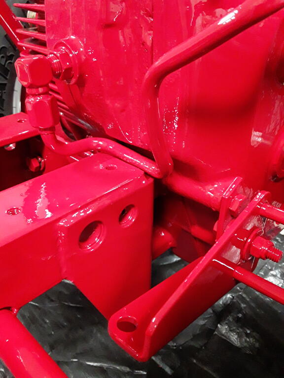

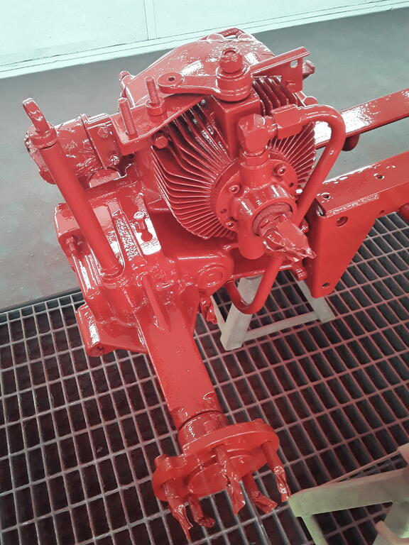

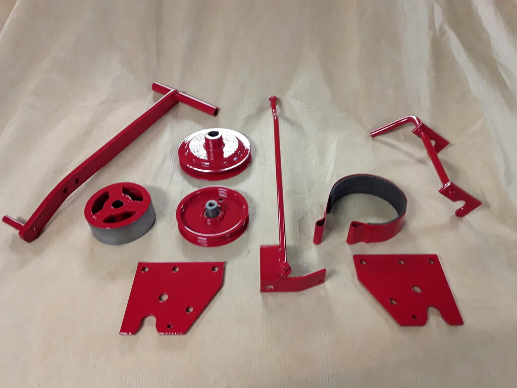

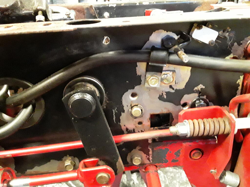

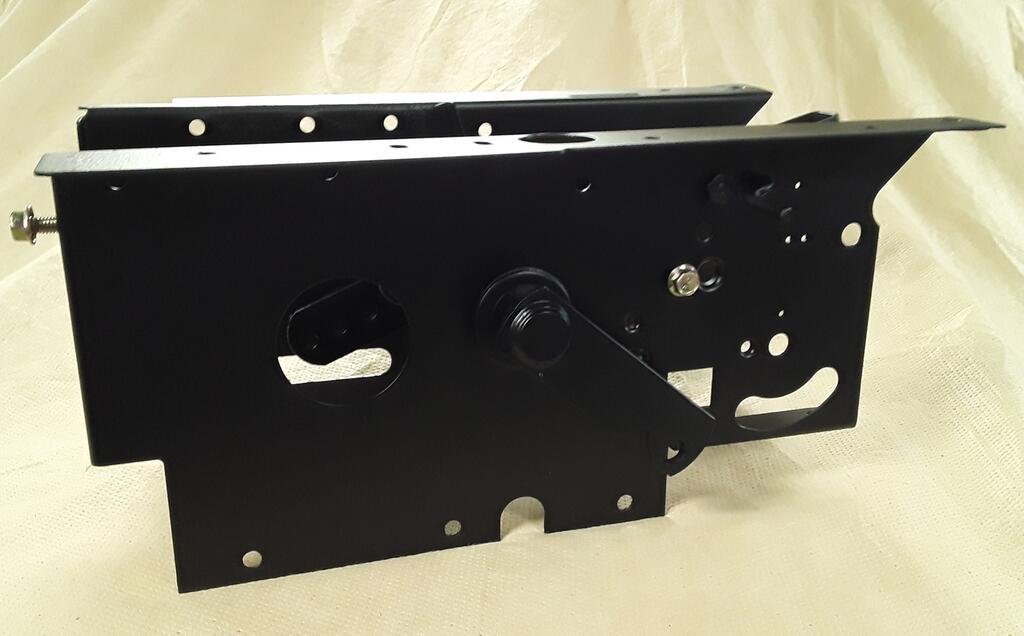

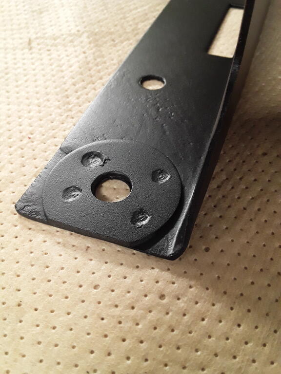

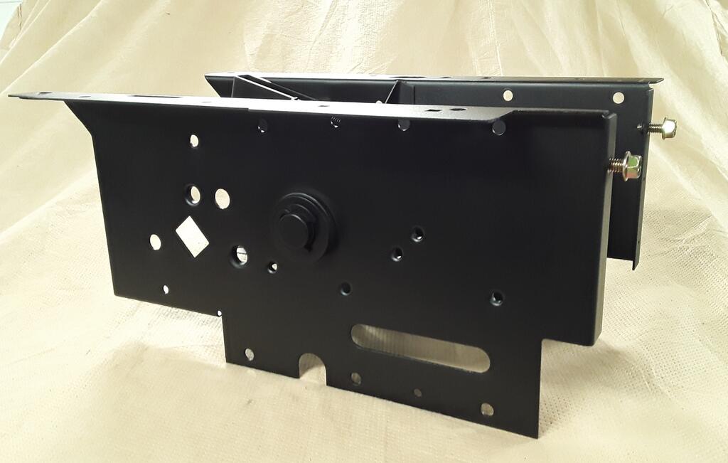

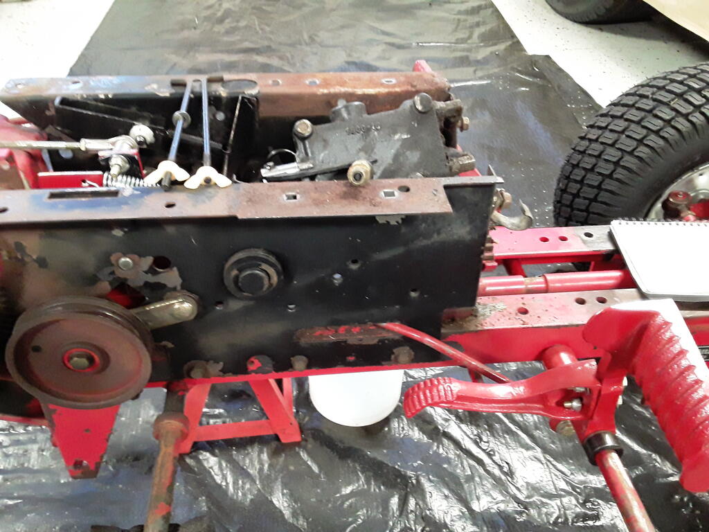

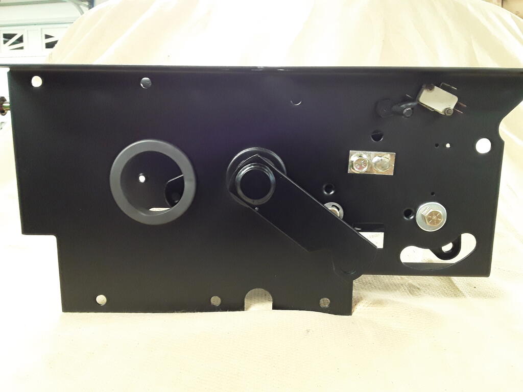

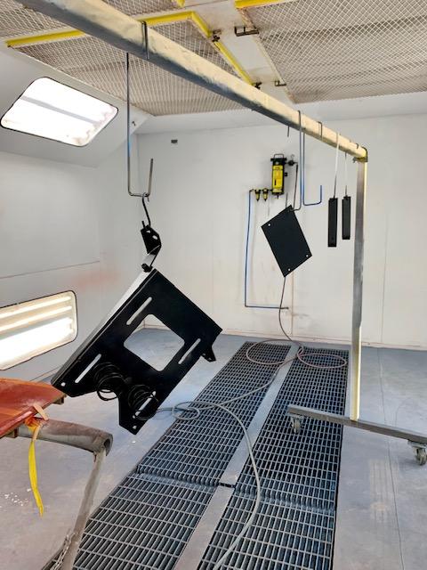

76c12091520h 4,290 #69 Posted July 26, 2020 Finally got some time to do some work on my stuff for a change; finished tearing down the hydraulics and everything attached to the center console area. Stripped it down and repaired and reinforced the rear bolt holes where they always break out, applied the correct satin black and added some fresh hardware. 7 Share this post Link to post Share on other sites

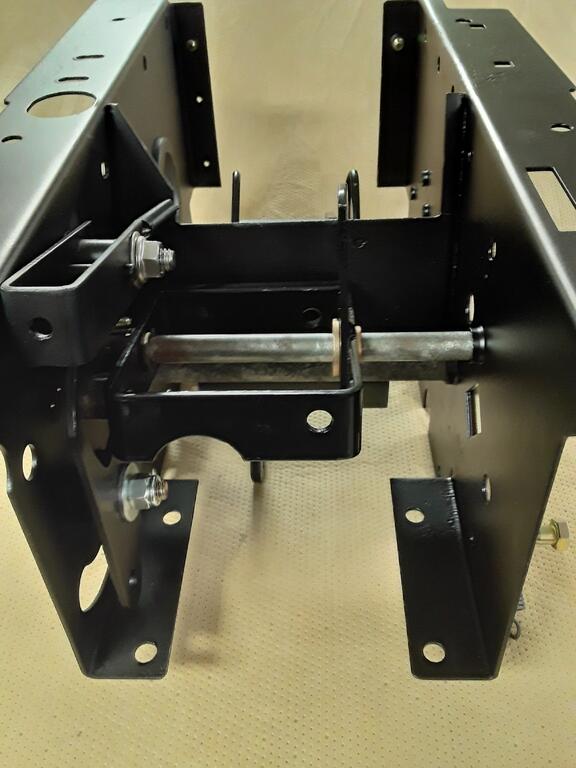

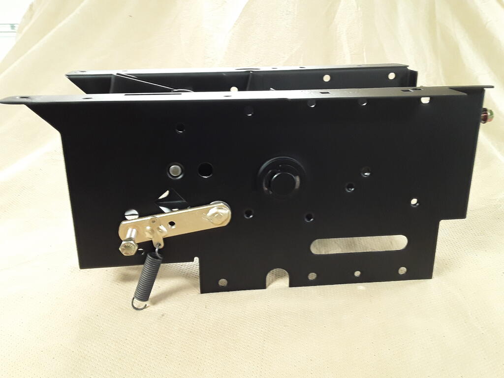

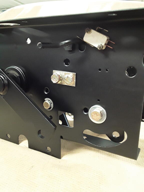

76c12091520h 4,290 #72 Posted July 31, 2020 Got some more of the center console re-assembled. 5 Share this post Link to post Share on other sites

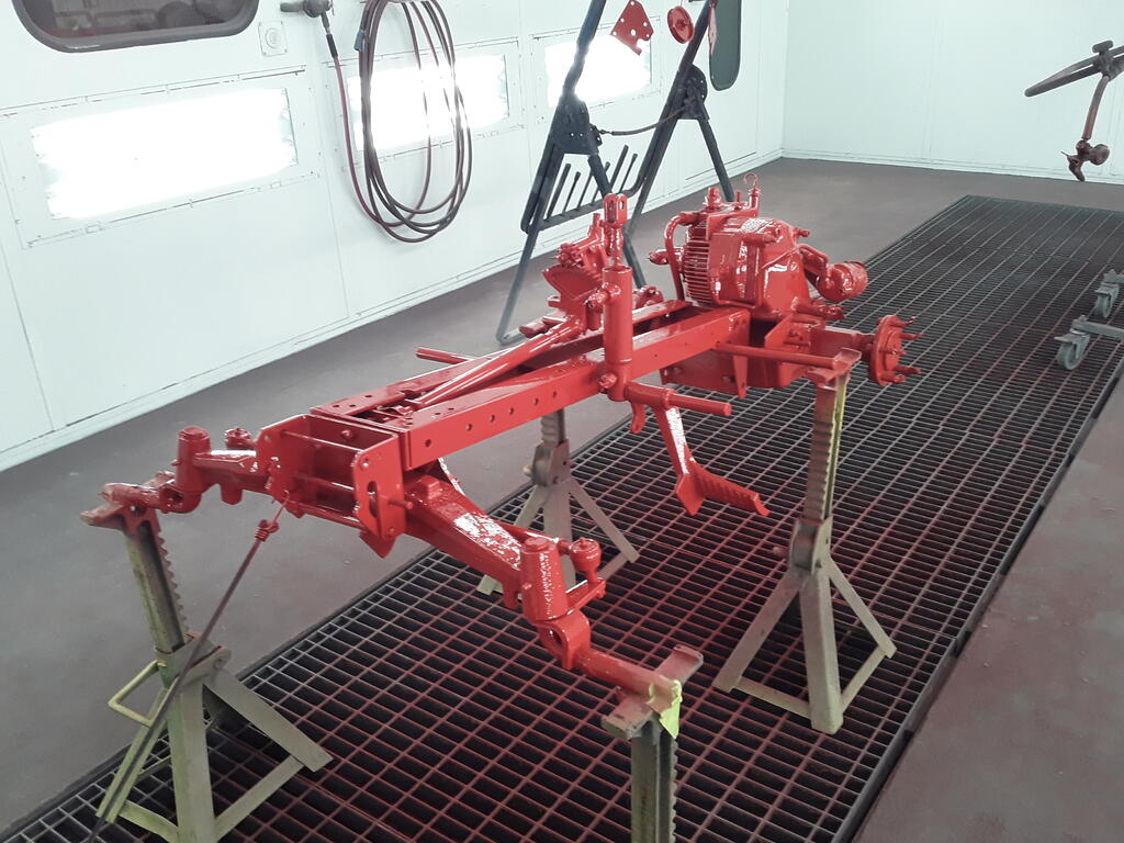

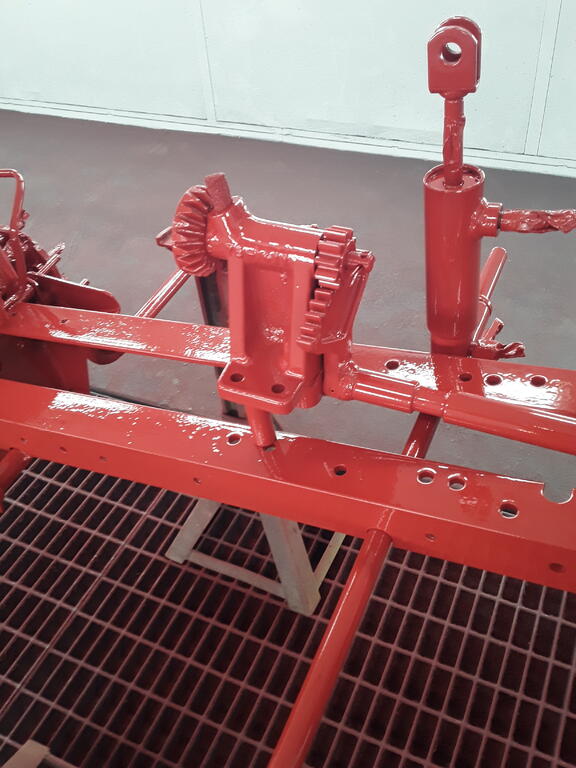

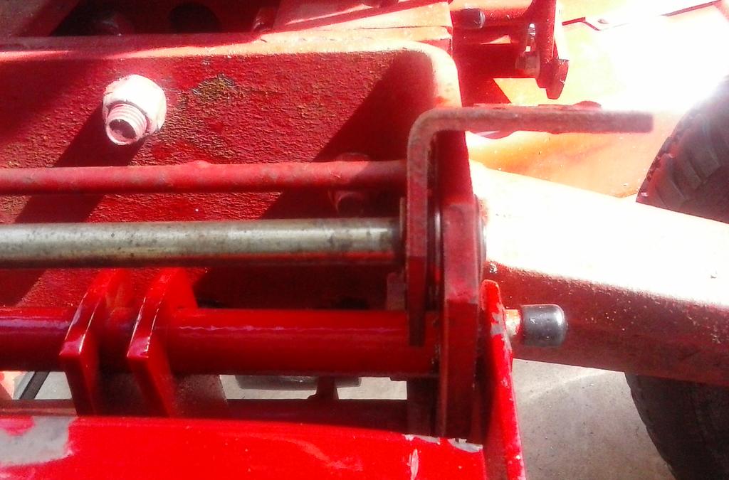

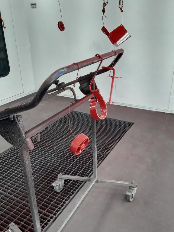

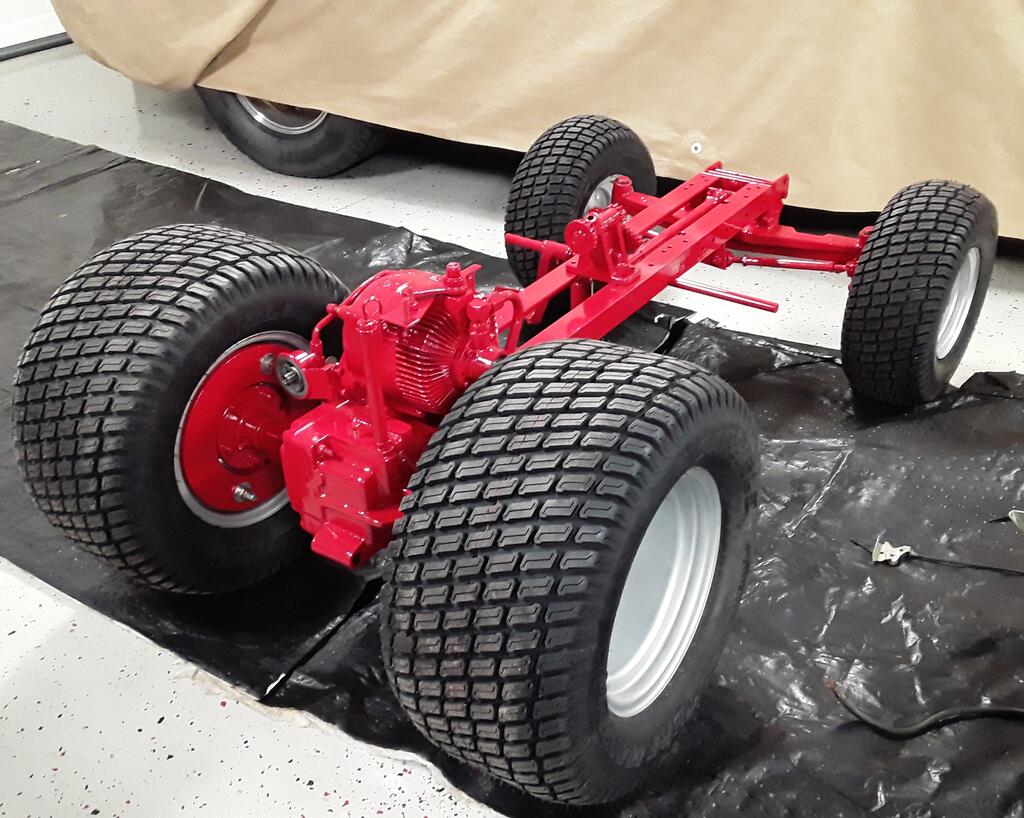

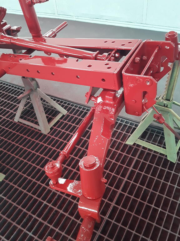

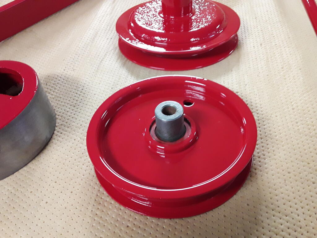

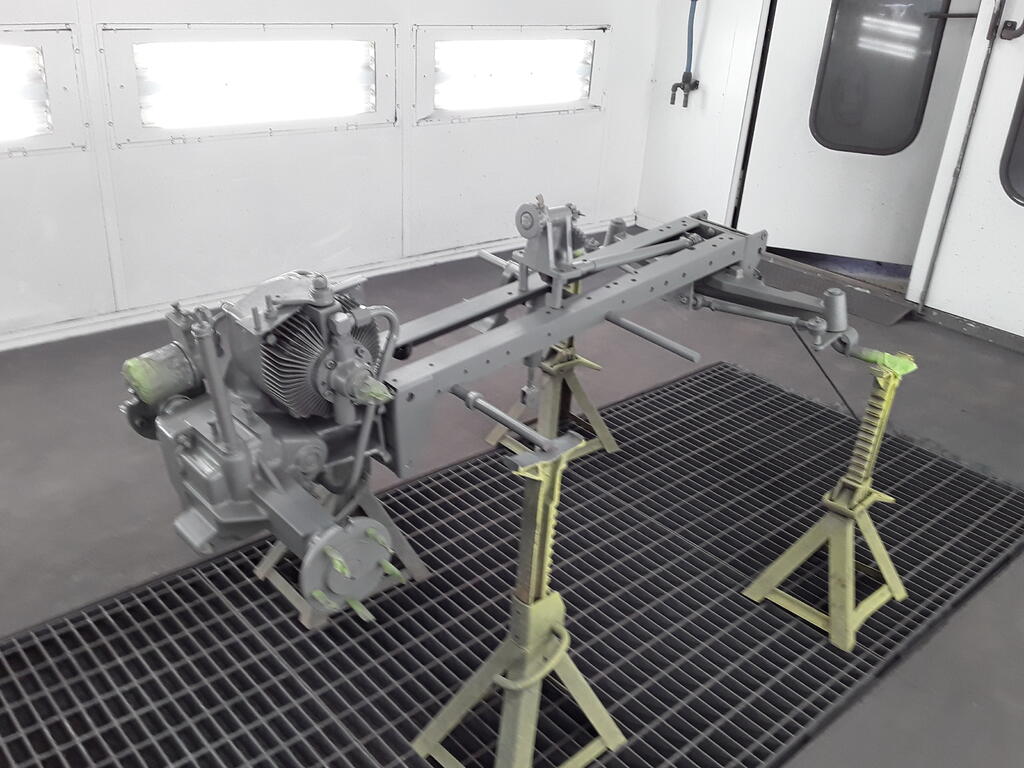

76c12091520h 4,290 #73 Posted August 2, 2020 Got a couple little things done today.........everything on the frame is loose and just hanging there. I just didn't have any need to tear it down any farther. Everything was disassembled , de-greased , serviced as needed, and loosely re-assembled. All the grease fittings and hardware will be replaced as it goes back together. Everything for the tractor itself is painted and ready for re-assembly. 3 5 Share this post Link to post Share on other sites

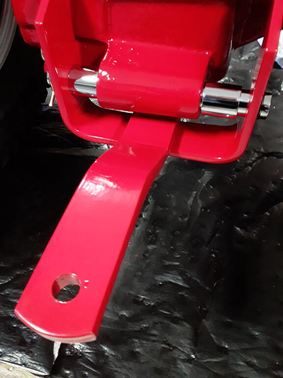

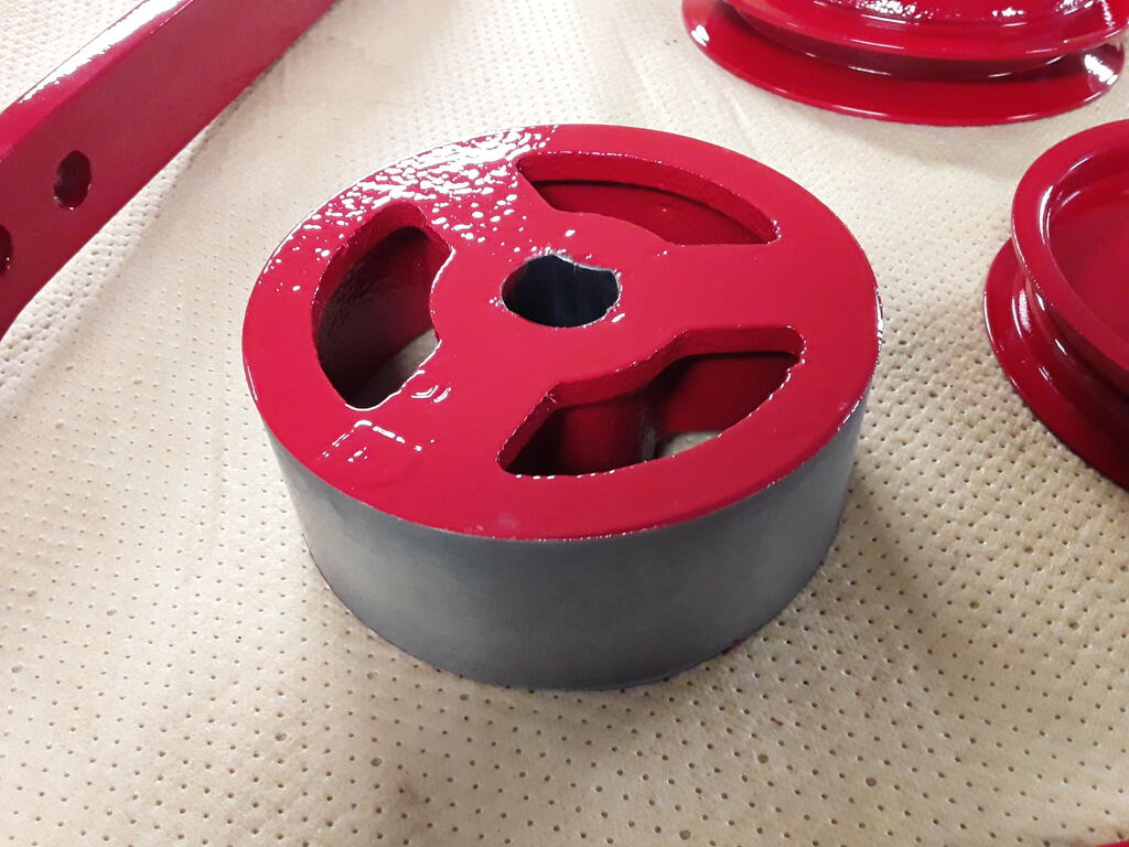

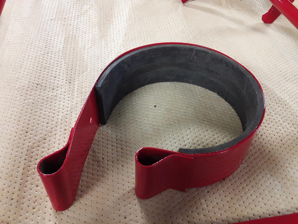

76c12091520h 4,290 #75 Posted August 3, 2020 Not really going to work on this alot for a few days so the paint has time to harden, but figured I could add a little bling ; hitch is powdercoated for durability, pin and spacers are chrome plated. 4 2 1 Share this post Link to post Share on other sites
