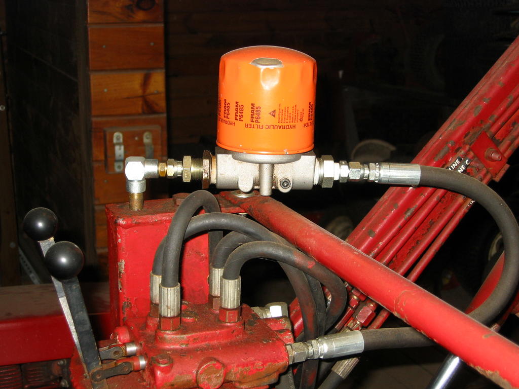

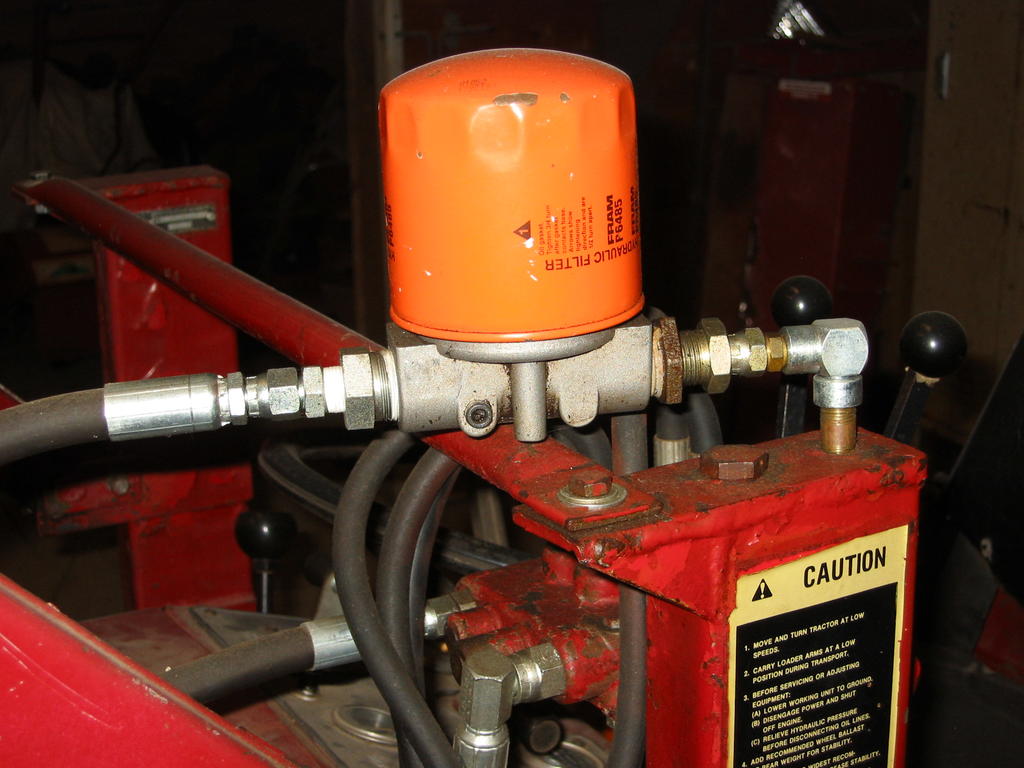

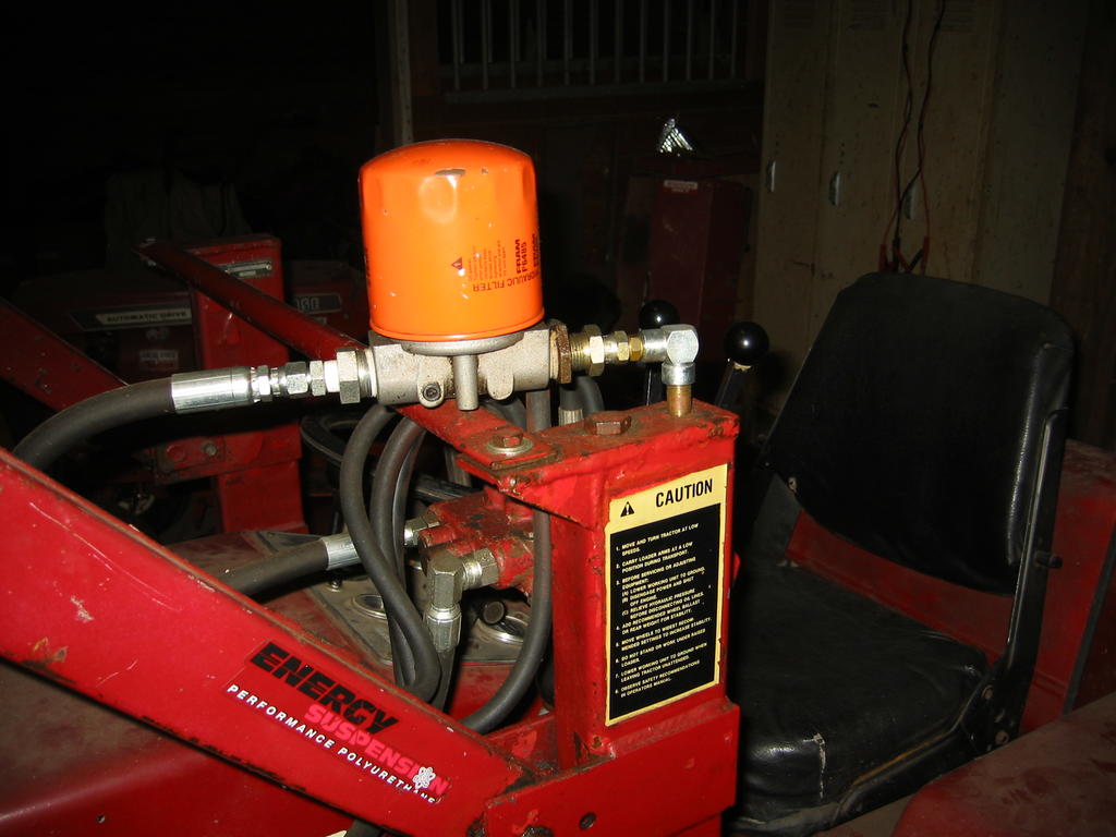

pfrederi 19,954 #10 Posted May 14, 2019 How I put one on my D200. Could have been simpler plumbing but I used what I had lying around. Filter set up came from Northern Tool 3 Share this post Link to post Share on other sites

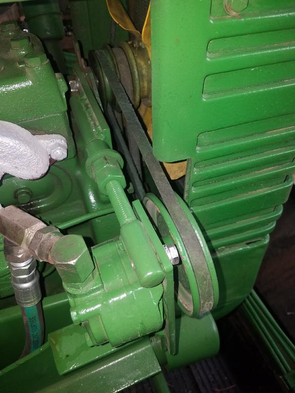

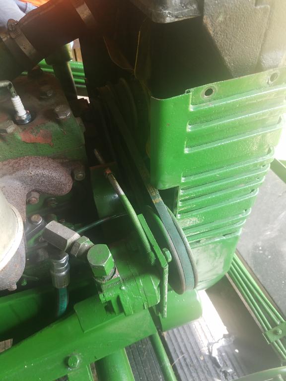

Exlr82fast 8 #21 Posted May 20, 2019 Here's a couple shots of what I did to the pulley. First pic is what it came with. Was a piece of 3/8s all thread going threw a bracket that was welded to the bracket that holds the pump. Under load the whole thing would rock to where it slipped the belt. Second was what I made. I made the assembly so I can take it apart easier and it is attached to the fan pulley bolt. No more slipping that's for sure. Share this post Link to post Share on other sites
Pullstart 68,980 #22 Posted May 22, 2019 On 5/20/2019 at 1:18 PM, Exlr82fast said: Here's a couple shots of what I did to the pulley. First pic is what it came with. Was a piece of 3/8s all thread going threw a bracket that was welded to the bracket that holds the pump. Under load the whole thing would rock to where it slipped the belt. Second was what I made. I made the assembly so I can take it apart easier and it is attached to the fan pulley bolt. No more slipping that's for sure. That looks a little tiny bit more robust! Share this post Link to post Share on other sites
