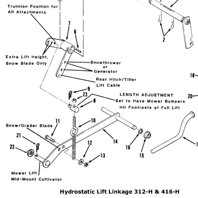

gwest_ca-(File Mod) 11,510 #2 Posted May 13, 2019 Welcome to the forum. Check this illustration against where you have the lift link attached. Top left corner. The closer it is to the shaft the easier it is to lift but won't lift as high. This illustration is from a different model but this part is the same on all long frame tractors which is what the C-101 is. Garry 1 Share this post Link to post Share on other sites

JAinVA 4,638 #4 Posted May 13, 2019 (edited) Provided all linkages are hooked up as per the file mods post you have a number of alternatives.As Eric points out.electric winch,hydraulic conversion or the electric lift actuator made by Wheel Horse.I believe one of our members has an electric lift setup for sale.If that appeals to you post a wanted add in the classified section.I believe we would all like to help you keep the WH and will try to make that happen. Edited May 13, 2019 by JAinVA Share this post Link to post Share on other sites
